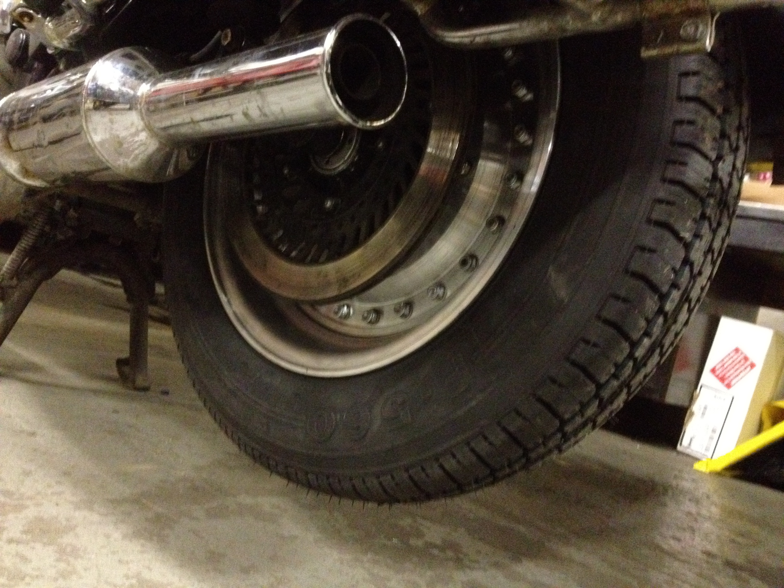

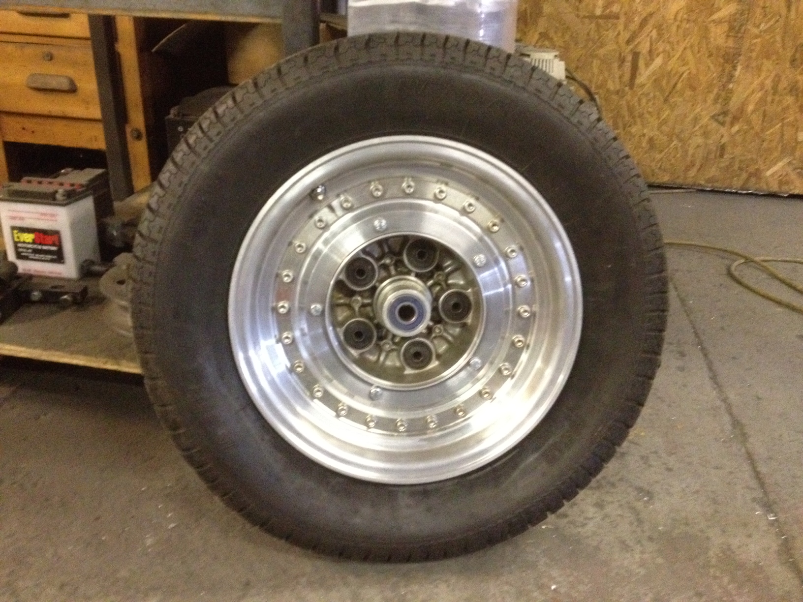

While my GL1100 is at C Stanley Motorsports having a California Sidecar Friendship 1 installed I decided to have Harry make one of his custom wheels for my bike while it was there. He's the only one in the world that makes wheels for early Goldwings, he used the center from a Comstar wheel. Check out the picture, workmanship is awsome.

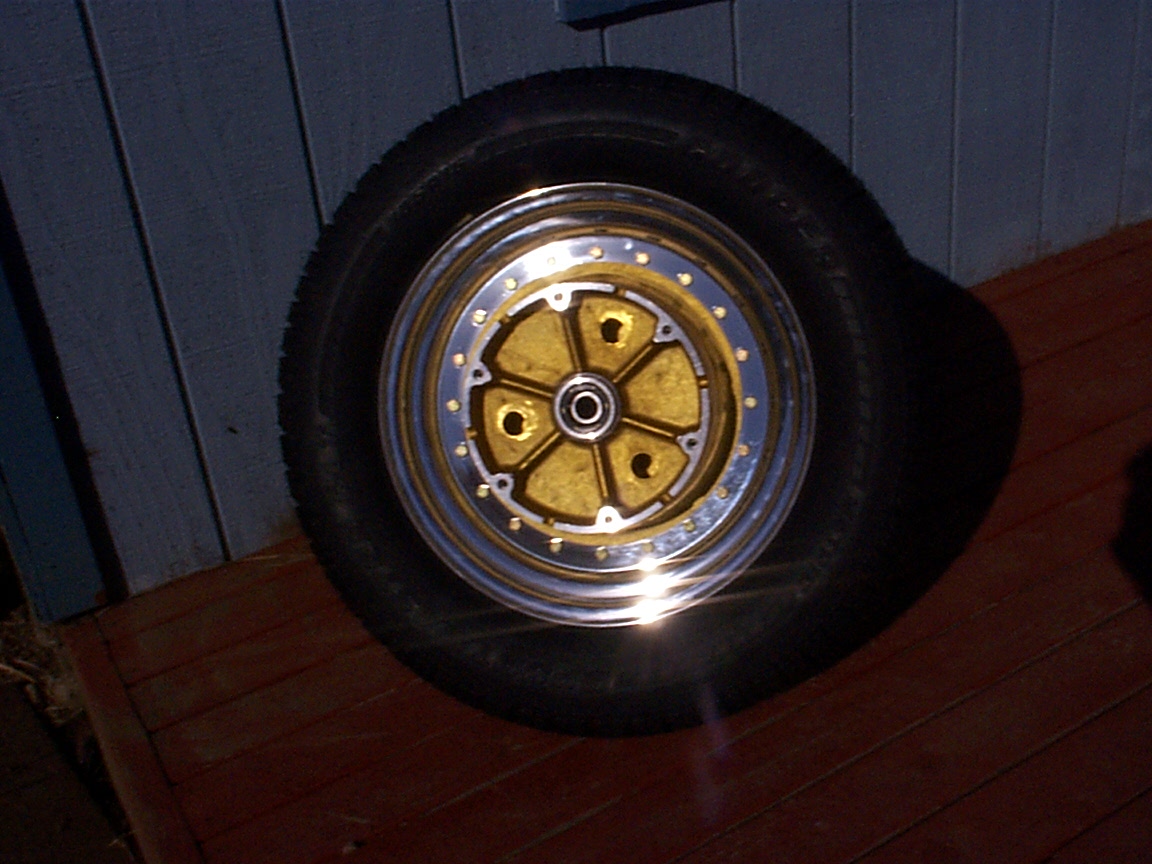

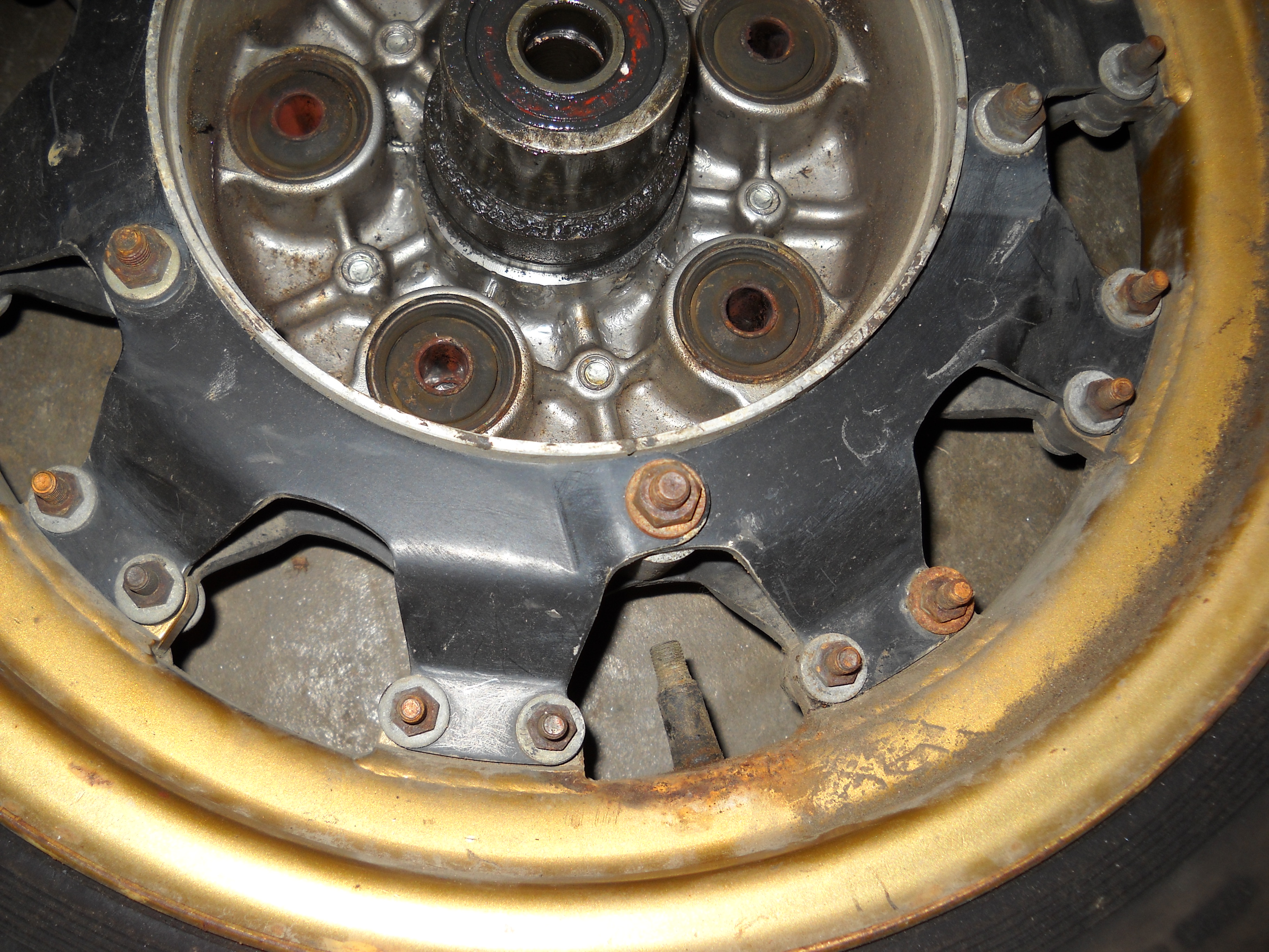

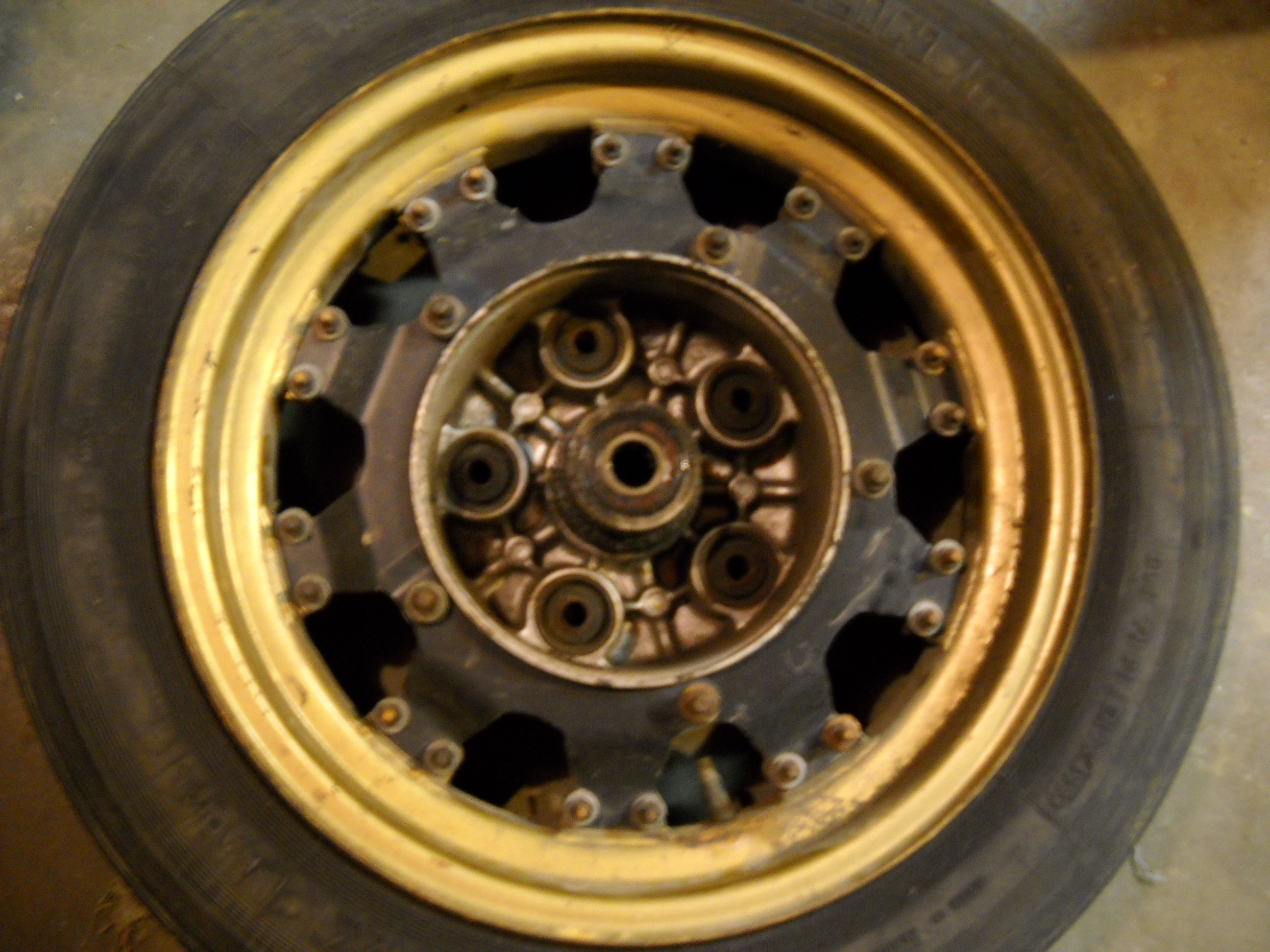

Here is attached a photo of my 15" 1980 goldwing rear wheel. IT says EML stamped on the Rim. It now has a new 135 R 15" firestone tire ($60.00). It lookes squished, almost flat, under the weight of the bike with a Terraplane SC mounted. Perhaps I should have bought the Michlin tire ($170.00).

I hope I am attaching a photo that is...

Hey knockser. EML rim looks interesting. Looks like custom adaptor rings that EML made (or had made for them), as they aren't individual segments as comes on a Comstar wheel. How about a few pics of your rig?

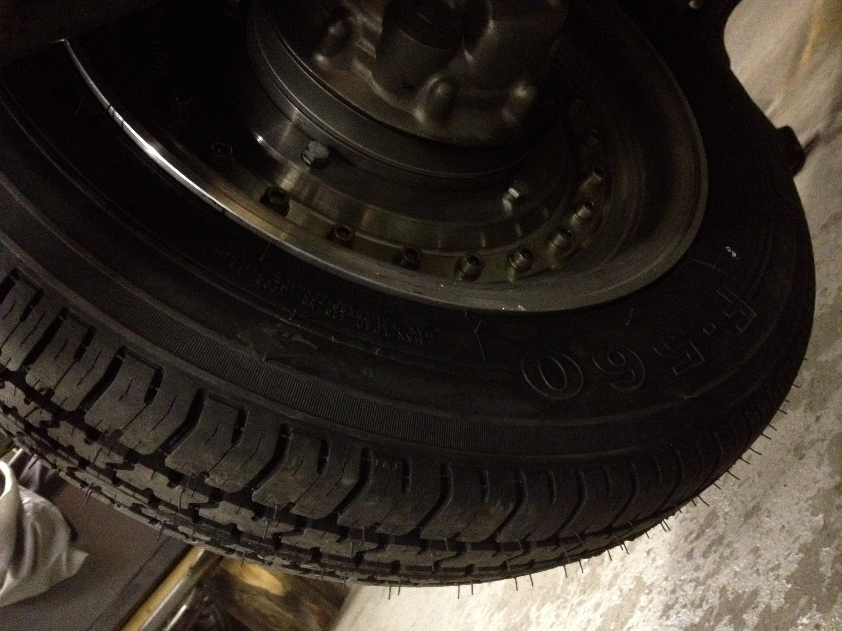

Here are some pictures of the wheel installed. The bike is in the shop at C. Stanley Motorsports

id have used the 145 for sure - its a higher load tire and two inches taller
the 500r16 im running now is so far the best tire ive had on any of my rigs going back to the late 70's

I like that rim GrayBeard! Is it the case that if I have to ask the price that I can't afford it?

I supplied my old wheel for the center section, he did the wheel, new bearings and tire for $1200. DMC charges $1294 for a BMW wheel which is basically a Centerline drilled for the BMW lugs. Also, he's the only one on the planet doing these for GL1100's. I feel like i got a real deal, and it's beautiful.
