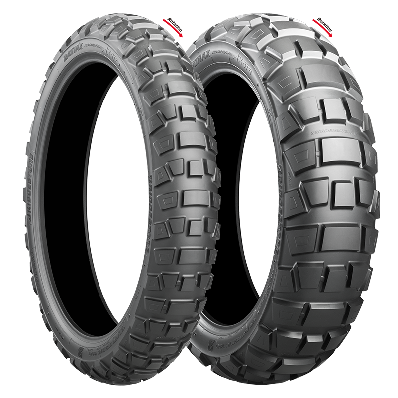

Three tires that would be fun to try on my R1100 GS/Dnepr rig:
Battlax AX41 (on the front only, rear would wear too fast). https://www.bridgestone.com/products/motorcycle_tires/products/detail/pr154   May be a bit mushy with the soft-ish sidewalls for spirited street/hardpacked fire roads.
pr154 detail 01

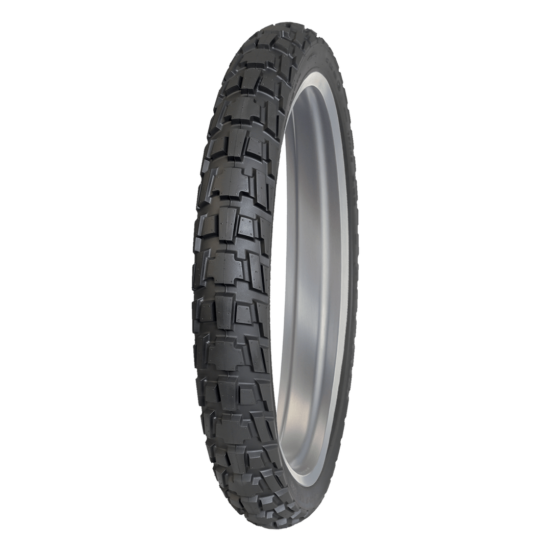

Dunlop Trailmax Raid front & rear (excepting that rear will wear fairly quick). https://www.dunlopmotorcycletires.com/tire-line/trailmax-raid/   A bit stiffer sidewall for hopefully a less mushy feel than the AX41
FRONT TIRE 3 4 RIM TRANSPARENT
REAR TIRE 3 4 WITH RIM TRANSPARENT

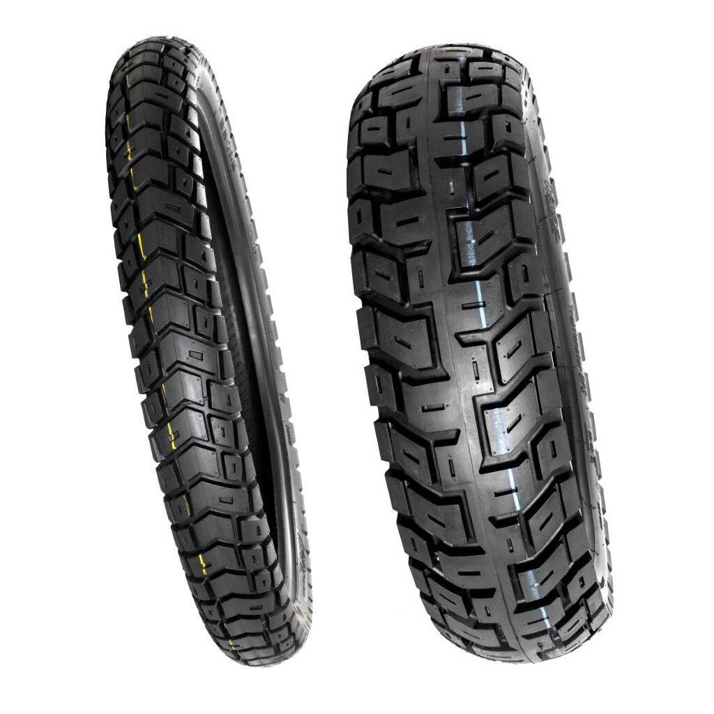

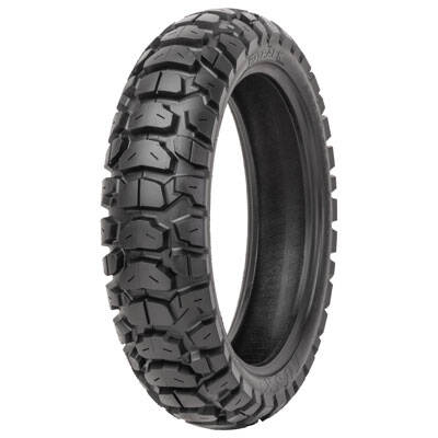

Motoz Tractionator GPS Front and rear (rear may pair up well with the AX41 front tire). https://motoz.com.au/product/tractionator-gps/ Reportedly has a pretty stiff carcass for less mush up front, and better sidewall protection on the rear.
MOTOZ Tractionator GPS

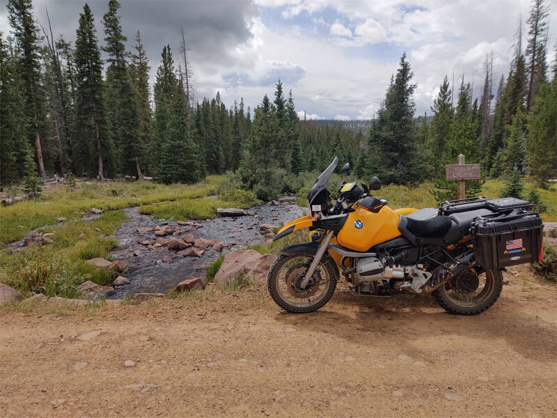

Motoz GPS tires on a BMW R1100 GS with Dnepr sidecar.
Pole Creek
What a difference 10 months makes.  Ended up running the Motoz GPS front and rear, with the Bridgestone AX41 on the sidecar.  Currently the rear has just at 4,000 miles.  Of which only about 400 is dirt road miles with another 100 aggressive riding on Jeep/ATV trails.   Front tire has approximately 4,200 miles (had to recalculate odometer readings to account for approximate 10% error).
My subjective opinion based on a case study of one.  I would buy them again, if I planned on doing a lot of technical, aggressive off road.
     Off road I am pretty impressed.  They were confident on rocky off camber trails.  The rear had great bite, and the front held firm over off camber rutted rocky trails. Threshold braking front and rear was strong and consistent with ABS off.  The front was good but not great in deep gravel/sand.  Overall the rig felt confidence inspiring.  On road, the front tire traction was pretty decent.  Threshold braking during emergency maneuvering with ABS off was communicative and consistent.  In comparison to the Shinko E705, the Motoz performed better all around by a substantial margin (subjectively 30% better).  On road the rear felt just adequate. Except during a very heavy downpour, where the rear tire did an amazing job of maintaining traction.  In concert with the Bridgestone AX41 mounted on the sidecar, it was very easy to push the rear around.  Powerslides to both sides were almost as easy on the street as in the dirt.   Overall, on a rig that sees a majority of off road work, it would be a fine choice.  On road, there were times at threshold braking with ABS on that the rear was a bit sketchy during emergency maneuvering.  Part of that is also due to the AX41 sidecar tire.  A more "street oriented" choice of sidecar tire would help with overall rear stability.

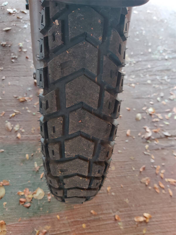

Motoz GPS Front Cons:
  • Just adequate traction in deep gravel
  • Very sensitive to tire pressure when it comes to steering wobble at low speeds

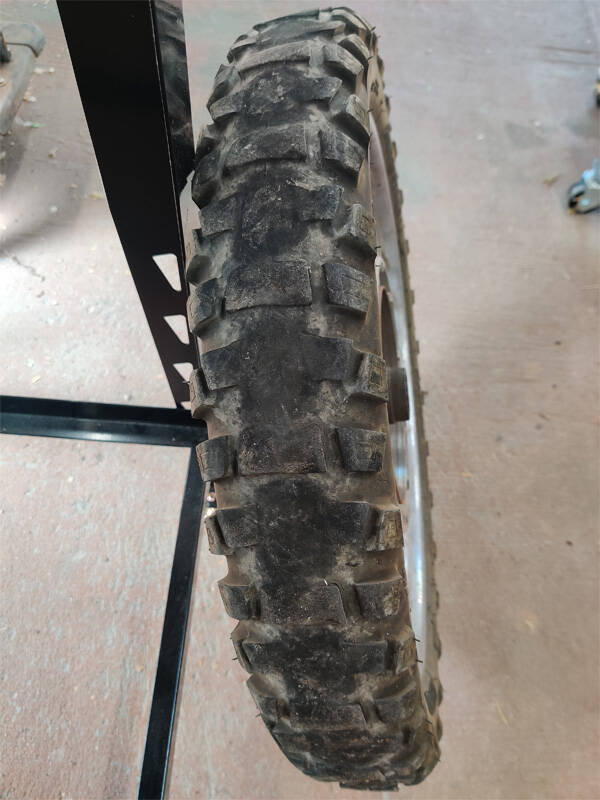

Tire wear is flat across the center with just a bit more wear on the left side.  Front tire will remain on the rig.
Motoz GPS Front 4200 Miles

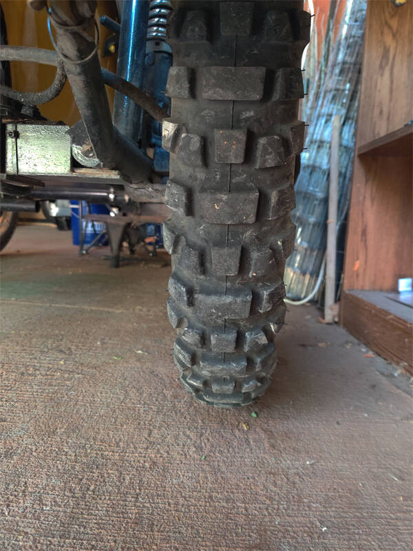

Motoz GPS Rear Pros (run in the off road orientation):
  • Great off road performance no matter the conditions
  • Bi-directional mounting
  • Quiet and smooth running on road
  • Comfortable ride
  • Fairly ambivalent to tire pressure
  • Good fuel mileage
  • Good wear characteristics (could be turned around and run for another thousand plus miles)
  • No chunking, tearing, or exaggerated edge wear (Off road was very aggressive riding with a lot of half buried sharp rocks)

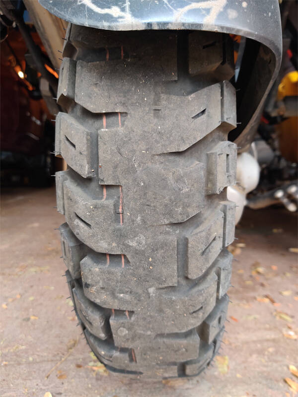

Motoz GPS Rear Cons (run in the off road orientation)
  • Minimal side traction on the road
  • Wore to the sidecar side more than expected (As Drone @ned noted in another thread this is most likely due to more aggressive left hand turns)
The rear tire will be kept for a spare.
Motoz GPS Rear 4435 Miles

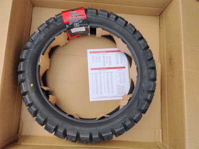

Next up on the "Tire test" fun.
Tusk 2Track for the rear. https://www.rockymountainatvmc.com/tires-and-wheels/tusk-2track-adventure-tire-rear-p
It now comes in the proper R1100 GS size. 🤩  Just waiting on the temps and sun to come out, to aid in mounting (probably next week).
Tusk 2Track Vertical
Brown unmarked box of goodness: 😎
Tusk 2Track Horizontal
This tire is incredibly inexpensive, and with a stash of RM cash (thanks to playing the SMX RM Fantasy game), delivered price was just under $94. 🤩    Of Note I am a fan of Rocky Mountain ATV/MC, but have no affiliation.  They just have treated me great over the past seven years.

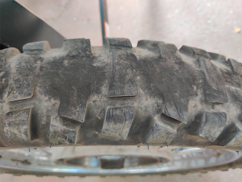

7,000 miles later the Battlax AX41 installed on the sidecar is worn out.
700 miles:
AX41 700 miles
7,000 miles:
Worn Out Overview
Worn Out
 This tire has been from Utah to Tennessee, to North Dakota.  No flats along the way, even when run at fairly low pressure off road.  Has also been seriously abused off road.  My opinionated and subjective view points:
Pros (listed favorite to bad humor):
  • Super smooth and comfortable ride (ran at 32 psi).
  • Pretty quiet for an aggressive off road type tire.
  • Great off road traction, and kept me from sliding off the trail on off-camber & rutted trails.
  • Knobs never tore our gouged over sharp rocks embedded in the trail.
  • 7,000 miles, with lots of power sliding on and off tarmac.
  • Aggressive "Monster Mudder" looks.  Each time I went into the garage I wanted to dawn the Extreme Sport Announcer's voice, and shout; Sunday! Sunday!, Sunday!... Be Therrrrrrre!
Cons (Listed least favorite to really bad attempt at humor):
  • Very limited traction on the street.
  • side & head winds made a more significant difference in pull at the handlebars compared to the Block-K it replaced.
  • Shorter sidewall than the Block K made it look small in the fender well.
  • A sidecar tire that only lasts 7,000 miles?  What is this world coming to?
Conclusion:  For a more road biased rig this, in my highly subjective and opinionated viewpoint, is not the tire to choose.  Even a rig that sees a lot of fire roads, this tire is too sketchy on the street to be useful.  I think there are much better choices.   In the extreme off road this tire worked very well, and saved my bacon more than once.  My buddy who rode Monkey was super happy with the ride though, and even at low pressures it never pinch flatted or flat spotted the rim over some serious boulders.   If I had an off road specific sidecar rig that wasn't going to see mud, it could be a good choice.
Most likely replacement will be a Duro HF307 in a 4.00x19.  I'm moving away from the more extreme trails, to easier Jeep/ATV trails and fire roads.
