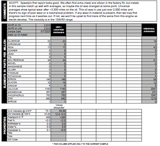

Mean time I did an oil change at 2K miles, and sent a sample off to Blackstone Labs.  There have been a few engines with catastrophic damage due to a loose cam chain.  Normal oil change interval per Triumph is 10K miles (after the initial change at 650 miles).  Would be nice to catch any potential problems before adding the sidecar.

Question:  WHY are you sending oil samples to Blackstone Labs ? What do you think you are going to do differently, depending on that the lab results show ?
I am saving up a small medicine bottle worth of OLD...USED...engine oil, so that when your SYZ is parked at the National Sidecar Rally fairgrounds, I can spill some of this OLD...USED...engine oil on the ground under the engine of the SYZ, and cause you to run screaming towards the booth that has all the donuts, in an attempt to squash your angst by eating a jelly filled donut.

My thought on the Triumph service interval (which is actually 10K miles or one year, whichever comes first), is that Triumph feels pretty confident in this engine.  Their warranty is two years unlimited mileage.
Use of Blackstone Labs is simply because while ignorance may be bliss, I prefer to suffer.  Decisions based on competent objective information rather than subjective experience, stigma or myth works best for me.  Maybe a career of supporting engineering groups has warped my thought process. 😯

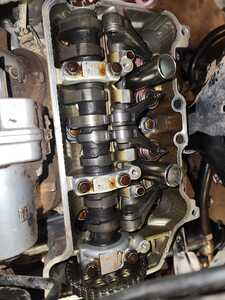

@scott-h don't feel too bad, I change both the Landcruiser(s) and Black Betty (that sweet girl's) oil at or about 8,000 miles, OEM recommendation.
Yeah, detergent gets consumed, viscosity breaks down. Etc.  Use good oil that exceeds mfg spec. Bonus points for full syn , and sleep well.  OEM filters, usually...
Landcruiser 1 is 23 years old with just shy of 300k miles.  No oil consumption, no noises, idles perfectly.
Landcruiser 2 is a baby, at 12 years old and a little over 100k of hard miles (wife drives it.)  No issues, no oil usage.
BBTSG is 4 years old with one of those years parked at DMC WaWa.  44,000 miles and engine looked like this when I pulled the valve cover at 41,000 miles.

Speedy's oil report is back, and I'm happy with the results.  It appears to have had it's 650 mile service done (as matches what wasn't in the strainers/filter).
By the next oil change the engine will be fully "broken in".  From there it will just be base-lining to use in comparison once the Spyder is affixed.
