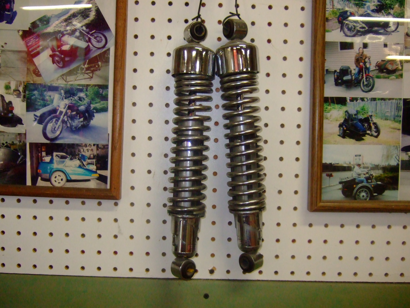

I've got a set of nice take-off Harley Chrome 13 1/2" shocks. Had a short lady client who wanted 12"ers installed so it was easier for her to mount up.
I'll take $60.00 for the pair + shpg.

Hack'n - 3/22/2011 11:24 PM I've got a set of nice take-off Harley Chrome 13 1/2" shocks. Had a short lady client who wanted 12"ers installed so it was easier for her to mount up. I'll take $60.00 for the pair + shpg. Lonnie Northwest Sidecars nwsidecar@aol.com 208-629-8409
Lonnie,
Are they adjustable for damping and rebound...? How about the springs, heavier than the stock Guzzi EV coils...? I can measure the ones I have if that will help.
These are not air shocks are they...? I may have an old biased about air shocks as they Used to be prone to blowing out.... prolly not the case now huh...?
Well for 60+ bux I could try those before spending much more on longer shocks.
Speaking of which, what would that do to the dynamic of the rig, I thought about installing 14-3/8" long shocks vs the stock 13-1/2"...

The Harley springs have 1" adjustable ride height. 3 resistance settings.
