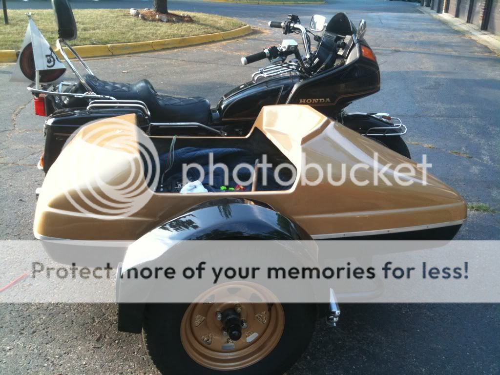

After reading the thread on cutting a door into a sidecar, I'm a little hesitant to ask this question, but here goes anyway.
I have an Auburn Gemini (predisessor to the Ride-by-Side and Texas TwinStar). I find it's difficult for an adult to climb in what with the wheel and massive fendor right in the way of the threshold.
Photobucket
The car body is basically a fiberglass 2-piece clam shell, riveted together through an aluminium band. I've been toying with the idea of cutting the upper shell by following the contour of the fender, drilling out the rivits then hinging the front portion at the nose. Some H-channel trim with weather stripping, some rubber T-handle hold downs and some lifting struts and/or springs should do it. The fiberglass seems pretty stout and shouldn't need to have much structural framing added (will need some at the hinges for sure).
I'm not so concerned about resale value as I am safety and functionality. Having to ask fully grown adults to climb over that fender gets old and will prolly result in a cracked fender anyway. Climbing in over tha back may result in the cracking of the trunk roof and eliminates adding a convertable cover frame.
Anybody try anything like this before? Any advice?

WHAT??!! Move the tub forward on the frame?? That means I'd have to drill like... FOUR new mounting holes! MAN! It's never EASY!! 🙂 🙂
>end sarcasm<
LOL! an elegant solution, Lonnie! Definitely worth the wee bit of time it would take to try it out at least.

It also looks like the body is pulled forward on the frame too by about 10 to 12 inches. Am I wrong on that? A large step would also be needed.

(@oldschool_iscool)
Posts: 463
Yes I did ask for advice, and I appreciate your replies, Lonnie. You have forgotten more sidecar info than I ever hope to learn!
Judging by the photo you posted, it looks like pulling the tub forward may be an option (anyone with a TwinStar have nose-to-front mount measurements?) With the car pulled forward of the fender, the threashold can be accessed more easilly. A broad step will make a much more stable platform for the passenger to use when loading than the round frame rail.
Thinking further, a stout bow to hold up the rear of a convertable cover could be installed and could also serve as a hand grip for the passenger. If I add additional frame rails out the back, I could even mount a luggage carrier, much like those that fit into hitch receivers. That would help balance the hack both mechanically and aesthetically.

Yep. Hardest part about these sidecars. As you see in the photo Lonnie posted, the later ones like that one and mine, have cross bars that make a really good step getting in. You could add metal or a wood step in that area of your frame to add a good step. With that, it's pretty easy for my wife to get in (out is tougher). I have people use the step, step on the seat and then get in. To get out, I tell them to scoot up onto the rear of the sidecar and step from the seat to the step and down. My fender is smaller than yours. Don't know if the tub is any farther forward. Even with that, I've considered cutting and hinging at about the same distance down as Hannigan does theirs and adding a lip with some weather stripping. To lock it down, I considered using old jeep hood latches or something along those lines.

(@oldschool_iscool)
Posts: 463
Here's another angle that shows just how far to the rear my tub is mounted. Much different that what Lonnie's picture shows.
