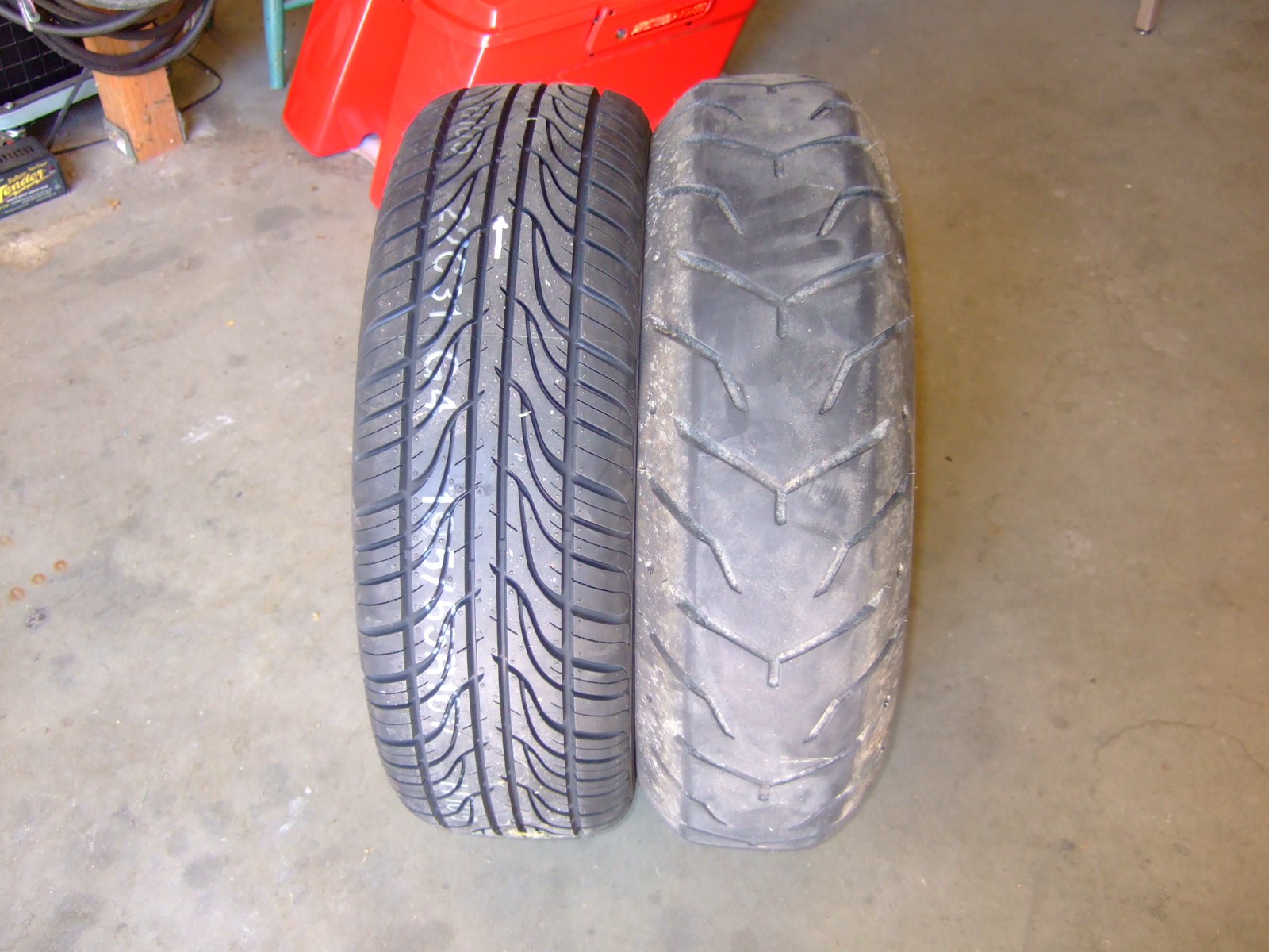

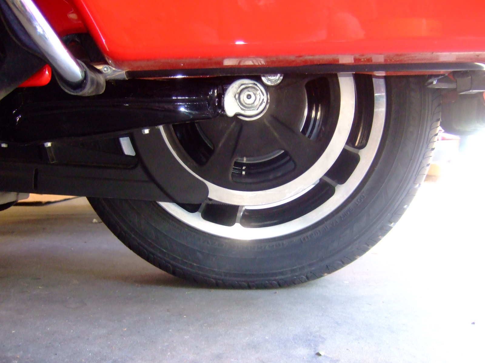

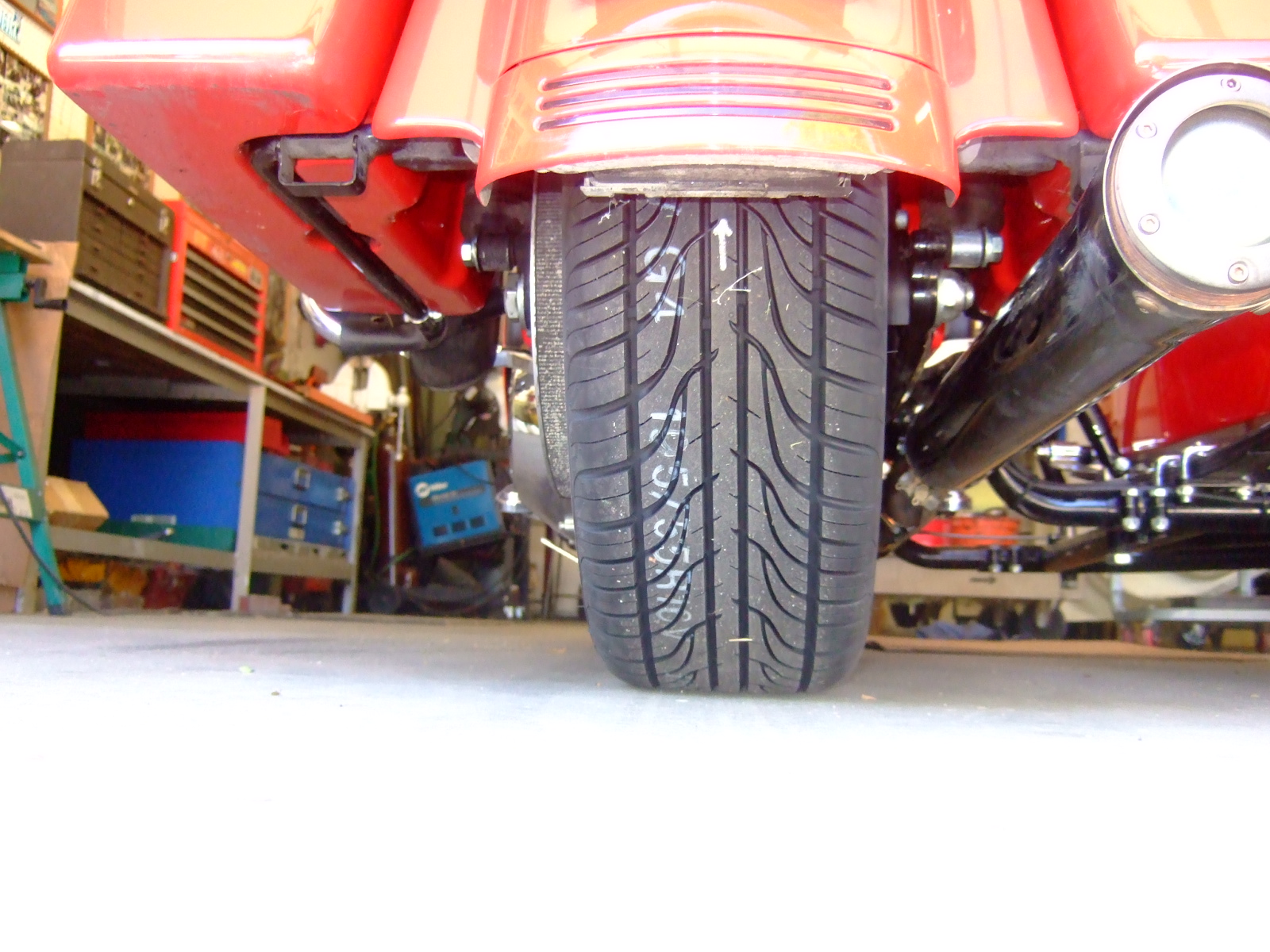

After burning up a $300. Harley rear tire in 7,800 miles I just switched to a Hankook Sports radial car tire. It was a tight squeeze being about .68" wider than the OEM tire but it fit with about 1/8" belt clearance on my '10 FLHX rig. The HD skin cost $.043 per mile to run. This one will cost less than $.005 per mile. A considerable saving tire wise. I'll keep using the 17" HD Dunlops on the front and the sidehack since I haven't found an auto tire to fit.

High performance sport radial. 195/55/R16 Not too many brands offer this size. Cost is about $200.00 less than the Harley 180 Dunlop and it will last about 4 times as long. Original tire was worn out at 7K.
GPS shows about the same error as the stock worn OEM tire. Tight fit, 1/8" belt clearance. Ride is softer than original Dunlop.
