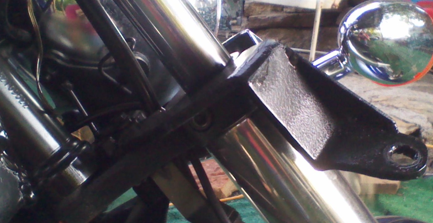

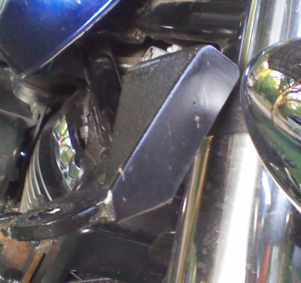

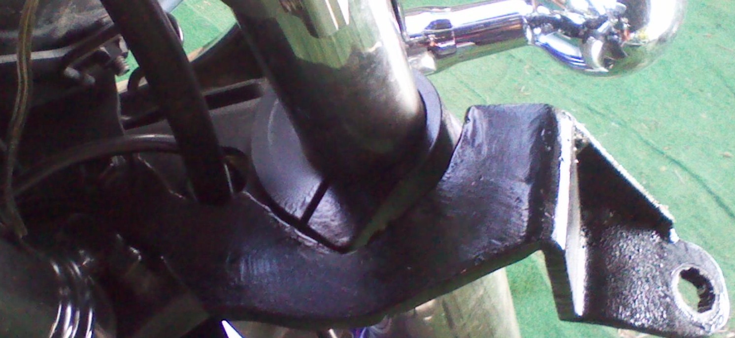

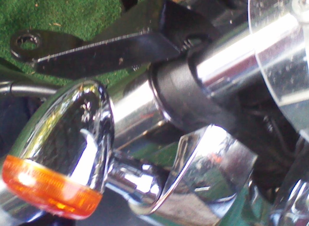

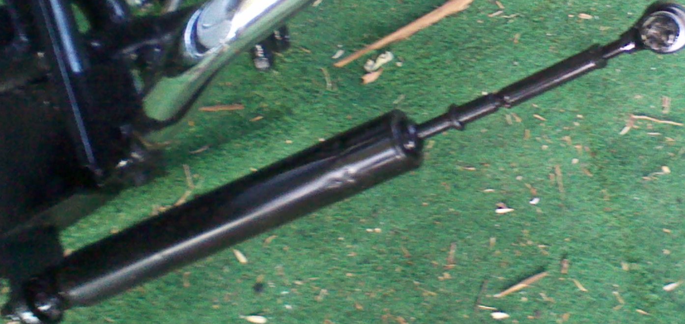

there is 5 pics on how i put a damper on my wifes c 50 08 boulivard in my album. i dont know how to put them on this post.
Posted : July 26, 2011 5:37 pm
(@siouxindian1)
Posts: 7
when i put the damper on all the shake went away. the side car is off right now but you can see the bracket i made it bolts to the 2 bolts that holds the headlight on. the shock mounts by the front upper strut.
