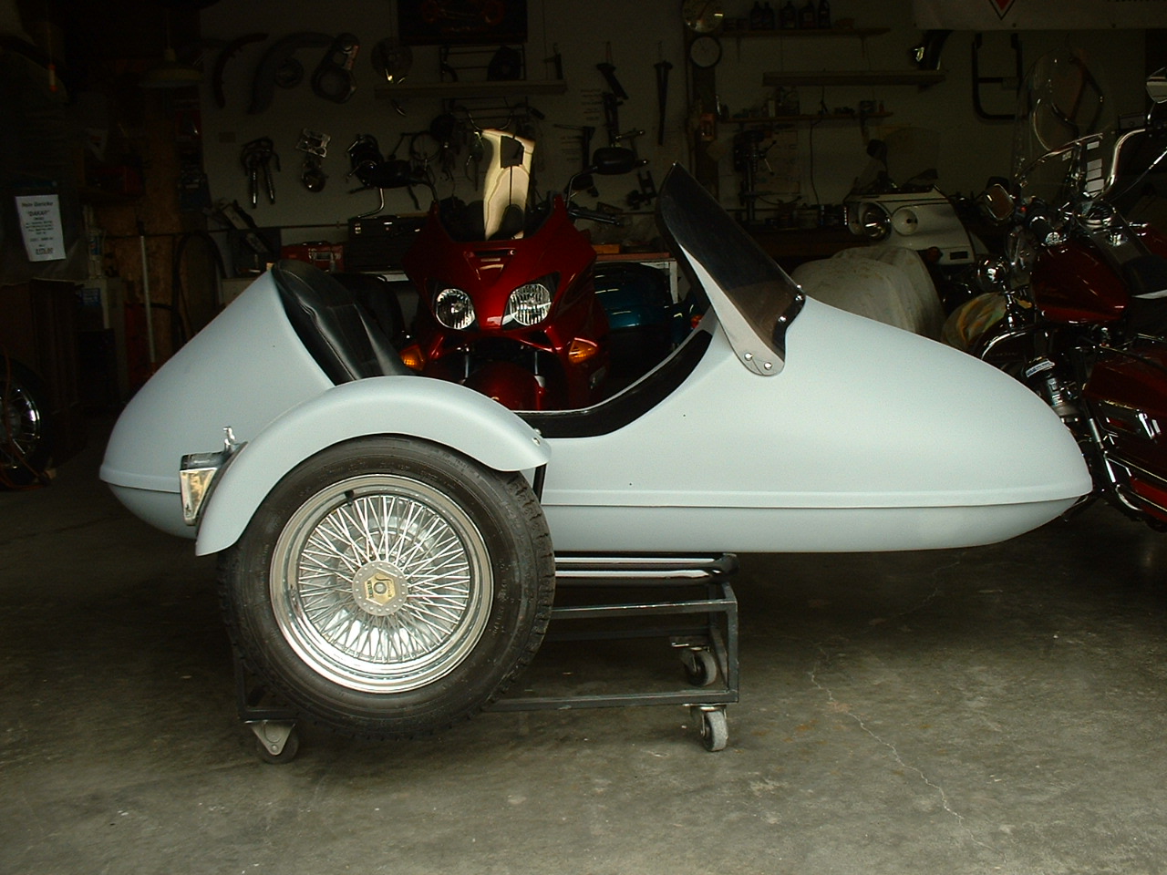

Here's one with a fender change. I also did a Harley fender and wheel mod several years ago on a "leftie" companion bound for OZ but I can't find the old pix.

Lonnie - Love the wheel. I hope you're ready for a bombardment of questions 😉
Where did you source the wheel from? That doesn't look like the trailer wheels I've been eyeing. I could go Harley wheel...
Could you take a picture of how the fender attaches? I'd love to see the area between the fender and the body as well as any pictures you have of the suspension. Do you remember how much you cut the swingarm? Per Jay's notes I'm likely going to go the trailer hub and new wheel route. I'll let my machinist take care of the detail things but the more detail I give him the better he does.

With an axle change you can go with a Motorcycle type wheel, In house we would cut off the axle and replace it with an axle for a Harley type wheel. But then you still will need a different fender and as your fender is boded onto the body you would need to also clean up the body where you cut the fender off.

It was a narrow chrome 16" auto wheel with a spoker basket wheel cover. I think you can see the front fender brace.
This was an old pic, scanned to digital. I didn't make many construction pix before I got a digital camera. Too hard to file then so many got lost.
