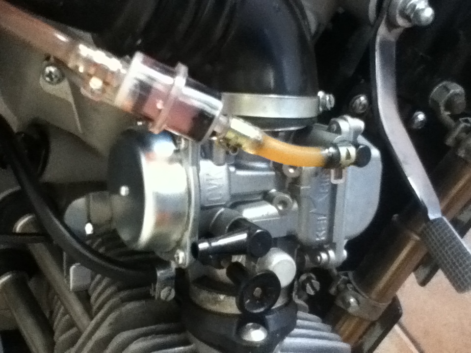

Hello friends,
Yesterday I finally finished all paperwork for to have my Ural Patrol, Sophie Travelair legally on the road.
I fooled a bit with the original carburators as the carbs ran very fat and would like to put the question into the air.
What are the jet sizes you use?
Mine have Pilot jets # 65 (sounds way too big for me) and it does not have bleeding holes as usually I had in 4 strokers. )or the jets Racewayservices supplied me.
The air screw I opened from 1 turn to 2 turns, as this is supposedly in order to lean the idle mixture (accourding to the tuning manual in my hand)
Main jets are #125 (which were very lean in Oregon's summer. But here in tropical Costa Rica 10°N, 84°W at 1200 to 1700m = 3900 - 5600 feet and 18-28°C = 64-82°F it looks a little too fat.
The adjustable gas needle I got from Racerwayservices (6 steps) I passed from 3rd into 4th step read from bottom to top = leaner.
For now I feel a bit crispier the throttle, but did not have the change to make a plug test yet
I guess I will have to get me a better tuning manual and gain a lot of experience in this matter. All these 32 years I never before saw the need to change jets or tweek on carbs as my former bikes never fooled me in this area..
For only 400km I can tell that I have a gas consume of 10,5 - 11 liter per 100km = 22,5-21,5 miles per galon.
I appreciate your advice or hints where to find a plain talk tuning manual for these actual carburators.
The photo should be turned 90 °. The nipple cap got lost in these days and the choke got twisted. when, where or how,- no Idea. Somebody envious?

Sven, here's what seems to be some good general carb tuning/jetting advice posted by KenH at http://www.twtex.com/forums/showthread.php?t=92402 -- more follow-up details can also be found there:
...First, make sure everything else is perfect. Many $$$$ have been wasted on carbs when carbs were not the problem.
Remember this: Roll-on test: If it dies, it is lean. Go richer. If it bogs, then accelerates, it is rich. Go leaner.
To test the main, start at half throttle, mid rpm range. Roll on quickly. Go one step at a time on the main jet until you get a smooth transition.
To test the needle height, start at 1/4 throttle, low rpm. Roll on quickly. Go one step at a time on the needle height until you get a smooth transition.
Retest main to make sure you haven't shot yourself in the foot.
To test pilot jet, start at no throttle, idle speed. Roll on quickly. Go one step at a time on the pilot jet until you get a smooth transition.
Retest main and needle height to make sure you haven't shot yourself in the foot. Tweek the pilot screw once the roll-on test at low speed gets you in the ballpark with the pilot jet.
Other clues: If it is hard to cold start and won't cold idle without lots of choke, requires choke to start when warm, surges at cruise, or pings, it is lean or the spark is too advanced. If it smokes or burbles, it is too rich.
See, you really can tune a carb and never look at the sparkplug. All you have to do is let your britches be your guide.

Do you still have the catalytic converters in the header pipes? If so, you should stick with the stock jetting of #125 main and #38 pilot, air screws set at 2 turns, jet needle on the third height setting. If the cats have been removed, you should upjet to #130 main and #45 pilot with jet needles set at the fourth notch and airscrews at 3 turns. These are how we set up Urals at my shop, but you might have to go a size or two smaller depending on the elevation down there. Keep an eye on the spark plug condition/colour and adjust the setup as necessary.
There is actually a third "jet" in the carb, it's used in the start circuit and is size #65. Don't touch that one, leave it as is. The pilot jet is the small one way up inside the small tube, you'll see it when you remove the float bowl and turn the carb upside down.
