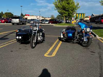

Here is my HD Ultra with a Liberty sidecar and my wife's HD Sportster 883 with a Dpner sidecar. I just had her triple tree replaced with a 4 degree Rake. I have not had time to pull the steering dampener off to see how well she rides without it yet.

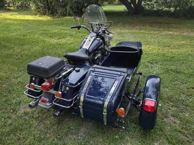

I have a bit of a hybrid setup using my original HD sidecar frame and simply taking off the factory fiberglass tub and replacing it with a Ural tub.  It's about the easiest thing I've ever done with this rig as I just drilled a couple of extra bolt holes and this way I still have my factory disk brakes, fender, lights, wheel etc...
I've come across a few HD sidecars with damaged tubs but the frame is just fine.
Just an idea for you.
The reason I did this was the Ural tub is a great deal easier to get in/out of and personally I think it looks better than the HD tub.  Old boy down the road who's a heckuva paint guy matched it perfectly.  Bike is a 2000 Road King Police.
