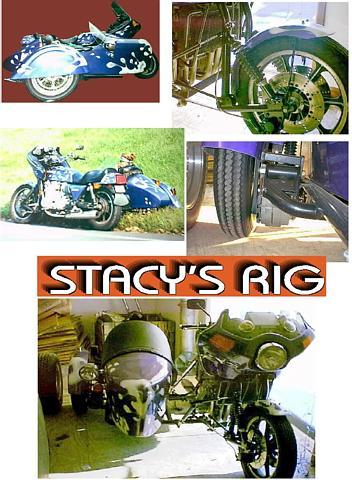

one of the members here ran an alternator off the sidecar wheel. He had a very clean install wired directly to a car battery in the chair as I recall. There are pictures of it on the SCT (yahoo group) site, although they were probably moved to one of the SCT pic sites. I have some buried in a box of photo cds somewhere. I'll try to find them.
Actually, I think it was Stacy's purple rig that was advetised here off and on for awhile.
here's a pic https://www.sidecar.com/megabbs/photos/show-album.asp?albumid=391¤tpos=1
For a bike that would not be a good candidate for a car alternator or a replacement stator this would be a good idea. Might take some electrical engineering as well as some fabrication skills but still, worth considering if you plan on some high draw accessories.
Posted : October 9, 2008 6:22 am
well I'll be damned!,..that is the smartest thing I've heard all day,..thanks for the pics of stacy's kawi,..very good reference,..I myself run a deep cycle truck battery , fed from the bike's batt/alternator combo for the extra umph req'd to run the kid's DVD and radio,,...nice idea with the chevy alt tho....may just try that....crawf.

Nice thing about using a Chevy alternator is you can get a self-energizing voltage regulator model, aka one wire model, and all you need is a single wire from the alternator to the battery.
Posted : October 9, 2008 2:33 pm
The positioning puts it in harms way ground clearance wise though.
Posted : October 9, 2008 3:13 pm
purhaps this winter, a more creative location could be found???? lonnie is correct, this needs more protection in the harsher climates,especially in off season riding,...HMMMMM!.. to the lab Dr. Mal Practice...we have work to do!!!!
Posted : October 9, 2008 3:29 pm
I read this thread yesterday and the question that is floating in my mind is why does this require a drive belt on the axle? Why not position the alternator 90 degrees to the wheel and use a friction drive to the sidewall of the tire, it would take some figuring to get the ratios correct but would give more options for alternator locations particularly if the friction drive is a jack shaft the alternator can be positioned in a box elsewhere. The older snapper riding lawn mowers used a metal drive disk and rubber friction drive for their variable speed drives and those things lasted for years the wheel changed position on the disk for slower or faster speed.
