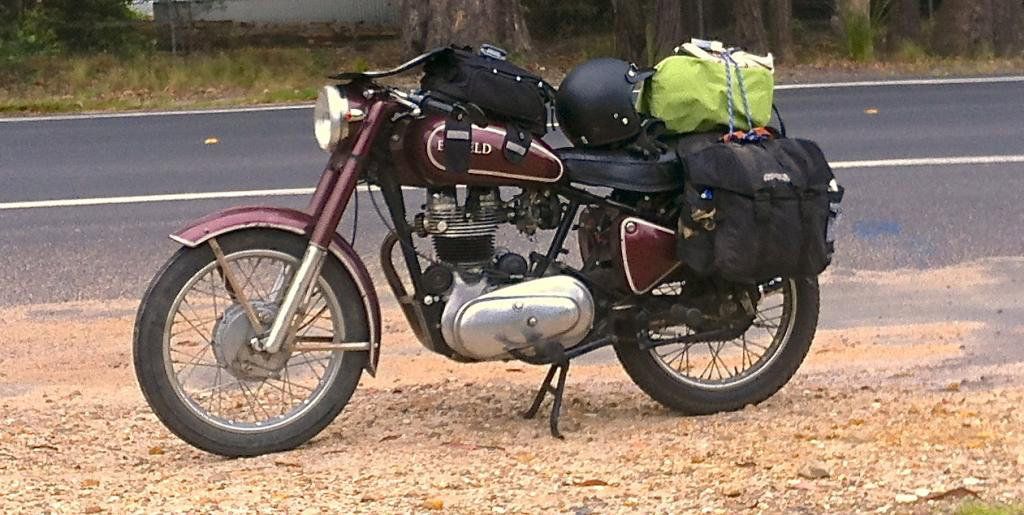

My current daily rider tourer is my beloved 1970 350 Bullet. Now under normal circumstances I would think it is a bad idea to attach Sidecar to a 350 Bullet but mine has been a long-term project and has had a lot of work improving horsepower torque and most importantly reliability.

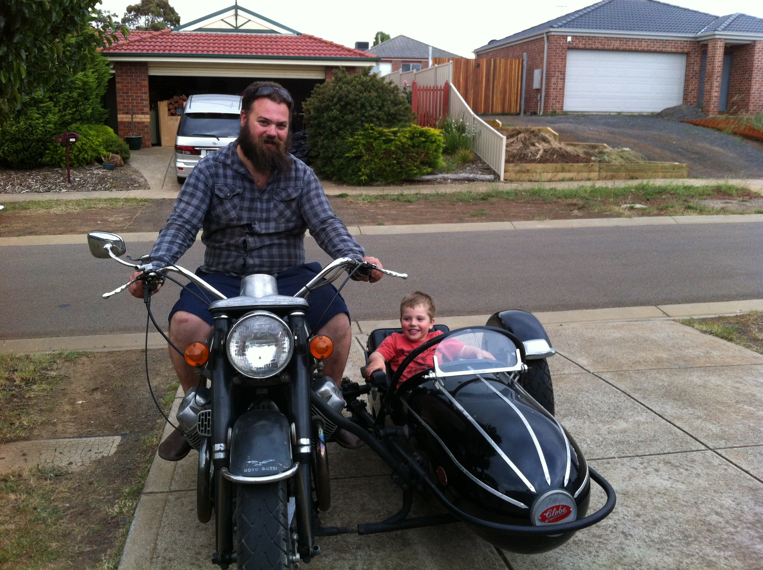

Welcome Gav. The young fellow in the sidecar sure looks like he'd enjoy a ride! I/m deferring to folks with more experience than I to address your technical questions.

Welcome to the forum. By the first picture looks like miles of smiles.

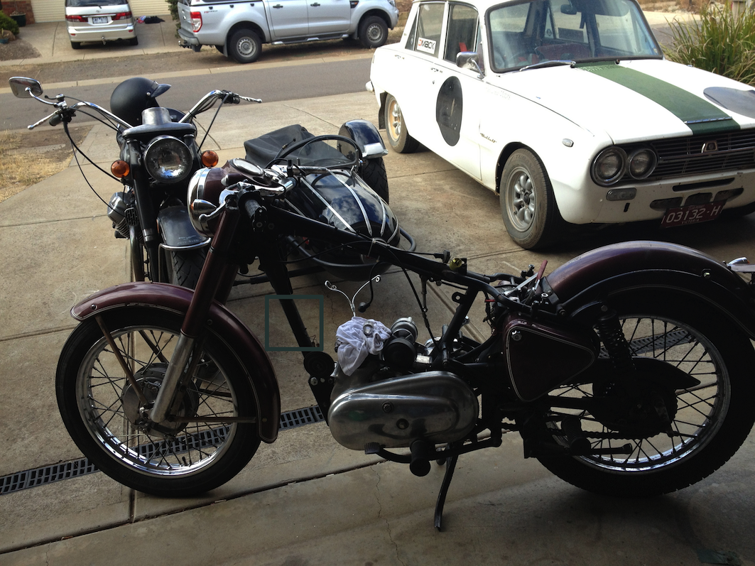

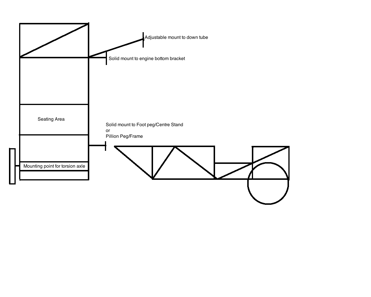

As it stands at the moment I have a few lengths of 30mm x 30mm RHS with a wall thickness of 4mm (I will let you clever people do the imperial conversion 😉 ) sitting on my shed floor. I bought this stuff as my practice material and while shopping around fro it I was also able to find a great steel merchant who is not far from where I work. I plan on making the base frame out of this material. I have also found a supplier of rubber torsion axels and I plan on going to visit him during the week so I can have a bit of a chat on what he has available to suit my purpose.

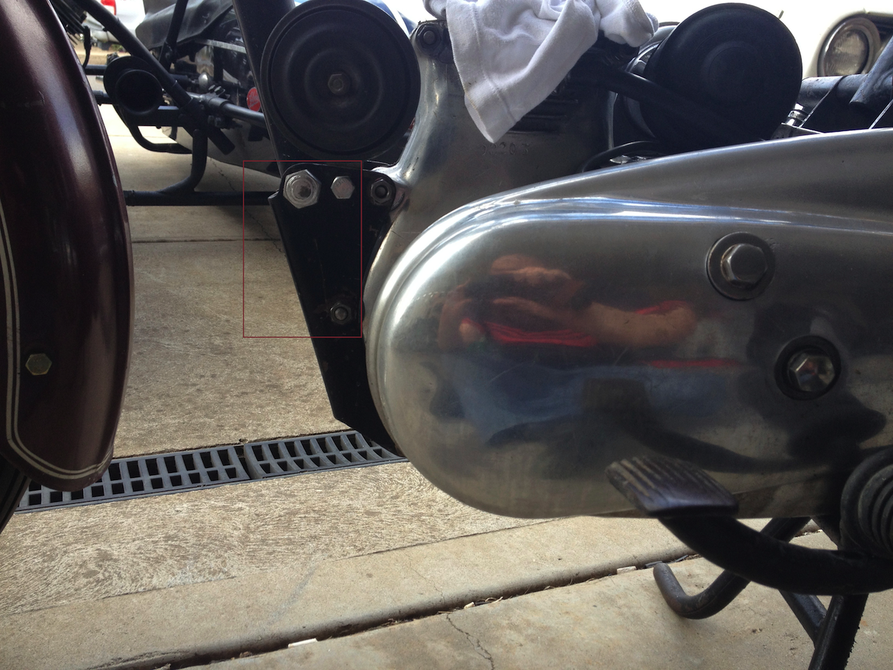

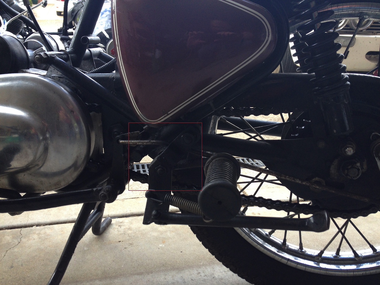

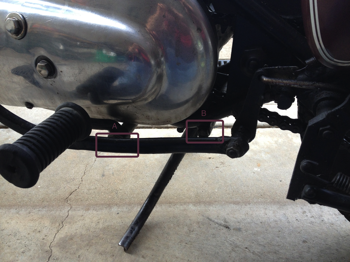

I have made a quick sketch of what I am aiming to end up with. I have also added a few pics of where I am thinking of making the mounts for the hack. I would love a bit of input into this as Iam really only guessing they will be appropriate.

Here are the pics of the potential mounting points. They were a bit big and didn't attach the first time.

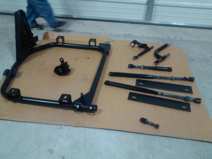

your using 1 1/4" square tube 1/4" thick wall and that much of it in your picture. Might be a little heavy for a 350 Bullet. here is what a Velorex fram look like. It's light weight but I have seen many on here and I have tortured mine with my Sporty and the grandson loves riding the Twisties in it.

Another advantage to a frame design like Doug's (WVSporty) pic shows is that, if you keep the frame and the tub as seperate units, than you can swap out the tub for different modules. Say a flatbed with staked sides to haul camping kit or a rail with wheel chock for transporting a solo bike (think dirt bike or a roller being repaired). I've had the thought of building a wheelchair-capable tub so that I can give rides to those who otherwise can't strattle a bike.

Oh, and for your lower mounts, it's critical that the lower mounts are on the same plane above the ground. Think of the hinges of a door. If the hinges are not properly alligned, then the door will slope up or down as you open and close the door. Similar thing with a sidecar. If the lowers are not at the same hight above the ground, then when you adjust your lean, your sidecar will twist, throwing off your tow-in.
