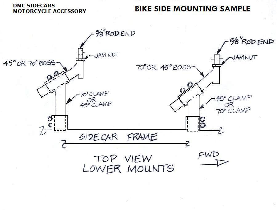

Your lower mounts are the type that are known to fail. Your upper rear mount is a Motovation sidecars mount and is installed in a way that it is very likely to slip. Normally the mount is placed on the main frame down tube and is of a type much less likely to slip then the Motovation mounts. Also it is installed in a manor that the forces applied are not trying to rotate it around the frame of the bike. In other words in line with the strut. The lower front is an early California frame clamp that is known to fail. Latter ones have 1/4 inch bolts to keep the "U" part from coming off of the block. Also it is installed improperly in that it should not be on curved section of the frame. Where it is installed not only does the frame curve up but also in. While these mounts have been working in the long run I would not trust them. The ball collet mounts California has some fail before they ever got out of the parking lot and these failures may have contributed to them going bankrupt about 30 years ago. There are several issues with these ball collets, the collet with even a slight amount of where on it or the ball which is a soft material called leadalloy the collet will pull off of the ball. Your upper rear mount is installed correctly however it to is the type of frame clamp that is known to fail. The lower rear being mounted higher then the lower front makes it hard to set the alignment as when ever you change your lean out, your toe goes the wrong way. So if you are trying to fix a pull to the right, you would lean the bike to the left which toes it out causing more of a pull to the right.
Lots of ways you can fix all of this, we of course offer mounts $775. Our mounts do use frame clamps for the upper two mounts. The lower front mount clamps to the frame tube and picks up the engine mounting bolt. The lower rear replaces the center stand and ties to the side of the bike putting the mount aft of its current location and below the muffler so that it is closer to the same distance off of the ground as the lower front. You would also need to replace the bosses (the part with the collet) these run $65 each you have a 45 degree and a 70 degree at this time and you would need two hiem joints $40 each. You could also drill for cross bolts on your upper rear, relocate the upper front, and fabricate new lower mounts doing away with the ball collet set up. I have personally had every one of these type of mounts fail on me when running a GL1100 friendship 1 rig.

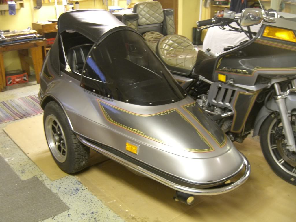

My dog coming on motorcycle rides is the reason I bought the rig. The little windshield is to short to protect my dog while riding in the sidecar. The shorty also won't allow a roof to mount over the dog's head. If the rig was primarily to be a show peice I would leave the windshield as is or more realistically would have bought a motorcycle without a sidecar.

Thanks for the input. It would be a good idea except dog would have a tough time getting in, couldn't sit up all the way and more often then not the roof won't be on the car so the dog would still be stuck without enough protection. Also I am not sure how much longer the shorty windshield is gonna be a viable windshield. Judging by the weathered paint job and paint lines showing a full height windshield used to be installed and because the car came with the original cover more then likely the small windshield used to be a big one that was cut down due to deterioration and cracking. What is at issue is the rig was bought new, built and ridden a long ways by its first owner. When they past on it was left to someone who only rode it a few times and mostly let it sit outside for many years. Everything is really heavily weathered. The upper photo looks ok because its from the side. Looking down on the rig is different story. The little windshield looks ok though I wouldn't trust it enough to spend money in a custom top for it in case it cracks and deteriorates further leaving me with having to buy a new windshield anyway and then another top to boot. I would like to use the original top too so the windshield really does need to be tall and close to OEM spec. In other words I want my dog to be comfy while maintaining the OEM looks and style like the below pictured rig.

I just went out to have a close look at the windshield situation. When in close I noticed most if not all mounting hole screws are cracking in the little windshield. Definitely gonna be needing a new windshield sooner rather then later.
