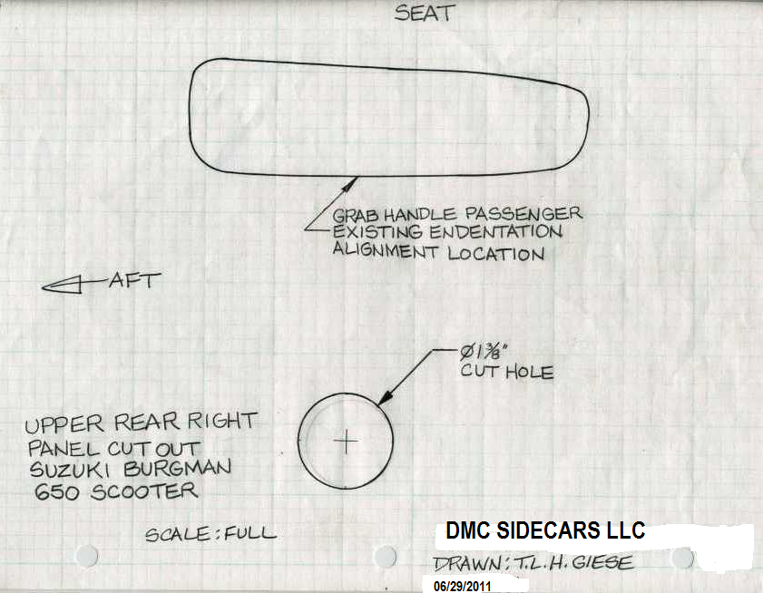

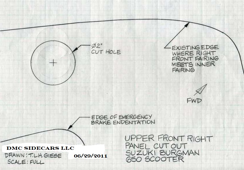

I am attaching our full mounting instructions for the Burgman, You will see that our mounts do not interfere with the use of the front of the floor board like some others but more important at the bottom of the instructions are the wiring instructions.
Burgman 650 Instr 1-4-07.docx (1.4 MB)
