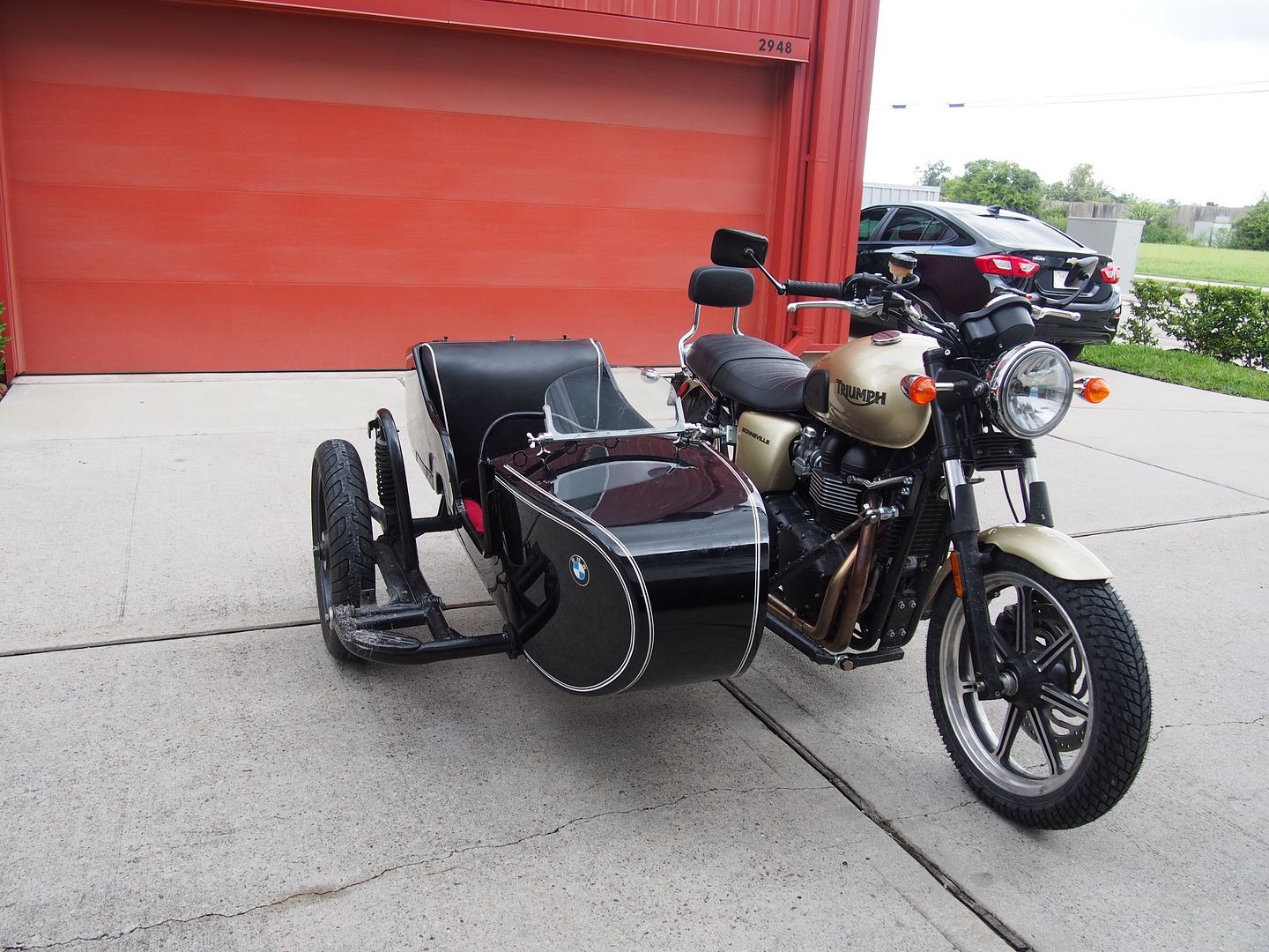

I ended up going bias ply because they fit the narrow rims best and finished mounting the car this week.
Still some little things to do like fender, brakes and turn signals, remove the BMW badge on the car, and a new tire on the sidecar but here it is:

The Bonneville/Dnepr combo looks very good. Nice job.

Jim, you have good looking rig going there. Don't remember see that tub in Houston, where did you find it? Both the bike and the tub are looking good.
Did you make your own sub-frame?

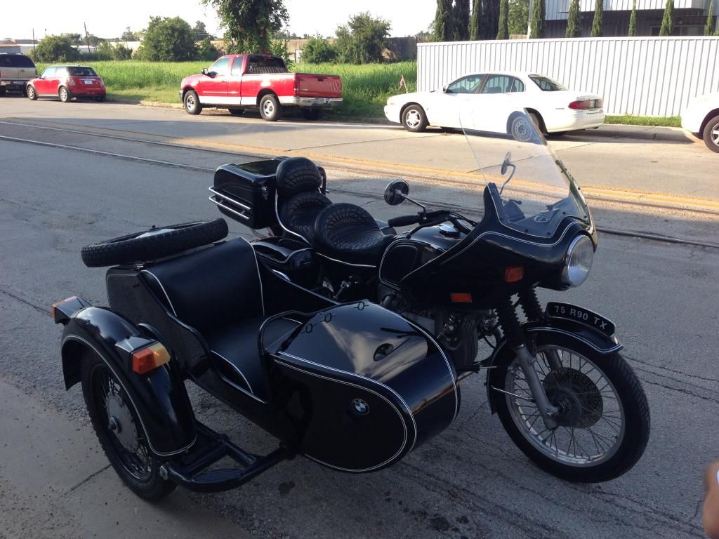

The subframe was purchased from DMC Sidecar in Washington.
The tub was attached to my R90/6 previously:
