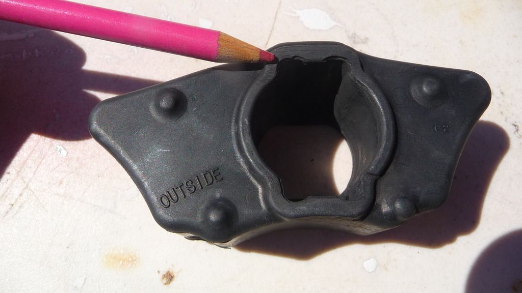

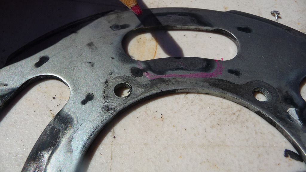

The bike had 120,000 on what may have been the original parts and they were looking rough. 8000 miles later now and the tire is down to the wear bars. Time to replace it. I have decided to try to run a 185/65 R16 with a high wear rating. A friend came by and pulled the rear wheel off and we had a look inside. The aluminum center bushings in the rear wheel rubber dampers (cush drive) had machined their way through the retaining lip in the rubber and are wearing away the retaining plate. They are trying to head away from the wheel towards the final drive and sidecar. You can see the damage to the rubber damper at the top and bottom of the hole the bushings shown sit in if you look at the pointer in the picture. The retaining plate has about .010 of wear in a few places. (pencil points to one) Those aluminum center bushings are themselves machined down. .060-090 or on the side that was rubbing on the pictured retaining plate. The one on the left is turned over to show what they look like when installed. It's worn down side is facing down.
They look worse in person than in the pictures. All those new and expensive parts failed in only 8000 miles of driving. They look about like the parts I took out that were probably original with over 100,000 miles on them. The exception being that the center holes are not out of round.
