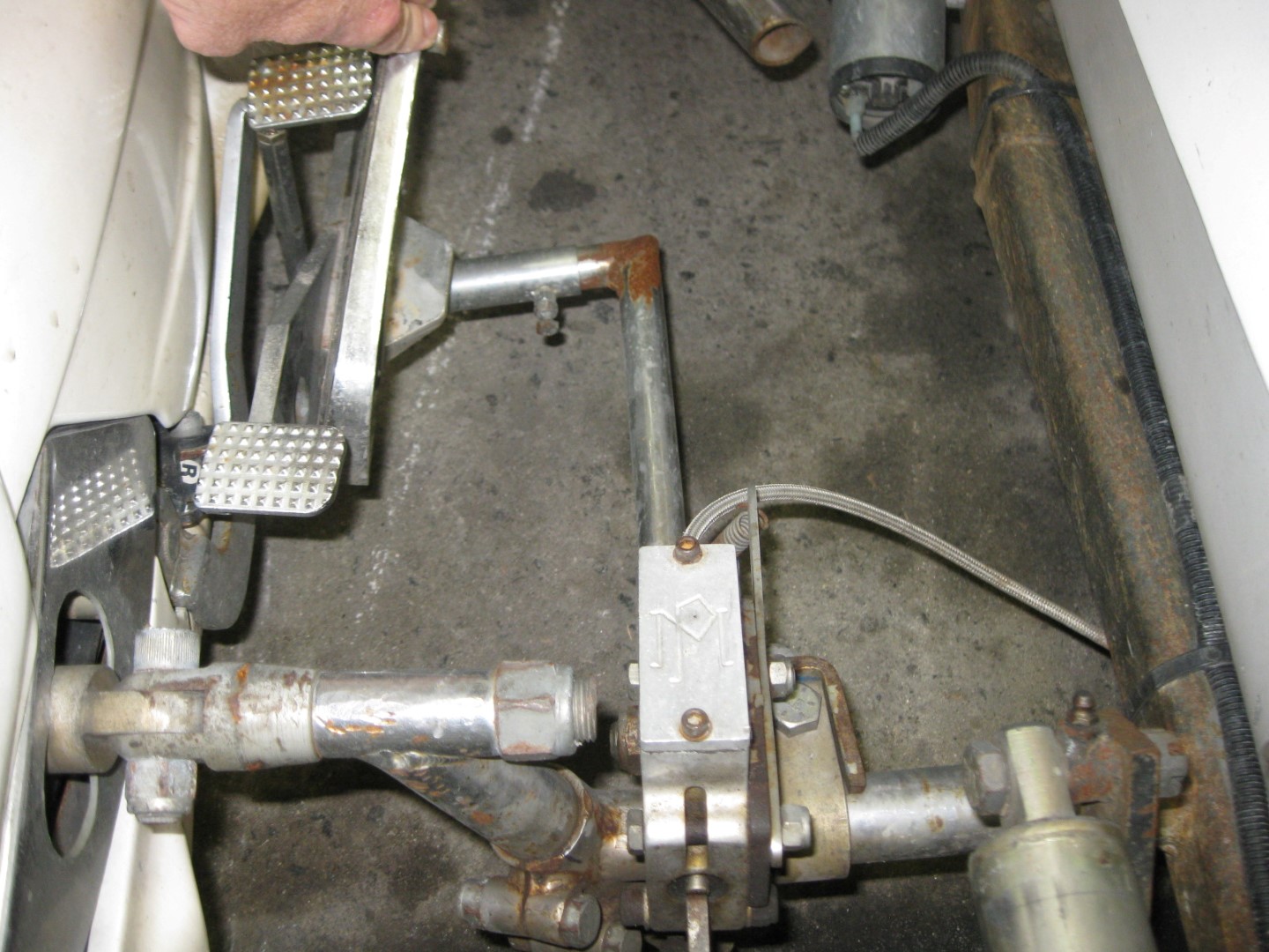

I took a different approach to setting up the brakes on my car. It came with the self contained brake system with it's own pedal. I just couldn't wrap my head around having 2 pedals and didn't want to change my master to be able to use the bikes system. so I cut the brake arm at just the right length and welded it back together at a 45 so the arm now went under my foot pedal of the bike, I then adjusted the master for just the right tension and application of brakes on the car to match the rear application on the bike. what I wound up with is great brakes all around and I have NEVER locked the brakes on the car as of yet
even on wet ground.
