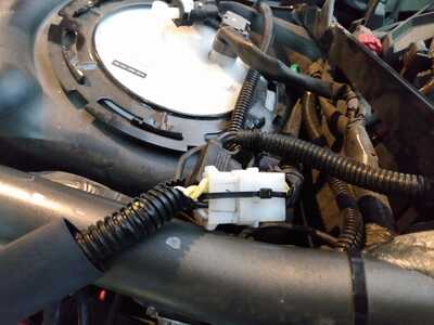

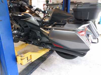

When I was in Maine, at the USCA National Sidecar Rally, I noticed that my ECC was not always working, as in...Intermittent, and decided that rather than mess with it there in Maine, I would wait until I got back home to my own shop in Washington, and fiddle with it then. As it was an Intermittent problem, that generally rules out a fuse, so it was either going to be the toggle switch (not likely), or a connector along the wiring line (likely), or a pinched/broken wire along the line (not likely).
Today, prior to driving the BattleWing Galactica up to the local Honda/Suzuki/Polaris dealer, and then back home, it all worked fine.
After returning home, if did not work...again...so it was time to put it in the shop and resolve this mystery.

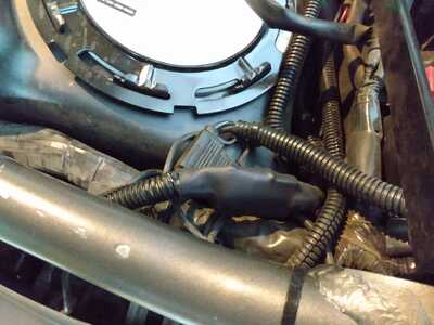

Long story...short....it was the incline connector of a flat 4 pin connector, where I had used too much dielectric grease, and whilst I did cover the entire connector, both halves, with a large heat shrink tube, that was not good enough to keep the over dielectric greased connector from coming apart ever so slightly, that it caused an Intermittent contact of the 4 pins in the connector.
Removed all heat shrink, took the two halves of the flat 4 pin connector apart, cleaned out the dielectric grease, reconnected both halves of the flat 4 pin connector, and this time used a tie-wrap to hold those two halves of the connector together...good and tight....then covered it all again with a new heat shrink tube.
Actually, very minor repair, very easy repair, and I did test the entire system, eyes on every inch of the wiring from Point A to Point B, to Point C, so no other problems.

Posts: 316
Sound like the connector was inferior, a proper connecter would snap together and have good connection and would not need a wire tie to hold it together.
Posted : June 30, 2025 6:17 am
Posts: 1876
Posted by: @2FLTC
You are 100% correct.  friday
Inferior connectors is the name of the game when supplied by Hannigan Motorsports. The wiring harness they use for supplying power up to, and back from the toggle switch for the ECC, which connects into the wiring harness they use for sending that electrical signal to the ECC on the sidecar, is a very simple flat - 4 pin connector, that SHOULD have the ability to snap together, with clips on the connector that have to be depressed to allow you disconnect this connector, however....in an ongoing effort to save $ 0.03 per connector, they supply ....as part of their wiring harness....a flat - 4 pin connector that does NOT have the clips to keep it snapped together.
These are generally used for flat - 4 pin trailer connections, and are quite cheap.
My original solution to this was to use the heat shrink tubing to hold the two halves of the connector together, but my error was in applying too much dielectric grease into the connector, which basically made a slip 'n slide, and over the course of 10,000+ miles, it finally slid apart just enough to cause an intermittent connection.
Fixed now, but this is the perfect example of how sidecar manufacturers in the US make foolish mistakes of trying to save $ 0.03 here and there, by using substandard parts, with total apathy as to what the buying customer may experience after it leaves their shop.
Only one sidecar company in the US would supply the 100% correct electrical connectors on every sidecar built that he assembles, and that is Mike Paull, at LBS-USA.
Every other sidecar manufacturer tries to save costs, by cutting corners, and it bites the paying customer in the end.
Posted : June 30, 2025 7:10 am
