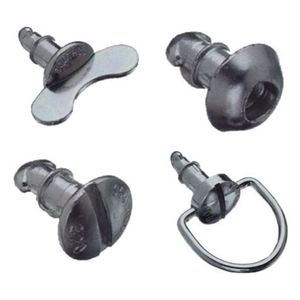

Not sure if this fits the bill but would a ¼ turn fastener dzus work?
Posted : May 20, 2025 5:16 pm
Steve Ives
(@none)
Posts: 333
Thanks Thane, i want to refit the original mounting lugs if i can.
