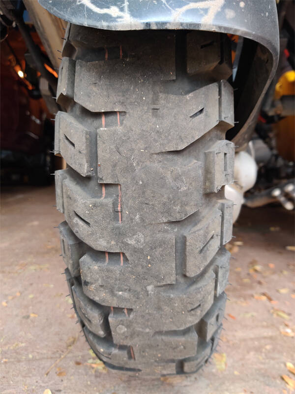

ATR K Wear
Replacement tire was a Motoz Adventure GPS.  Tire had 4,930 miles when replaced. Much smoother running with none of the harshness exhibited by the car tire.  Excellent for off road traction (mostly dry rocky, rutted trails).  Pretty marginal on dry pavement for traction.  Amazing during a down pour on the freeway.  Picture of tire at 4,435 miles.  Did another 500 miles before replacing.  Had to break both beads with substantial force to get them off the rim.  Based on the amount of force required I feel pretty comfortable it would have stayed in place during a sudden depressurization event.

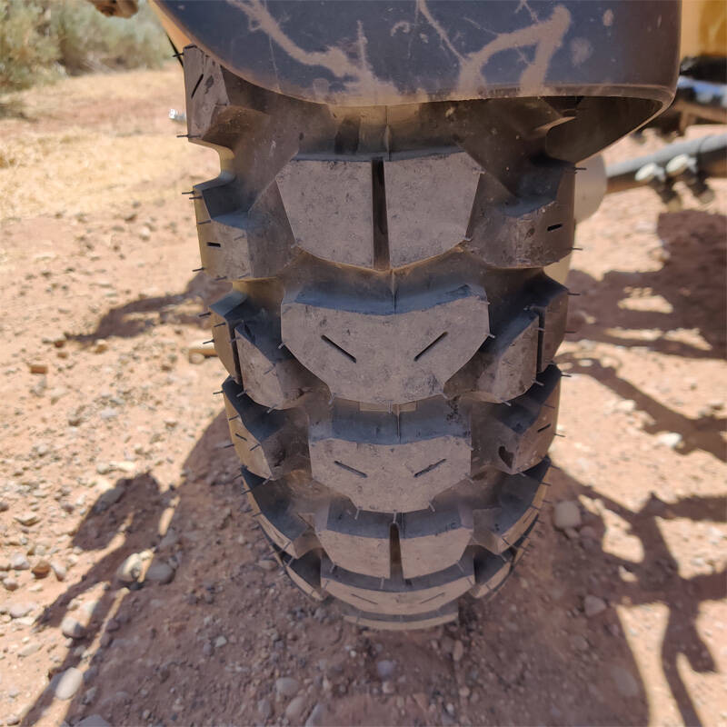

New tire is a Tusk 2Track.  Extremely off road focused, and not something I'd advise for any type of spirited street riding.  But pretty darned effective at ditch digging.  I'd put it up against a Ditch Witch for any shallow trenching work needed.  lol
Tusk 2Track Dirt Grip Width
