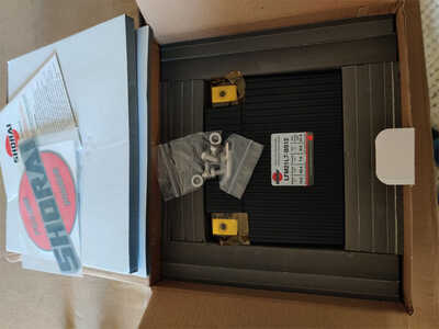

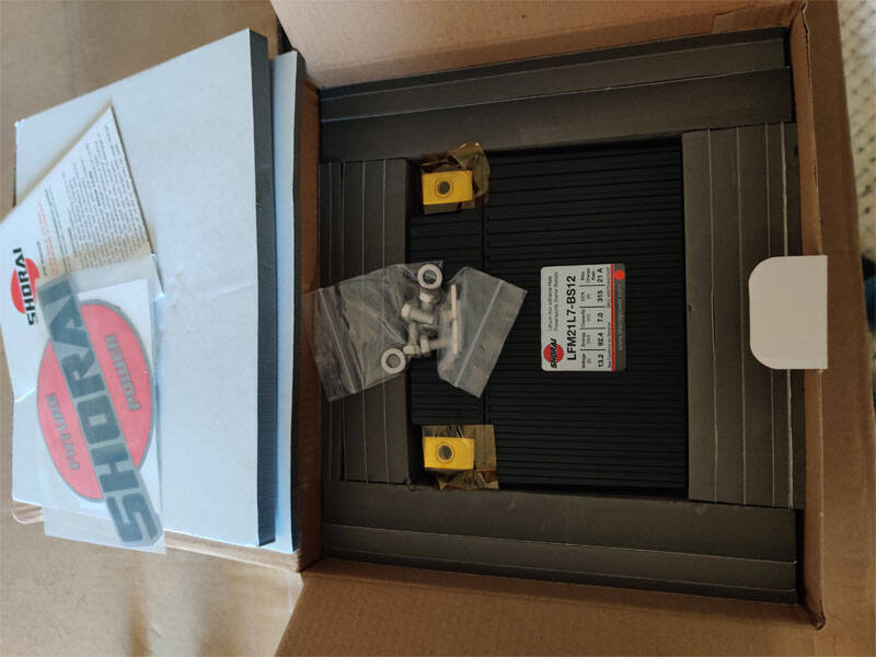

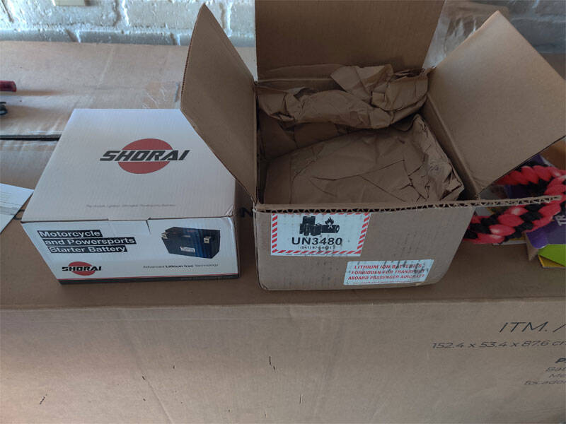

Shorai Battery showed up yesterday. Nicely packaged.  Compared with other name brands I've had experience with, this is impressive.
Double Boxed
Lots of adhesive backed foam panels surrounding the battery.  According to instructions the foam panels are to help fit the battery into different size battery boxes.  Came with a nice lug mounting kit.  Included great instructions on proper use and maintenance, along with the all important sticker pack.
Nice Packaging
BMS has an interface plug.  Haven't checked for available interface units yet.  Battery won't get installed until the engine swap is completed (probably sometime next month).  Plenty of time to look into what options, if any, are available for programming.
