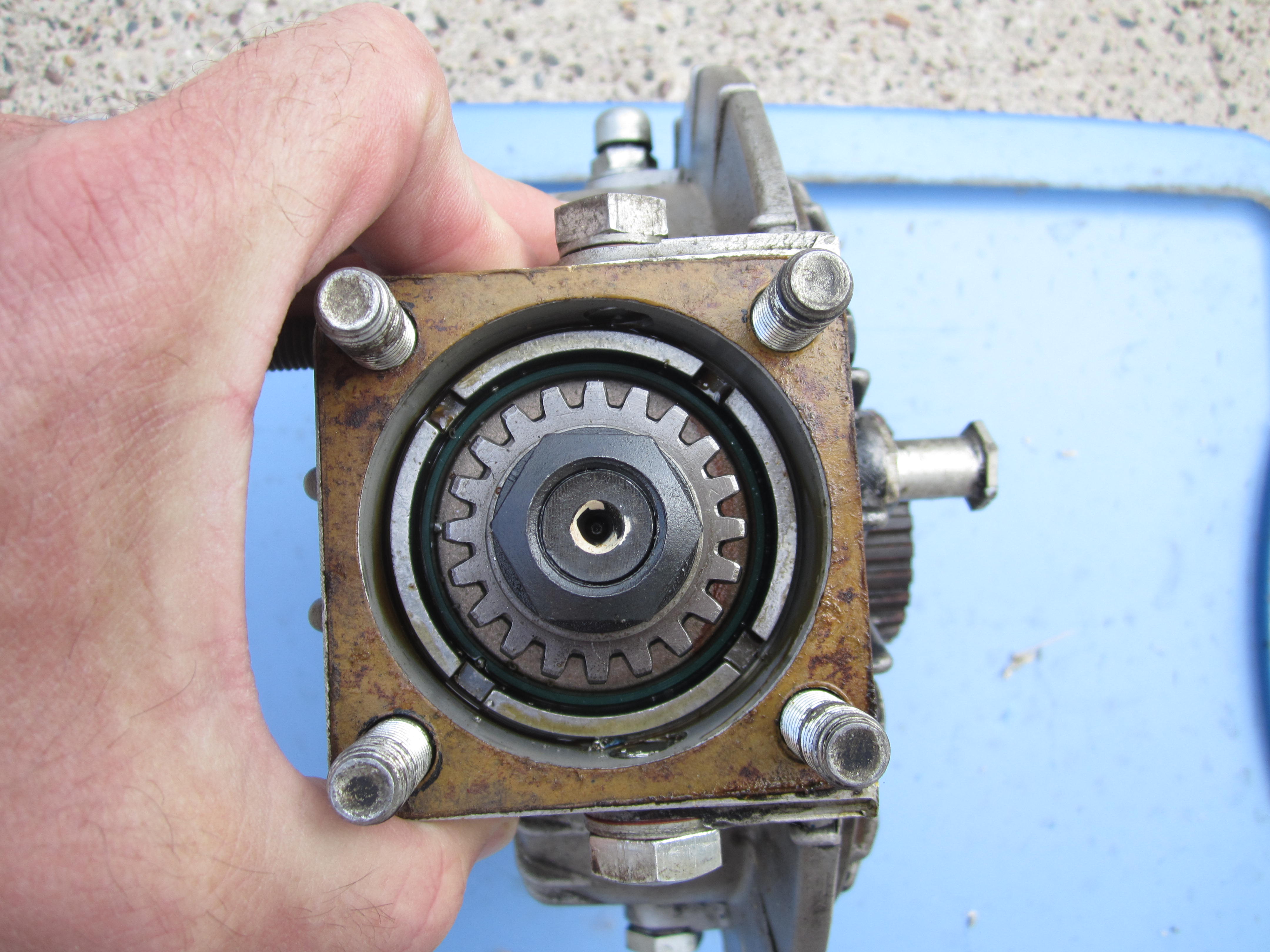

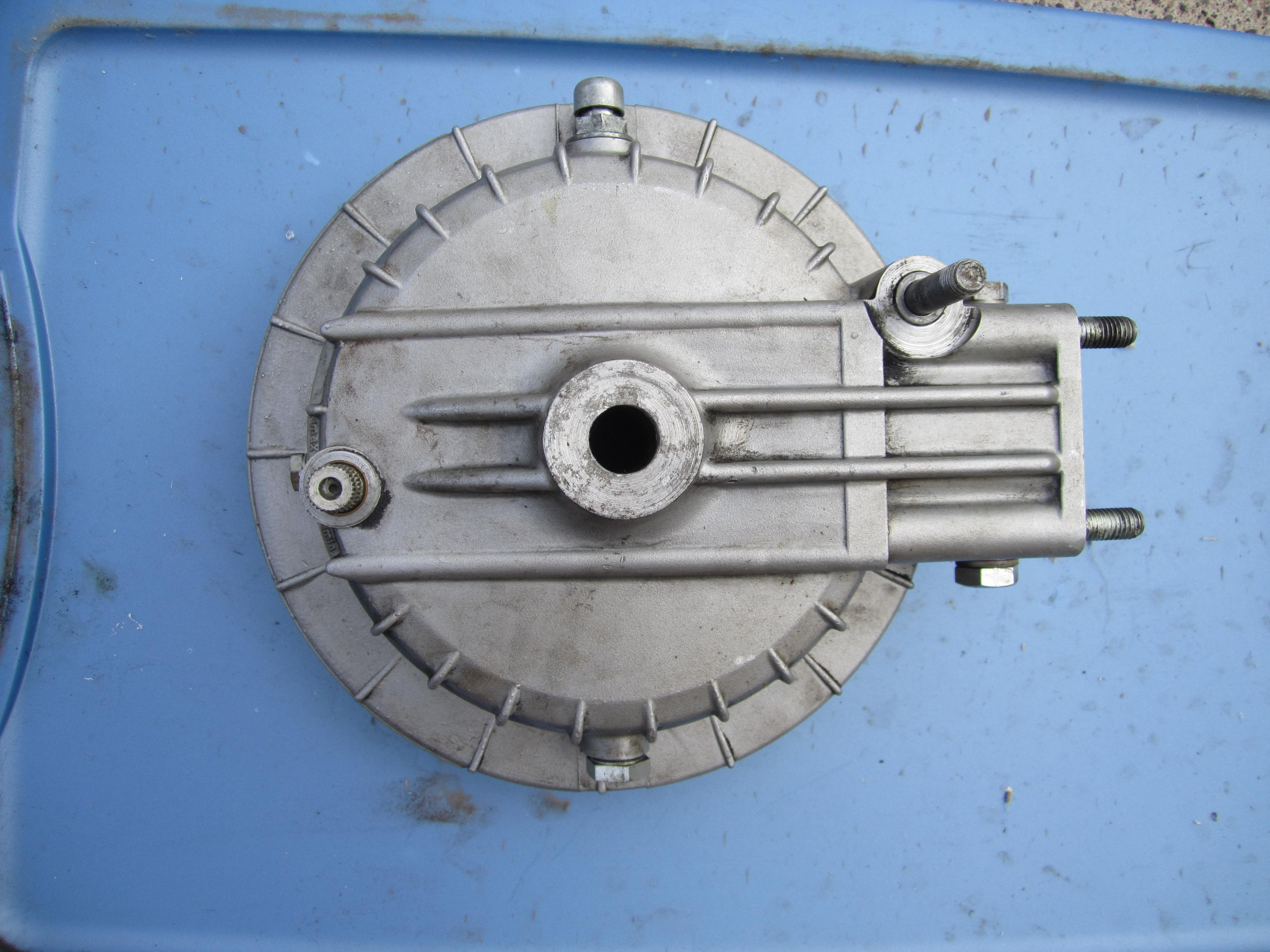

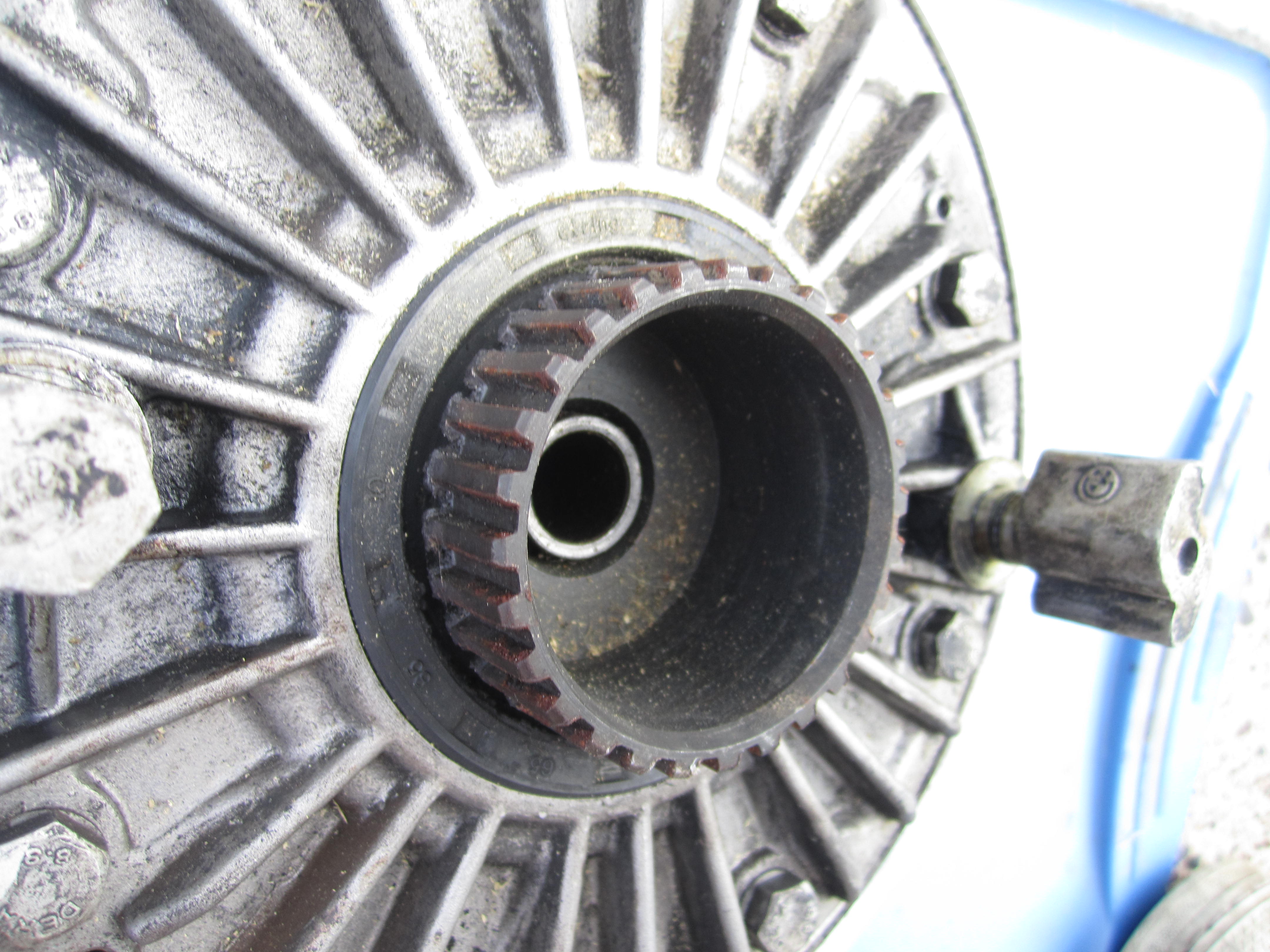

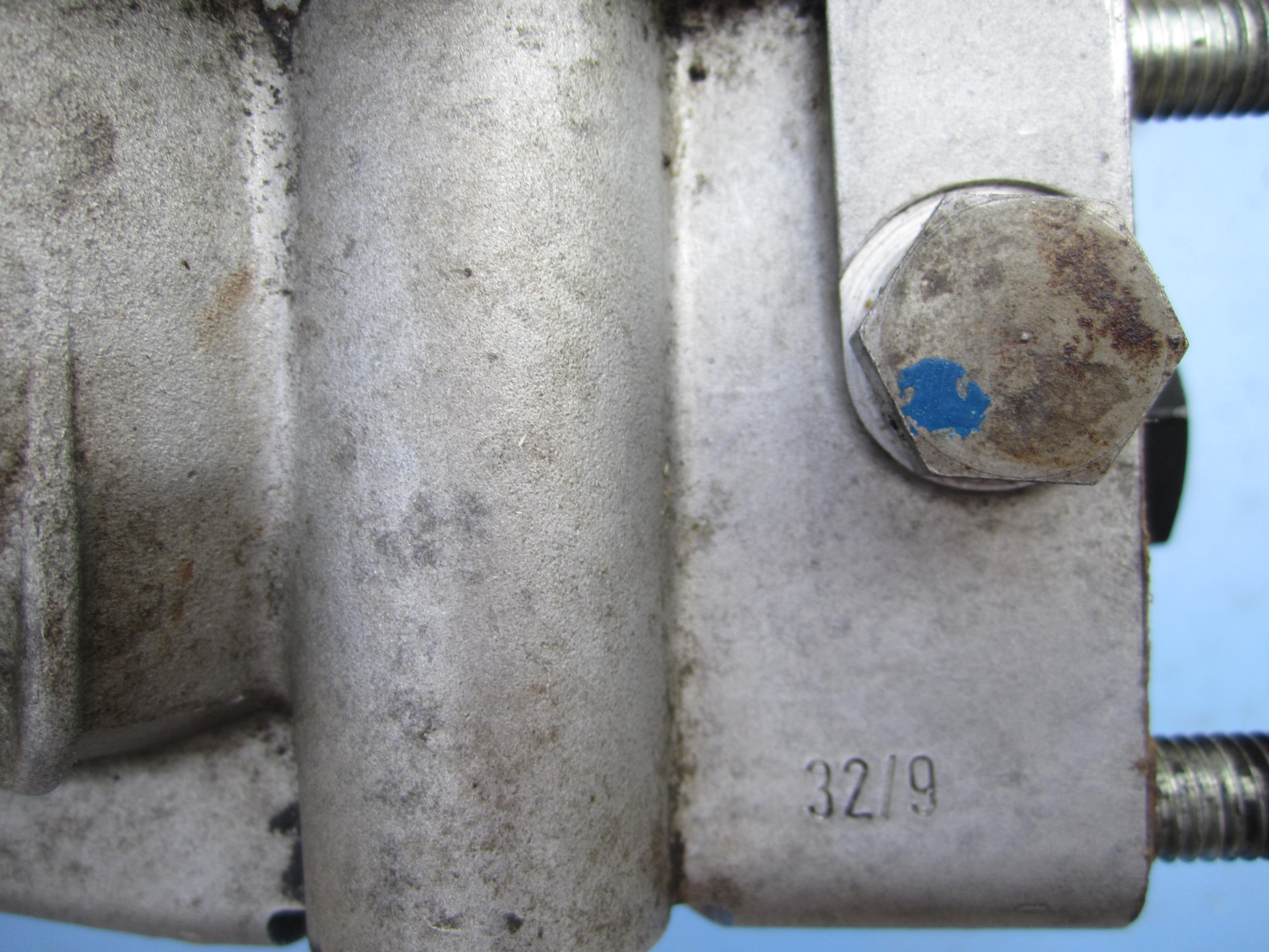

I've got a 32/9 that I will let go for $250 if your interested. It's in good shape with good splines.
