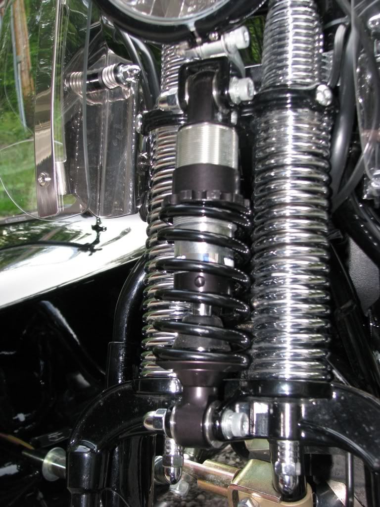

I didn't like the thought of changing the relationship between the rigid fork and the sprung fork. Like I said, I came up with what I thought was a good solution, and it worked pretty much perfectly. Since a picture is worth a thousand words...
Photobucket
I could have done a chrome spring, but I liked the contrast of the black one. Working out the spring and damping rates was a bit of a trick, and finding the right width damper body and spring was a bit of a challenge. But I got ahold of a smart engineer at a custom suspension company, and between the two of us we nailed it.
And to address what Jay said about the fender, I preserved the fender's relationship to the front end by extending the brake reaction link the same amount that I extended the rockers. Additionally, I took a measurement of the angle of the rockers on a stock Cross Bones with a 180 LB rider on it, and when I cut the rockers apart to lengthen them I modified the angle of the extension so I wouldn't change the amount of ground clearance my Cross Bones/Sidecar combo would have when riding down the road. The rockers and reaction link were lengthened a total of .900", all at the front end of the rocker so all front end component relationships would be preserved.
When you looked at the rig you wouldn't have known it had been modified unless you knew what you were looking for. But since you now know what I did, when you look at this photo you can see the amount of angle or curve built into the rockers when you compare the rigid fork mounting point at the rear of the rocker to the wheel mounting point at the front of the rocker:
Photobucket
When I was all done the bike really rode well, the steering was *somewhat* lighter, and the front suspension worked better than it did when it was a stock bike. Trail went from a stock 6.2" to 5.3". If I'd wanted the rig to steer like it had power steering the next step was going to be having the rigid fork re-raked, which would have reduced the trail perhaps 1.7" more. It's an expensive modification and I decided I really didn't want to go that far.
Lastly, keep in mind I am not suggesting anyone immediately start cutting the front end of their springer into pieces. When you make these kinds of modifications, obviously you assume all of the risk and better understand the pros and cons of your modifications!
Hope that helps!
