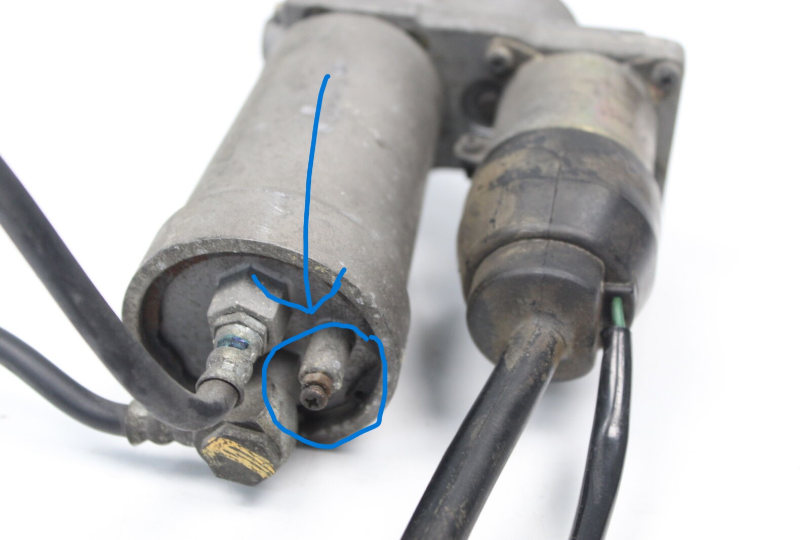

1. Is the output of the compressor adjustable, since it's limited? It has a screw on the back of it. I wonder if this is a pressure adjustment?

Short answer (or is that too late?), yes, your OEM air compressor on your '96 Wing can be used to pump UP the air shocks on your Bushtec trailer, but as stated, it will not HOLD the air pressure. You would need to install a check valve in line, to hold the pressure.
