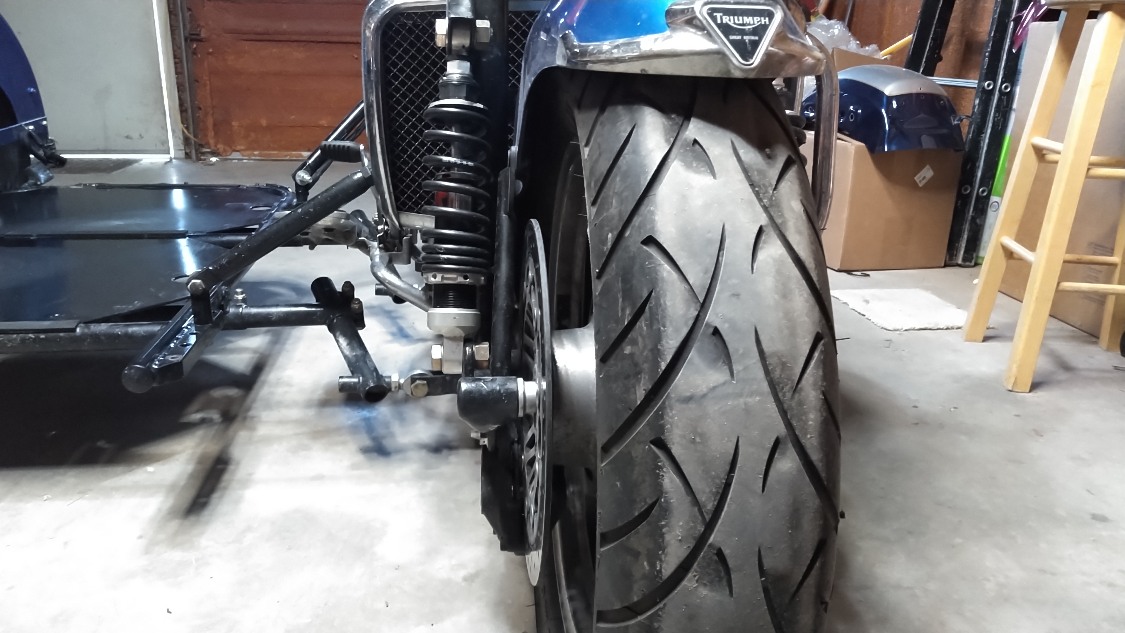

I don't know where you are looking but I can only get the 160/70 17 Michelin rear in a Commander II or a Commander III Cruiser not a Touring. I still cannot find the actual dimensions of the tire anywhere either and I really do not want to go any lower than I have to. I don't think the rear 16o/70 will be that much lower than the higher profile front 150/80 but I really would like to see some dimensions, every inch of ground clearance on this thing counts. I am actually looking at the Commander II and will probably go that route. I know I have this thing for the Metzelers since they were stock on the Rocket III, mainly though because I ran them for a lot of miles on the front of the R1150 GS rig all over and in all road conditions and they never failed to perform. Fear not, the front ME888 Metzeler that I have on the Rocket III currently has performed miserably along with the one that was on it when I bought the bike so I will not put another one on it.
Needs a picture, strictly to show the clearance on the front now not the crappy looking ME888.

Oh, my eyes.....my eyes.
I should  not have  clicked on  that  picture to  blow it up. I will  now  forever  have  the image of a wasted Metzeler tire burned  into my  retina.
Oh........the humanity  !

You are not supposed to look at that beautiful Metzler tire, look at how much room there is in there for a bigger tire.

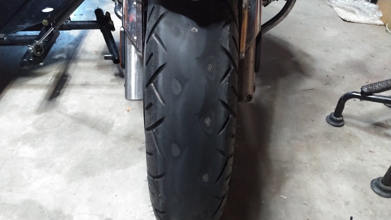

That is one seriously messed up tire.  No wonder you're looking for a different solution.  Is that 888 in the picture a 150/80 or a 160/70?

You think that one is messed up you should see the one before it. A Metzeler ME888 and this was with the stock front end. I rode the last 300 or so miles from Utah to home looking like that. Actually I think Richfield, Utah is where I noticed Spat eyeballing it and finally noticed it was a little worn. You would think I would have changed to a different brand then.
