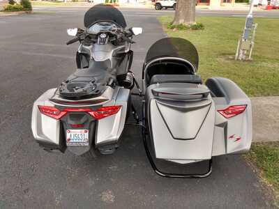

And Chris...I  have  the exact same  bike as the  one  you  plan on buying,  same color, same level of  OEM accessories,  but mine is a  2015, not a '16.
This is the  one I  bought  this last Summer  from  Hannigan's,  with a brand new  Hannigan  GTL sidecar,  and now that I have  done  all the  prep work,  it will be  shipped to  Heidelberg,  Germany  early  next year.

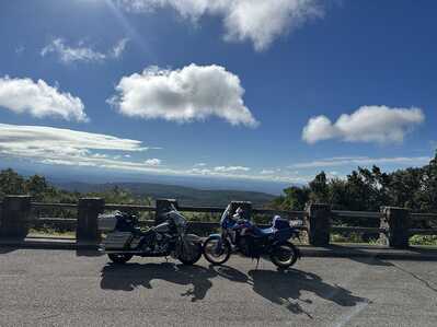

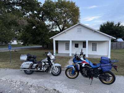

See a couple photos of my beautiful Africa Twin (that will be sold once I acquire the Goldwing). The picture in front of the white house was taken just last weekend (that is Mickey Mantle's childhood home)
IMG 9618
IMG 9471
Posted : October 1, 2024 8:44 am

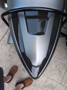

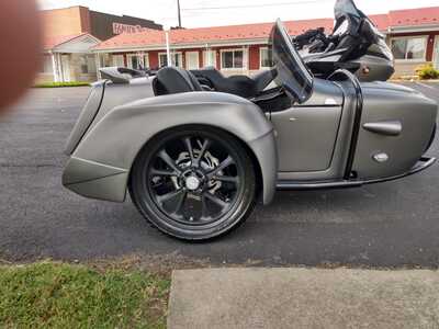

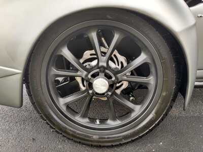

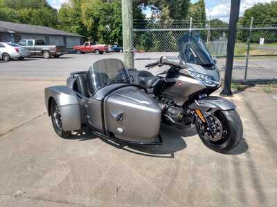

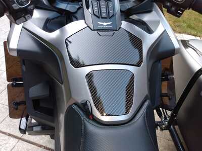

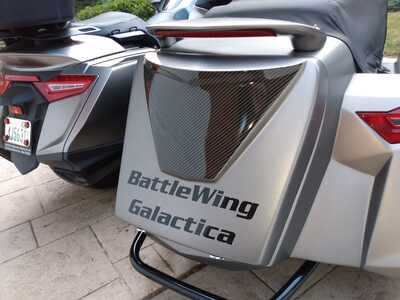

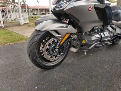

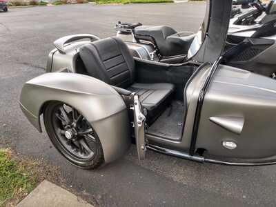

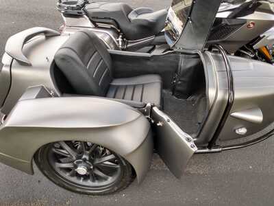

And, Chris, I also happen to own THEE Honda Goldwing that you really wanted in the first place...a '19 Wing with the DCT trans. It is my 4th Honda with the DCT trans, and I have had ZERO problems with any of the DCT transmissions. This bike is my USA sidecar rig, with a Hannigan Dream sidecar attached to it.
Hannigan Finished Build 071
Hannigan Finished Build 066
Hannigan Finished Build 067
Hannigan Finished Build 070
Hannigan Finished Build 064
Hannigan Finished Build 062
Hannigan Finished Build 059
Carbon Fiber Wrap 012
Carbon Fiber Wrap 017
Carbon Fiber Wrap 008
Posted : October 1, 2024 8:59 am
