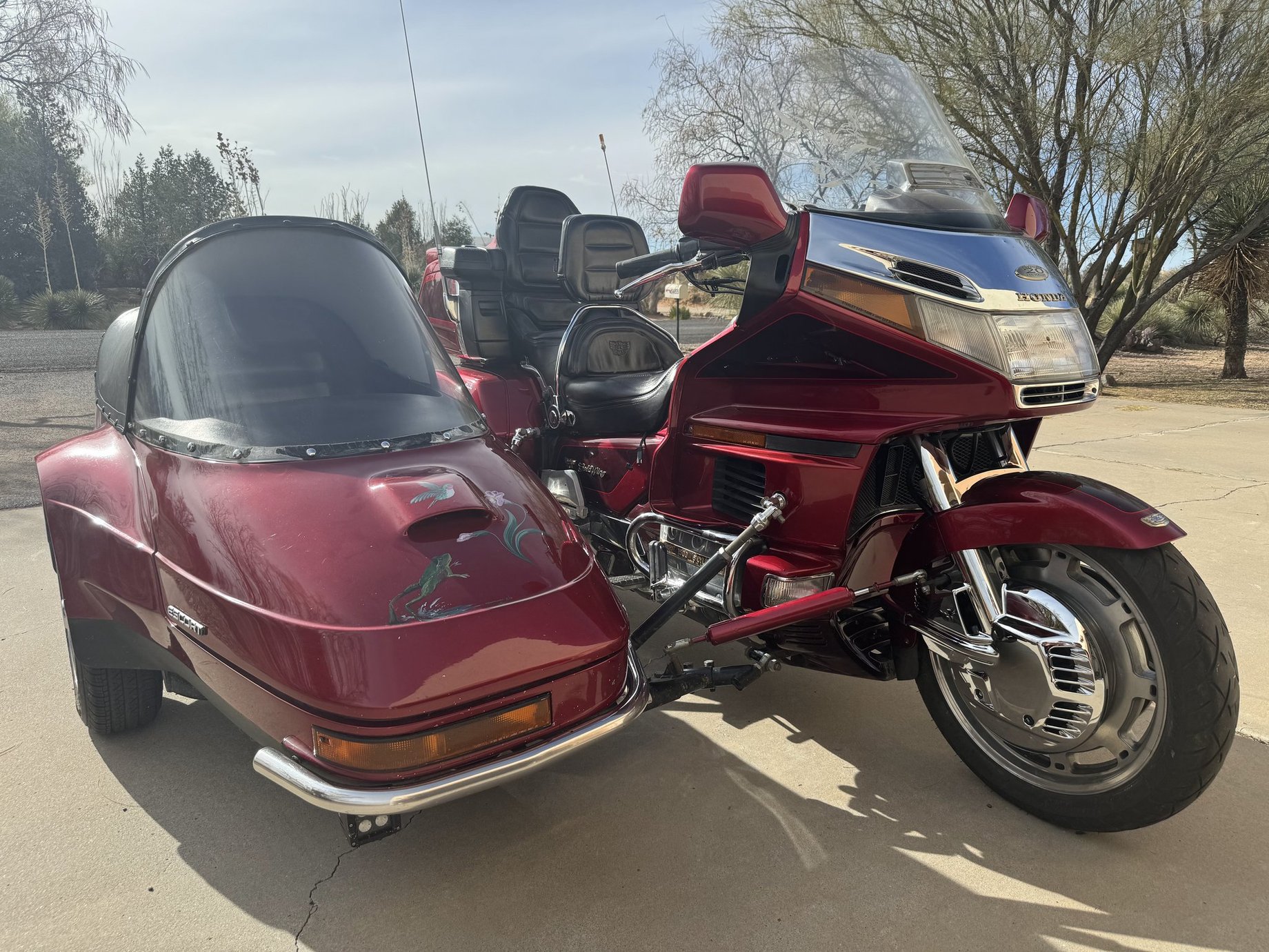

If i need to unbolt and slide the angled front upper black bar out of the way to remove the fairing part it passes through is it safe to do so?

Steve, assuming (which I do NOT like assuming) that you will have the rig stationary...not going down the road at 60 mph....and that you plan to reattach that same mount back to the bike....there is no reason you cannot detach that front upper mount from the bike, then remove said right side fairing piece.
Your question is only unusual in the context that it is unusual for a Honda Goldwing sidecar owner to necessitate removing any parts, anywhere, on their motorcycle to facilitate service or repair, as this is usually done on BMW bikes, as they are constantly in need of service/repair/adjustment/replacement.
(please, all you BMW dudes and dudettes, you can now throw your un-eaten Donut Holes at me...a man has to eat....eh?) 😉
But seriously Steve, just carefully MARK that mounting rod....with either tape, or white-out, or something similar, so that when it is detached from the bike, you can reattach it to the exact same position...thread count....as it was previously.

Steve--When I read Post #1 and saw you asking about the "angled front upper black bar" I asked myself what the hell is he talking about?  So I opened your pics in a new tab and zoomed in to see more clearly.  Ahh!  I then remembered that you are fairly new to this game.
That "bar" is actually the front upper strut.  Most rigs have two upper struts and two lower struts.  Occasionally you'll see a rig with 3 struts or 5 struts, but 4 is the norm.  In any event, the word is "strut".
Also, to add to what FM said, I don't know if you live someplace dry or rainy, but folks up here in the Pacific NorthWET mount their upper struts with the solid tube end attached to the bike and the threaded rod end attached to the car.  In other words, flip that strut upside down from the way you have it now.  The reason?  Rain.  With gravity's help, rain seeps down the threads into the strut and rusts the threads inside the strut.
Of course, if the rod ends and bolt dimensions are different at the top and the bottom then you're stuck with leaving your strut the way it is.  For those folks who might stumble on this thread sometime in the future, if you have a strut that MUST be mounted with the threaded rod upwards, unscrew the jam nut, degrease the threads, apply some blue threadlock, then tighten the jam nut.  The blue threadlock will act as a waterproof barrier to keep the water from seeping down into the strut innards.

Thanks peeps great advice, flipping the strut makes sense. Everything looks pretty shiny and new at the top of the strut but blue thread lock will be investigated. Fortunately my outfit has a garage all to itself, it sure is a blessing for my mobility if i have to tinker. Even spare old carpet to kneel on =)
