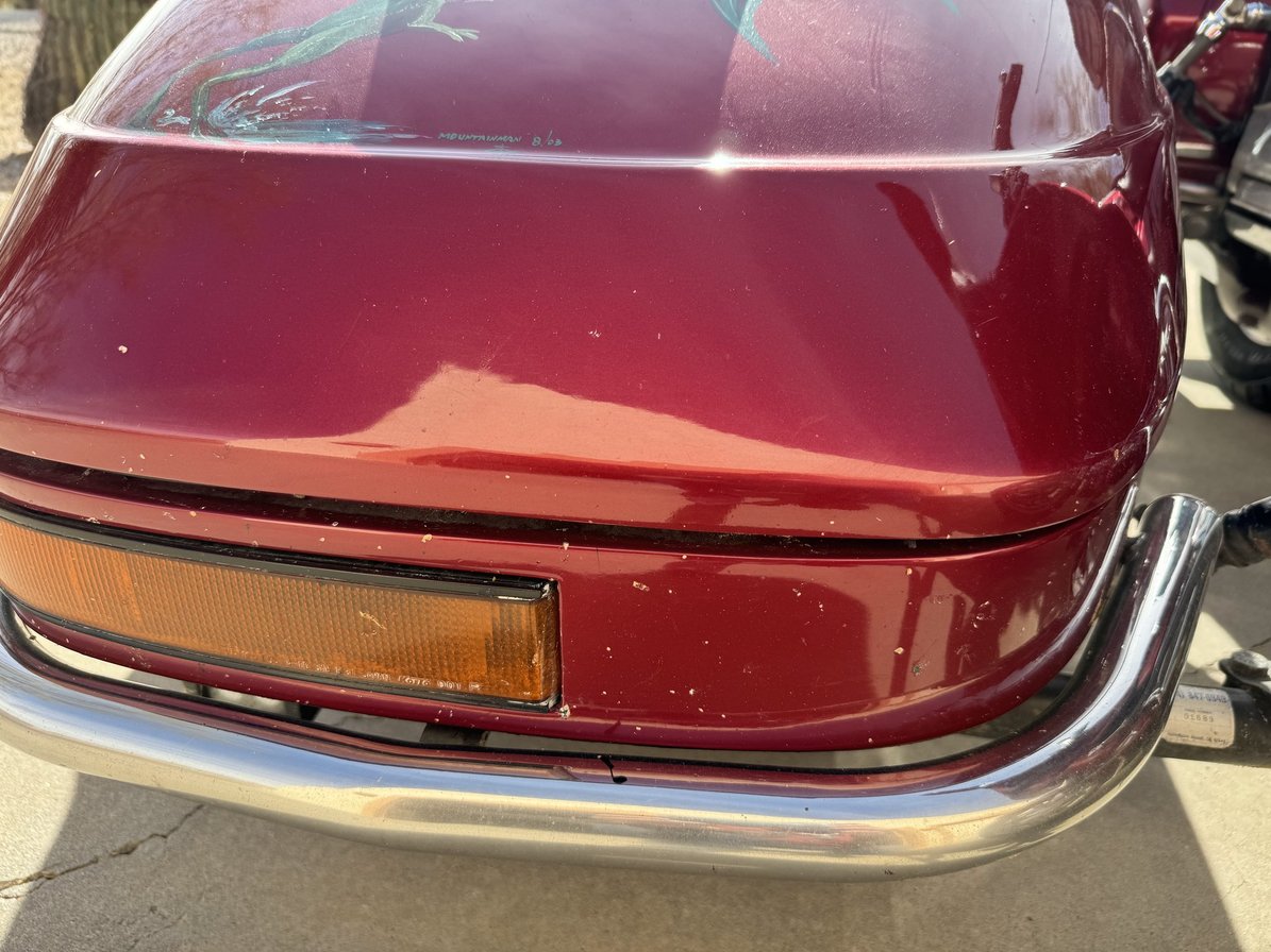

I have a Champion Escort sidecar on my Wing and its a mess where the screen joins the bodywork. Whats the best way to fix it?

you can replace the thin rubber strip that goes between the cars body and the windshield, just be careful when removing it not to force it. clean everything up good and install the new rubber and reinstall the windshield, again being careful not to overtighten the screws that hold it on.

Ok great. Is this rubber strip a manufacturer part, and of course where can i get one =) I think i will get new screws etc as well.
I think there is a bit of a twist somewhere as there is a gap on the front corner, a bit windy with the top up i suspect

Miles the mess is between the windscreen and the body, that is why i put the picture in for reference. Yes it still seals etc.

Also, you might be able to just remove the shield, clean everything up good and reuse the rubber strip, if it's not torn or damaged. when I repainted my sidecar I was able to clean everything up and reuse the strip. As for getting a new one I would start with somewhere like Texas sidecars, Call Kent I'm sure he can help you with that and the screws, but unless the screws are damaged I would just reuse them. I did however replace ALL my little chrome buttons and clips that go under them

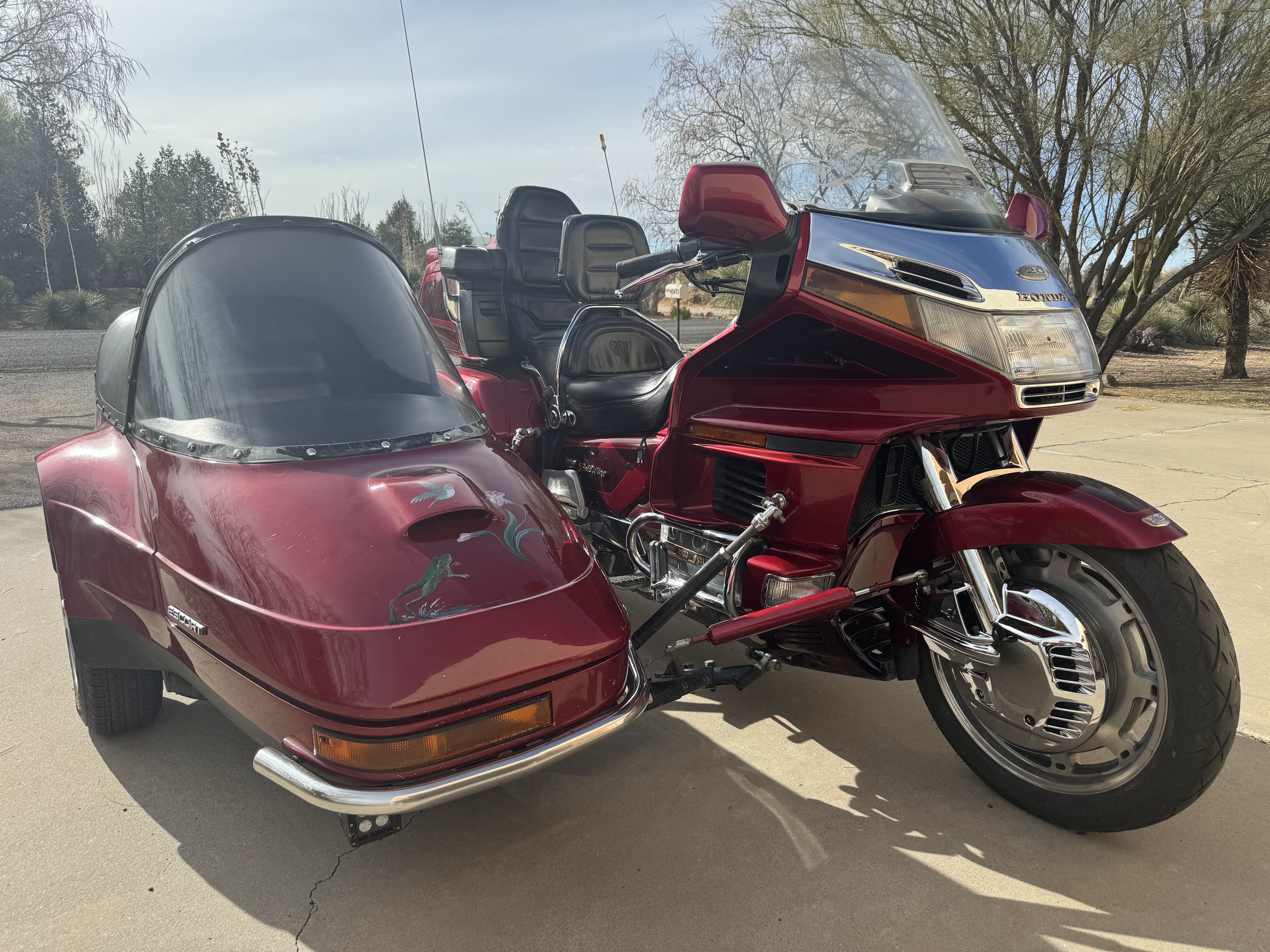

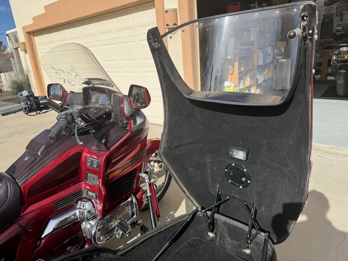

Hay Guys an Gals
Just been messing around trying to get my wonky sidecar top half to line up; Bit like me i guess lop sided =)
Oiled catches, made sure rubber is fitted properly. Tried removing gas struts to take any pressure off.
I am assuming it must be the hinge assenbly?
