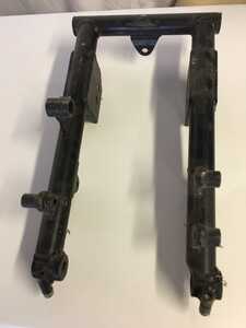

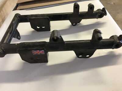

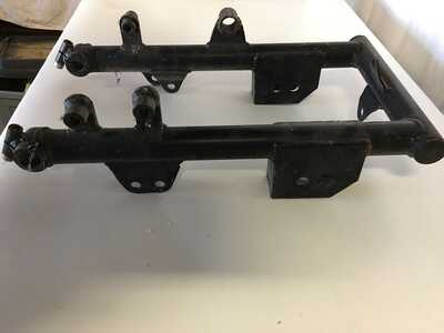

Don't believe it has ever been used.  May fit Honda CX 500/650.  Happy to measure it.  Happy to ship it on your dime.  $50.  bobdarden1949@gmail.com.

Robert,  this Unit Leading Link "swingarm" can be used on 1,000 different motorcycles front ends, as it is only dependent on the  front wheel/Tyre being used to fit between the arms of the  "swingarm".....and the wheel w/axle fitting in the "swingarm ".
The point is....it is the upper  arms of a Leading Link that fit into the  motorcycle's triple trees that dictate which bikes it can be used on....Moreso than the  "swingarm ".

It would be good to post the width of the swing arm and the axle diameter, but for my BMW k75, I think the mount points for the brake caliper(s)
would also have to be modified.
