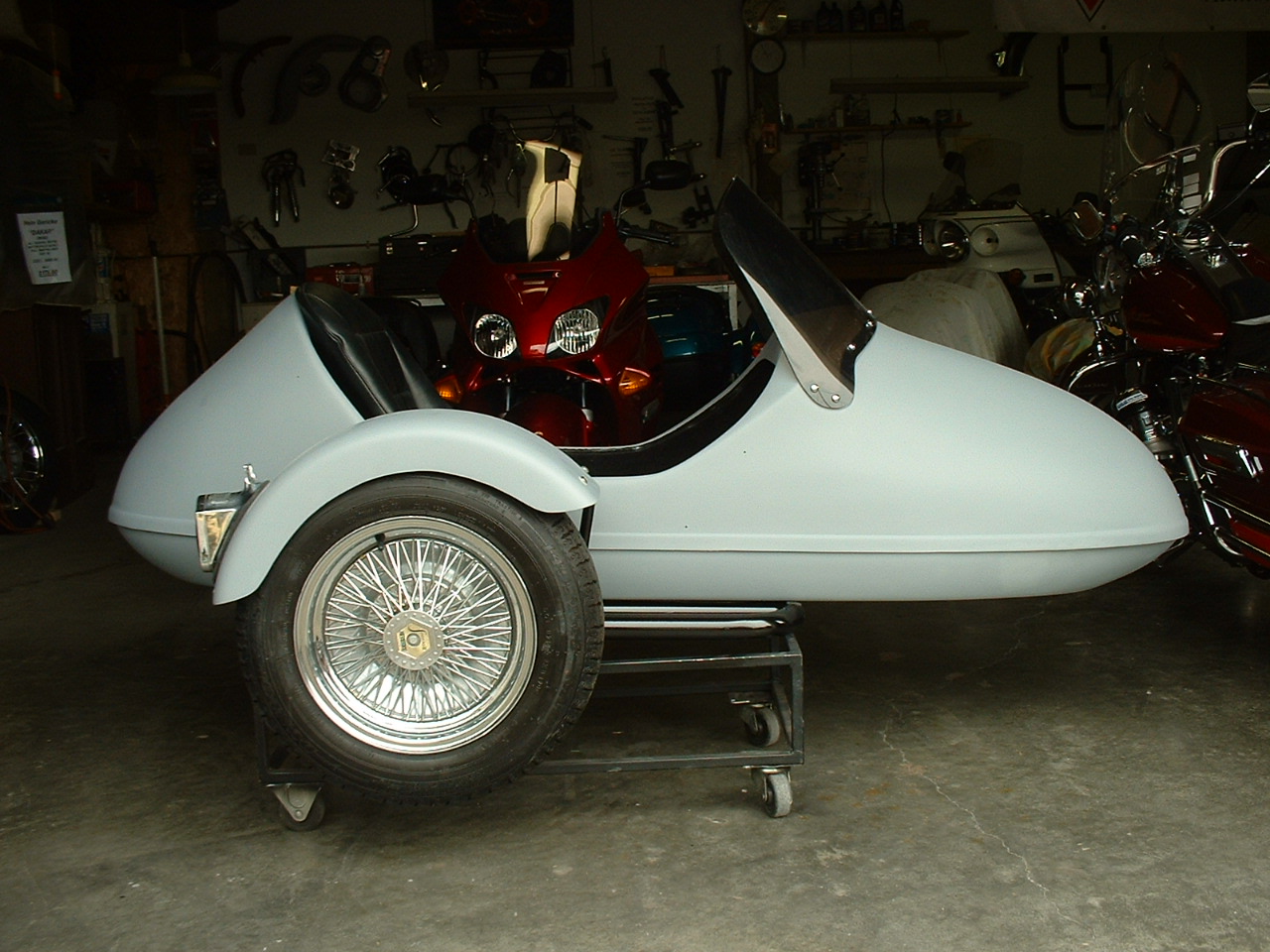

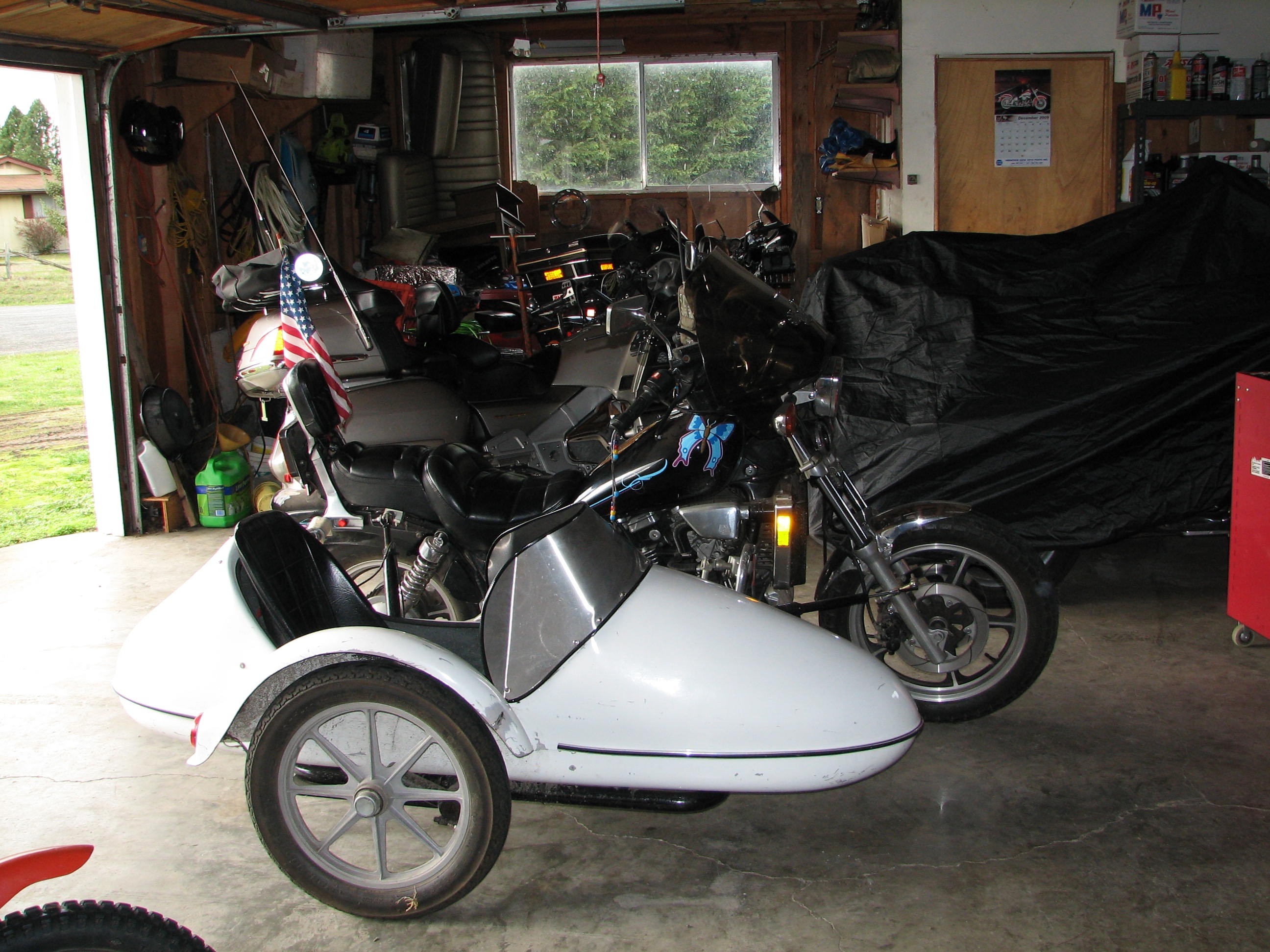

No such animal as a Companion II. The Companion is a roadster type sidecar, the Friendship II has integrated fender and opens for passenger entry (examples attached).
