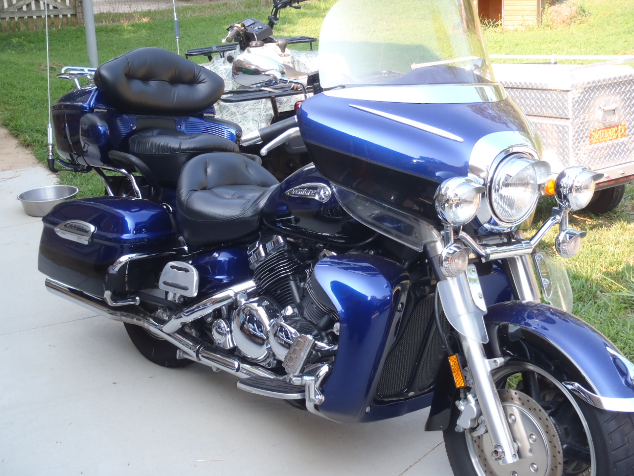

I have a 2007 Yamaha Royal Star Venture. New in 2007. It's got > 40K miles on it. So I decided it's now time to play.

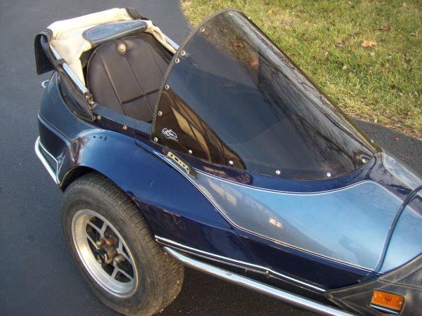

February 19th, I picked up a California Sidecar Friendship II. Needs some minor cosmetic touch-ups, possibly some other minor things, but mostly it's in pretty good shape (no mounts though).
So the 2-wheeler will now merge with the 1-wheeler (ie sidecar) and the two will become one.

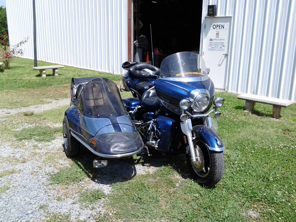

Delivered the Bike & Sidecar to Doug McCracken today at A Wing and a Chair ( http://www.awingandachair.com/). Spent some time there. I am thoroughly impressed with Doug. And so the transformation begins ...
Posted : April 10, 2013 5:29 pm
Mine is done. Took delivery Friday May 31st, 2013. Rode about 40-miles before I picked up my two boys and we went for a ride. The dynamics of the 3-points of surface contact is way different than the M/C 2-points of surface contact.
The first 20 miles or so was very hard for me. But before making the commitment, I researched, read, read, and read some more. So I was mentally prepared for the change.
I had Doug McCracken of Monroe NC do the install. He is on the web at "A Wing and a Chair". He did a great job as the sidecar tracks straight and true. On the freeway I can run with the bike's cruise control on and maintain the vehicle one handed.
Posted : June 1, 2013 4:16 pm
