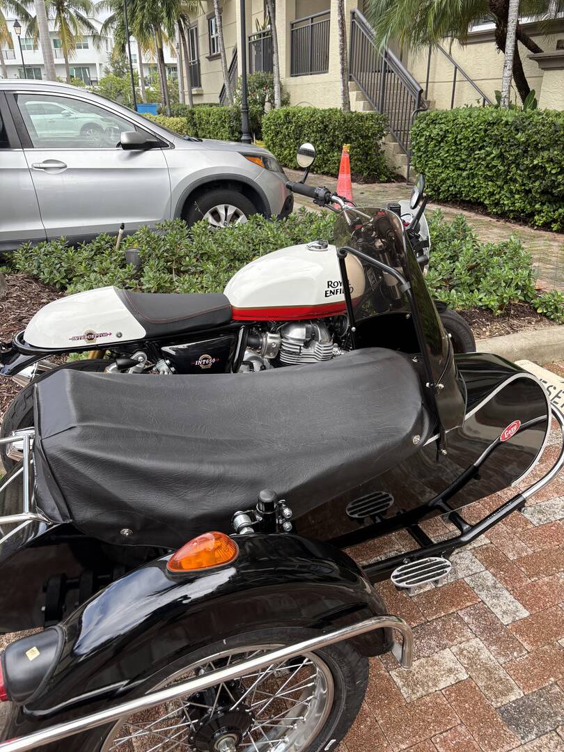

HOLY COW !!! everyone - thanks for telling me NOT to drive it down from Denver, NC to Fort Lauderdale. I would have been dead for sure. I had the maiden ride today.. of maybe (if that) 1 hour.. left/right constant turns on really small streets with a max speed of 30mph.
This is NOT a bike.. It's not a car either.. I don't know what this thing is !!!! The hack was fighting me the WHOLE time on turns.. Has a mind of its own.. I wanted to practice tons of turns and bends, so I did that.. in fort lauderdale tiny neighborhoods.. almost no traffic. I even hit a trash can once.. In fact, it was easier to ride in traffic (straight line) that it was in those small, traffic-less streets.
Jesus christ !! I really hope I don't miss a regular bike too much.. as today I was really missing riding a regular MB .. so easy.. just go ... no fighting involved..
Shew!!!

Driving a sidecar is definitely it's own thing.  That wrote, it shouldn't be too difficult. First thing I'd do is check/set the tire pressures.  Especially the front tire of the bike.  Start at 32 psi in that tire, and the sidecar tire.  See if that helps. If not go up a few psi on the front bike tire, try again.  If that doesn't help, go down a couple psi.  Rear tire on the bike isn't as sensitive.  maybe start around 35-36 psi.
If none of that makes a difference, might take it to a sidecar specific shop and have them check the setup.  Test drive it for you, to ensure the rig is setup best as possible.  Once you know the rig is setup to the best it can be, then you'll be able to tell if driving a sidecar is what you really want to do.

Ronnie, look at a couple of the items in the library linked below.  There is a general rule of thumb about how far forward of the rear wheel the sidecar wheel is set (lead).  This will have a significant effect on handling.  Next is lean of the bike towards or away from the car.  Final gross setting is the toe of the car towards the bike.  The balance of these three primary settings will  make the overall handling “tolerable”.  After that it’s a matter of fine tuning the settings to get the best balance of “straight” and not-surprising turns.
You should be able to check two of the major settings yourself based on advice from the book.  Definitely get it to a sidecar specialist nearby.
Very glad you didn’t ride it home or get killed whilst wrestling the anaconda!

Ronnie, we are all happy that you got your new-to-you sidecar rig delivered to you,  and you now have 31.41 miles of practice.
I can see 3 things that are adversely affecting your sidecar driving experience.
#1...the sidecar wheel is not forward enough....it should be 8" to 12" ahead of the rear wheel of the motorcycle.
#2...fold down the windshield of the sidecar.  It's unnecessary wind drag right now,  unnecessary vision blockage to your right.
#3...the sidecar color doesn't match the motorcycle,  so....your furry friends will be hesitant to ride with you.

@thane-lewis Holy cow. That’s pretty technical stuff. I can try, but I doubt I’ll be able to figure it out. I’m one of those that opens the bonnet of a modern car and doesn’t know what he’s looking at. Things were so simple with me dad’s old FIAT.. clean, basic engineering..

@miles-ladue good point. I didn’t note how many miles I drove today. I was just concentrating on being able to turn left and right constantly, going through twists, doing U turns (that’s when I knocked over someone’s trash bin.. people leave it outside their homes, on the road) etc.. Looking forward to spending time in Colorado or western North Carolina next year.. Need to practice a TON before I let my kids in the sidecar .. much less taking them on the mountains..
I can definitely measure the distance… however I had no idea that the windshield folds down. How cool!! I’ll try that as well.

Ronnie, before you spend (I didn't say waste) time practicing for hours each day, it will save you a lot of time and grief if you can make sure....really sure....that the sidecar is attached to the bike correctly, and aligned correctly, with all the mystical math that was told to you by Thane @thane-lewis.
Those things are vastly important, because if you are trying to learn your sidecar today, with things out of sync, you could be learning bad habits.
One of the things that YOU can do, in the list of items stated by Thane @thane-lewis , is check your tire pressures, and the numbers given to you previously should be fine to begin with.
Nothing worse than fighting a wobble, or bad steering issue, only to find that IF ONLY you had inflated that front tire to the correct psi....then your world be be much easier.

The windshield cannot be folded (or at least I couldn't figure it out).
"the sidecar wheel is not forward enough....it should be 8" to 12" ahead of the rear wheel of the motorcycle." - The distance seems to be 6-7 inches. I used a tape measure and sorta eyeballed it.
I could not figure out a lean by eyeballing it. I will figure out the tire pressures today at a gas pump since I don't have a tire pressure guage.

Ronnie, the tire pressure gauges attached to the gas station air hoses are not very accurate, and could be off my 4+ psi.
A tire pressure gauge is very inexpensive, and almost every gas station convenience store has them for sale, or any hardware store...for less than 10 bucks. Get a decent one, and keep it....forever.
You can buy a pack of 3 digital air pressure gauges on Amazon, for like 10 bucks... so that you have one in every vehicle.
Use your alleged smart phone...they are only clever, not really smart....and use a app for a LEVEL, then place the phone against a straight vertical plane on the bike. whether it is the side of the tire, or the frame of the bike...something to check and see if your bike is perfectly vertical, or at 90 degrees to the ground surface. Technically, you would want the bike to be slightly leaned, meaning 88 degrees to 89 degrees , so it is leaning OUT...away from the sidecar, rather than perfectly 90 degrees.
IF the bike is perfectly 90 degrees in relation to the ground surface, then check the same thing on the sidecar, find a place where you can measure the vertical plane, to see if the sidecar tire, or frame, is at 90 degrees in relation to the ground surface, or...if it is 88 to 89 degrees leaned OUT...away from the bike.
LOOK at your Cozy sidecar windshield again, there must be a way to either lean it backwards, or lean it forwards, so that it is not a barn door in the wind. If nothing else, remove it. Those teeny weeny furry friends don't need that much of a barn door to block the wind for them.

@miles-ladue I have learnt a few things today.
  1. Today's ride made me realize that the "wobble" might be me "feeling the road". As I rode around 20-50 mph for 2 hours, I kept an eye on the road surface conditions. Even though the roads looked good and not covered with potholes, I could feel the road more than I feel it on a motorcycle. So, maybe this whole "wobble" thing is just "the road". Time will tell.
  2. For my right side mounted sidecar, I feel that I need to be firm with my right hand on the hack to not let it wander off.. Is that the correct feeling? It seemed that it always needed a firm hand (unlike a horse or motorcycle). Is that correct?
  3. I felt that I really need to be well into a curve before speeding up - unlike on a bike where I could speed up a tad earlier. Am I doing this correctly?
  4. I can easily remove the windshield from the sidecar. I thought it was for their protection - should I take them off?
  5. I am planning on buying something called a "50 lb sand bag" and putting it on the sidecar floor permanently since my dogs total 70 lbs (two of them). Is this advisable? At the moment I just have 25/30 lb gym weights in the sidecar.
  6. The tire pressures were OK (I purchased the ONLY available pressure gauge option at a gas station at $3).  The "lean" seemed to be 1 degree but I cannot tell for sure as sometimes it showed to be 0 (both on the sidecar and bike). The sidecar wheel and bike wheel have a difference of 6-7 inches. The set up might be OK. I might be the one that sucks since I am a newbie to motorcycle world in the first place.
Thank you all for your help thus far.
