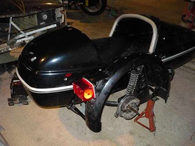

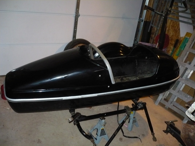

My name is Martin and I own a sidecar. New here picked up my car Sat. at auction. It's a 1980 Velorex 562.
It needs some work,
Don't be shy tell me what ya think.
https://www.sidecar.com/mbbs22/photos/show-album.asp?albumid=541&photoid=4737

You have a Velorex 562E model. Series 562/03. This is the econony model sold new at $200.00 less than the 562 Standard. Basic body and chassis are identical between the two models. Weight is 154#. This sidecar is not safely attached to a heavy touring motorcycle.
This sidecar has a 15mm axle and very light suspension as it was designed for use with a 350cc Jawa or 350cc MZ motorcycle. 300# bikes.
If mounted to a larger midddleweight bike it should have upgraded suspension to support the heavier bike without bottoming out.
Some parts are still available for this model. We have Bike frame mounts, convertible tops with bows and bolt on suspension upgrades with wheel & tire here and many other parts warehoused. Windshields, tonneau covers, brake parts and many other pieces. The seats are not available but we have sources for replacement ones for a reasonable price.

My plan is to mount it to one of my 85 700cc (Shadow or Virago)
