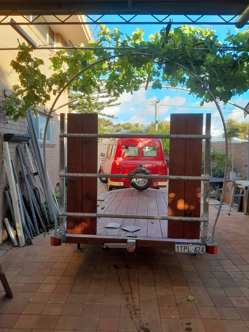

While in triple tree limbo I started work on the trailer canopy.  Theory being the Fiat can have it's own mobile garage.
Be better for the timber deck as well.
It would make for a handy camper if we go that way.
Could even carry a sidecar or two.
It's just on 2m wide inside.   Maybe a bit taller than 1st planned but the wheelbase is 8ft wide so stable.

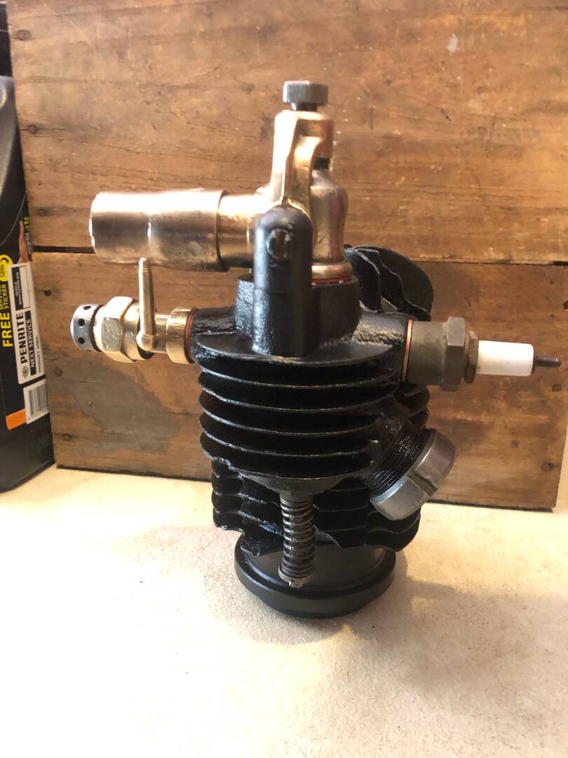

1903 Brown engine barrel etc

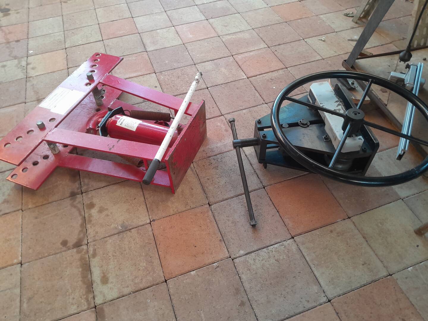

. And my roller and bender.

Bruce, allow me to plant a seed:
On the trailer, how about "removable sides and removable top"
Build each side as a removable panel, same thing for the top, a removable panel, that can be bolted into place with a simple 4 to 8 bolts, whereas the receiving nuts are actually welded into place in the permanent framework on the trailer.
Build a permanent framework onto the trailer, that will always be there, but have panels for both sides and the top that can be easily unbolted, and removed, so the trailer serves multiple purposes.
Posted : November 21, 2024 8:25 am
Posts: 738
Planting seeds is good Miles.
Be hard to make that one grow this time.
 The trailer currently weighs 450kg empty with a gross of 1400kg.
Leaves 950kg payload.
The Fiat weighs 750kg though the manual says it should only be 650kg.
Leaves 200kg.
Add in a spare wheel etc leaves 150kg.
The aluminium frame and sheeting  will end up being a bit over 100kg, say 110 /115.
What with offcuts from the totally cool unique design and shape.
I may be able to include a back door as well as the ramp.
Making a rigid ultra light structure that won't get ripped off by a passing road train requires structural integrity.
Any spare weight capacity is likely to get taken up with insulation on the walls.
A minor upgrade capacity wise could possible come through a wheel upgrade from 13" to 14".
Marginal, expensive and unlikely short term.
At least 25mm Ali tube roll easily by hand though still trying to think how I can fit a motor to my roller.
Written somewhere between 3-30 am and 5.
Might sleep in now.
Posted : November 21, 2024 3:09 pm

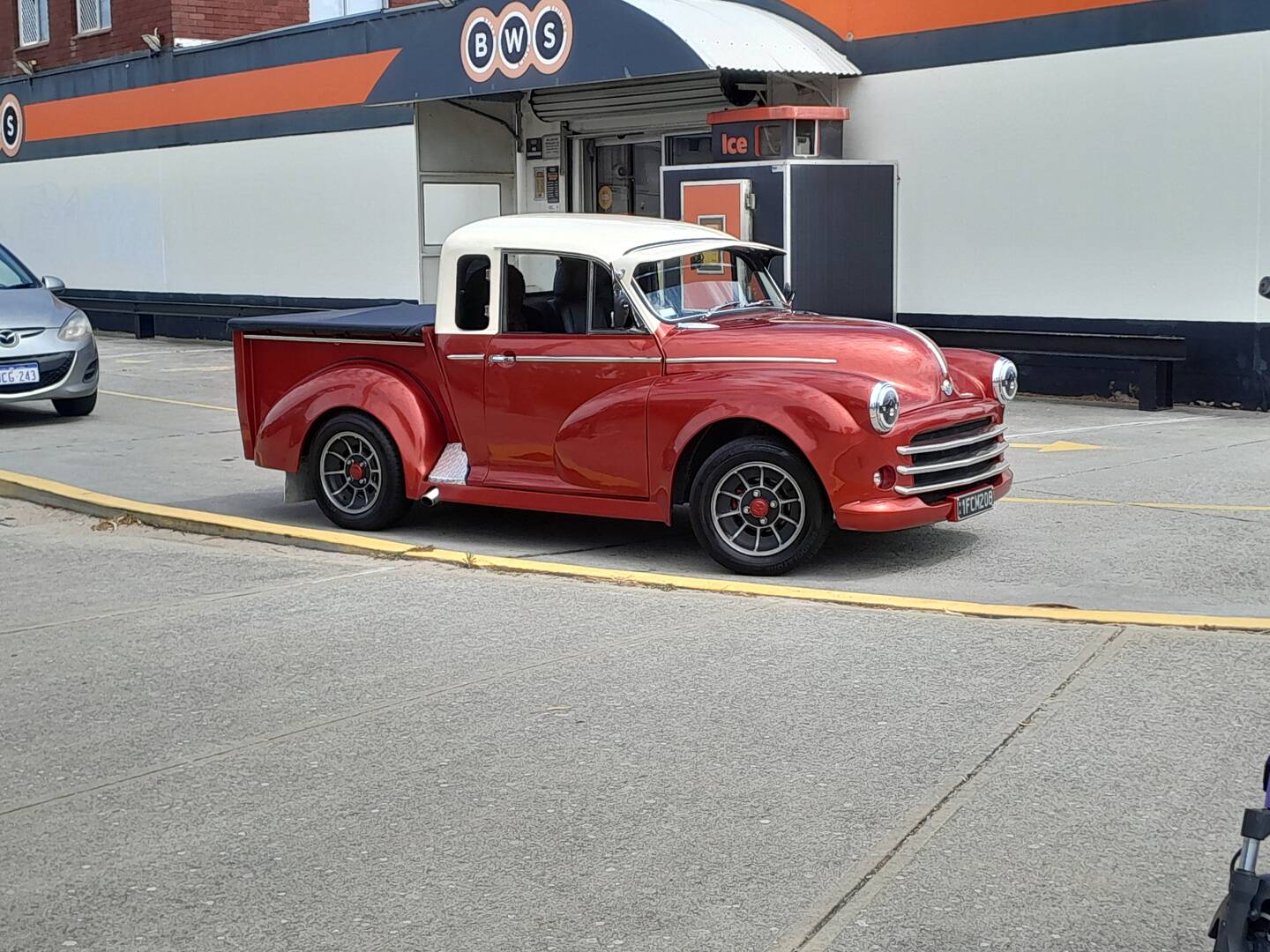

  1.
    20241213 095335
    Dave who lives nearby got his creation thru the legal hoops and registered in time for Christmas.  He's a retired boat builder 👷‍♂️  this one's a credit to him. clap
Posted : December 13, 2024 5:51 am
DRONE, MGV8, sheath and 3 people reacted
Bruce, for those of us that are not familiar with the vehicles that are specific to OZ,
can you tell us the year, make, and model of Dave's pickemup ?
Posted : December 13, 2024 9:49 am
Brstr and sheath reacted
Posts: 616
1960 Morris Minor Traveller?  Just a guess. 🤫
