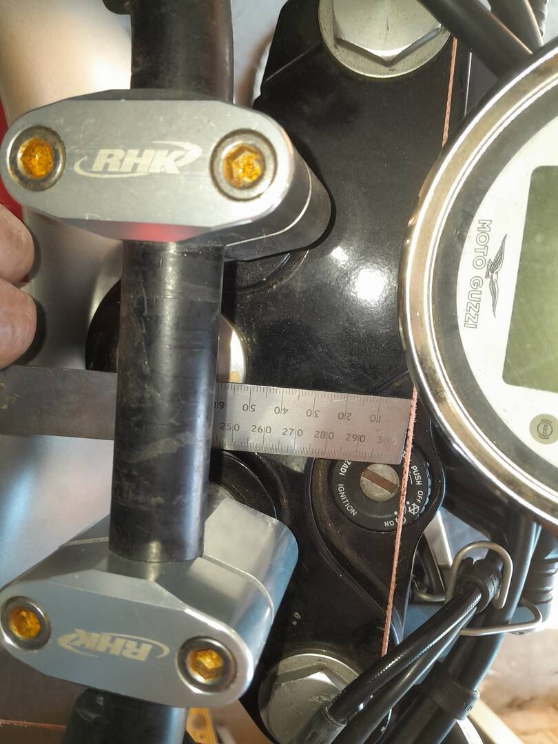

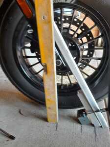

 Started measuring again for triple tree mods.
John said he will be selling the milling machine soon.  So needs must.

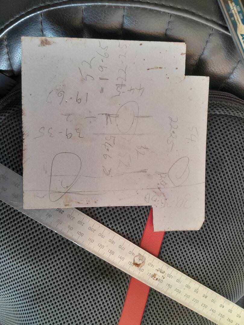

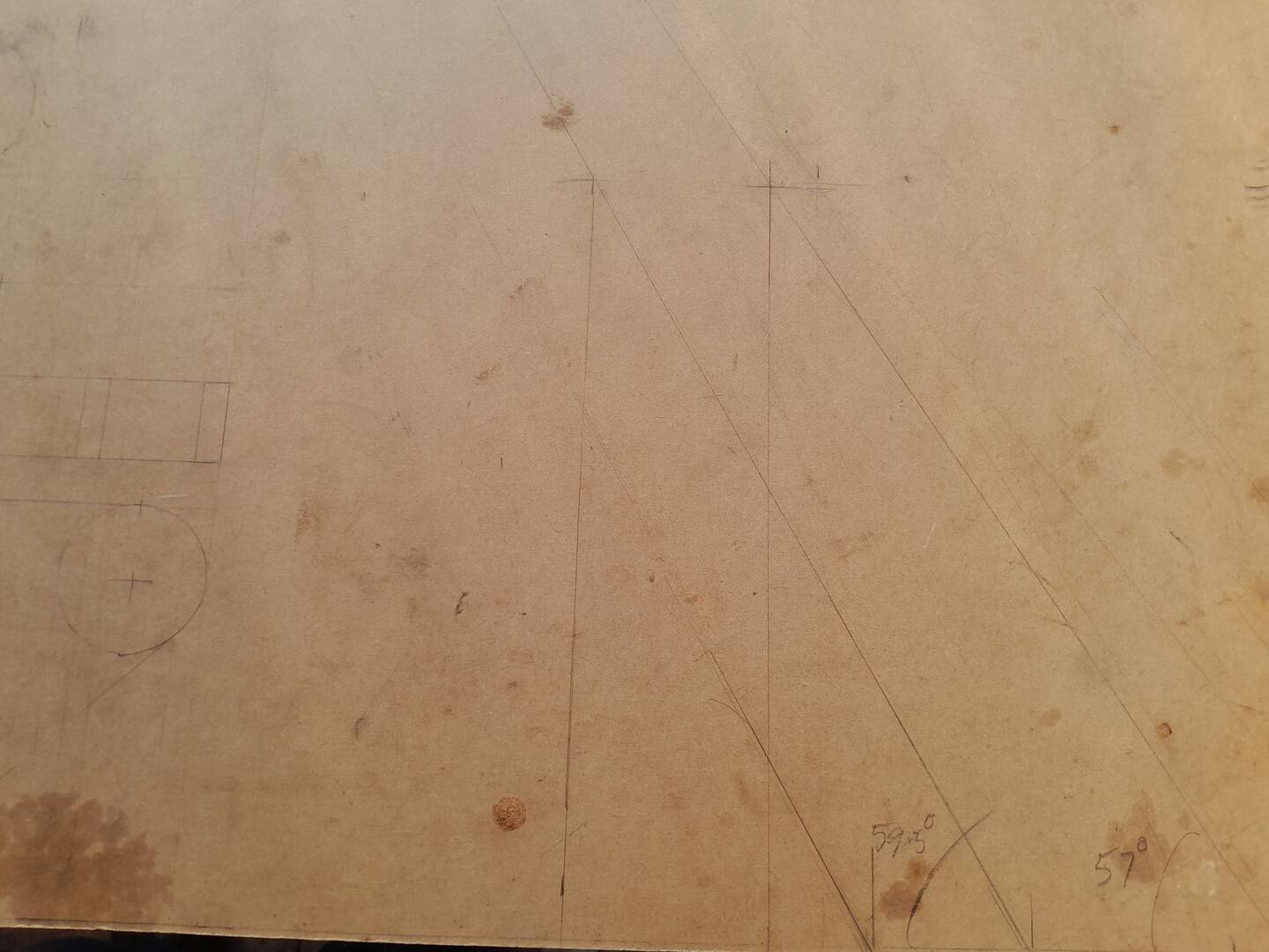

Posts: 524
OK question.
How long is a piece of string type.
Stock trail is 116.1416 mm.
Well close to that.
Options are open.
Was thinking maybe 30mm?
Too scary?
I had to measure then remeasure repeatedly to see what the actual dimensions are.
Still not 100% accurate but guessing near enough
Should be 26.4 deg rake but I keep getting close on 30 deg.
The rear of the bike sits a little low but 25mm over 1480 mm is less than 1 degree.
According to my measurements.
Forget calcumalations.
I'm drawing it out on a piece of MDF sheet.
Thanks.
Posted : September 26, 2024 3:39 am

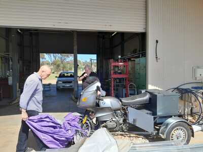

Figured a work around for bending light walled pipe. Should work on tube as well. Cut some disks from 1/2" MDF sheet. Sanded till they were an interference fit then hammered them in till they were 4-6" either side of the bend area. 1 plug then fine clean sand then the other plug.  For what I am doing it's OK to leave the sand in.
One day the plug will fall out and pile of sand will confuse someone.
Also old BMW teaser
The trike is for sale.
Nope never asked how much
20241007 072945
20241007 095935
Posted : October 17, 2024 6:31 am

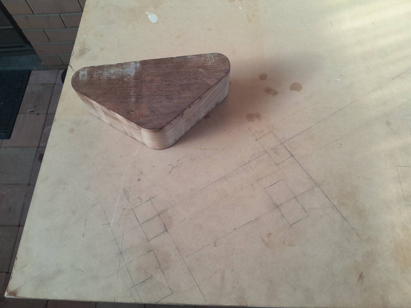

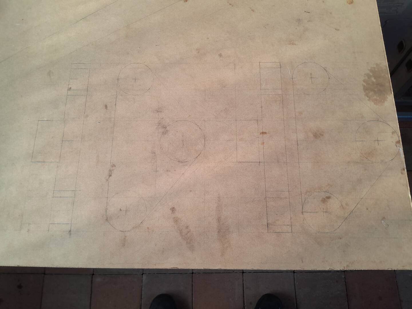

Posts: 524
This site saves drafts.
Still learning where they go.
Scratchings on a sheet of MDF.
Then shape a block of wood to see which way to go next.
20241017 165647
20241017 165636
20241017 165630
Posted : October 17, 2024 6:39 am

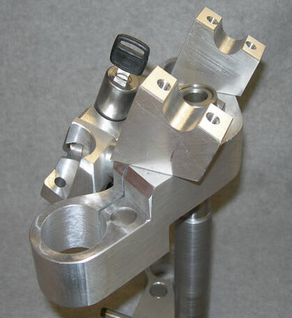

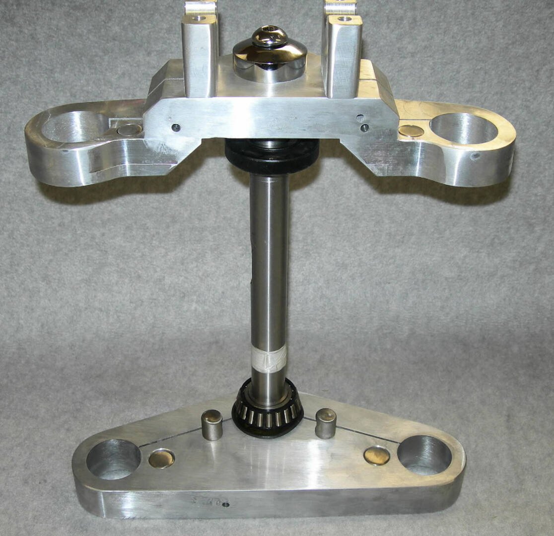

Posts: 524
Drop triple trees.
Stops the height drop when the forks rake out.
That's the aim here but what mine will look like is yet to be seen.
Messing with the wooden mock up because my friend John doesn't have my naive confidence about being able to figure it out as I go.
What could go wrong???

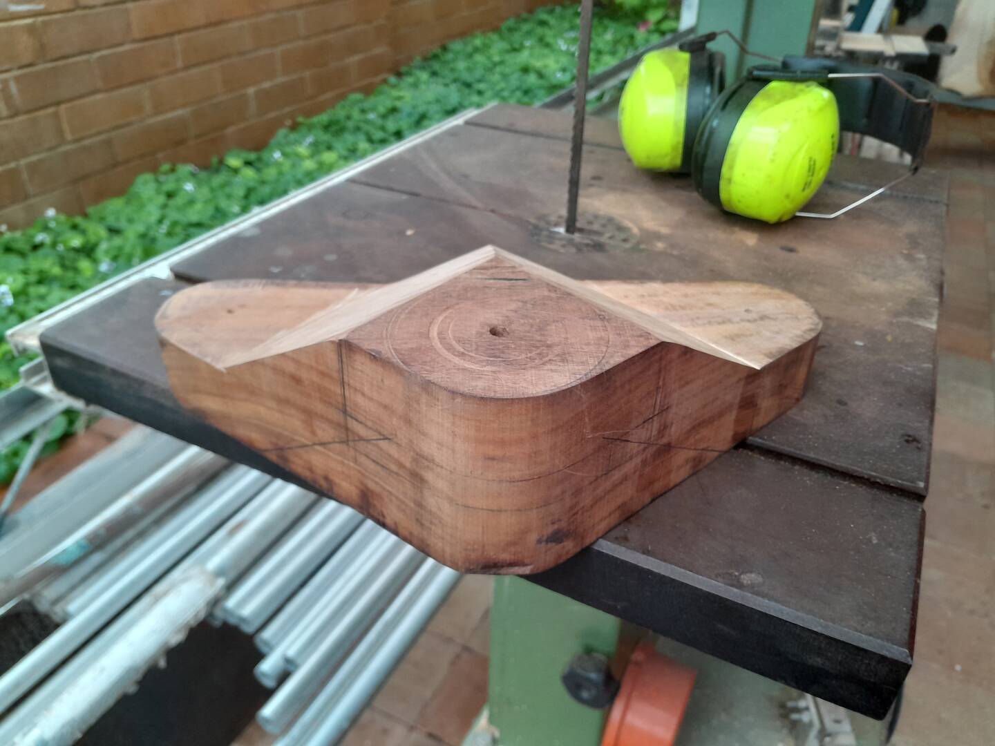

20241020 165819
20241020 165805
Working with  bandsaw, a belt sander, a hand saw and a drill press. Getting close to dimensions wanted.
It's a matter of proving the design modifications from standard. The tricky bit's to come
Shame I have no CAD skills.
Posted : October 20, 2024 8:36 am
