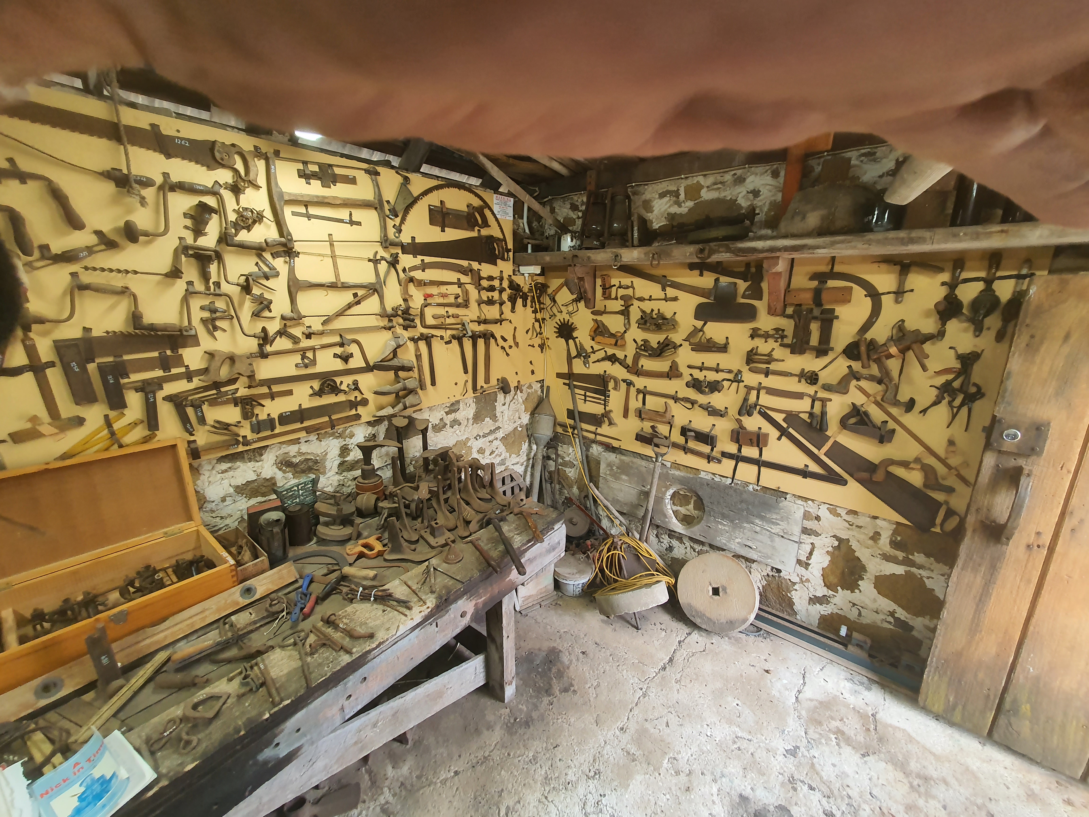

Old stuff in a very old shed

Loving the old shed with old tools.  Actually all of it - quite a museum of awesomeness you've got going on down there.

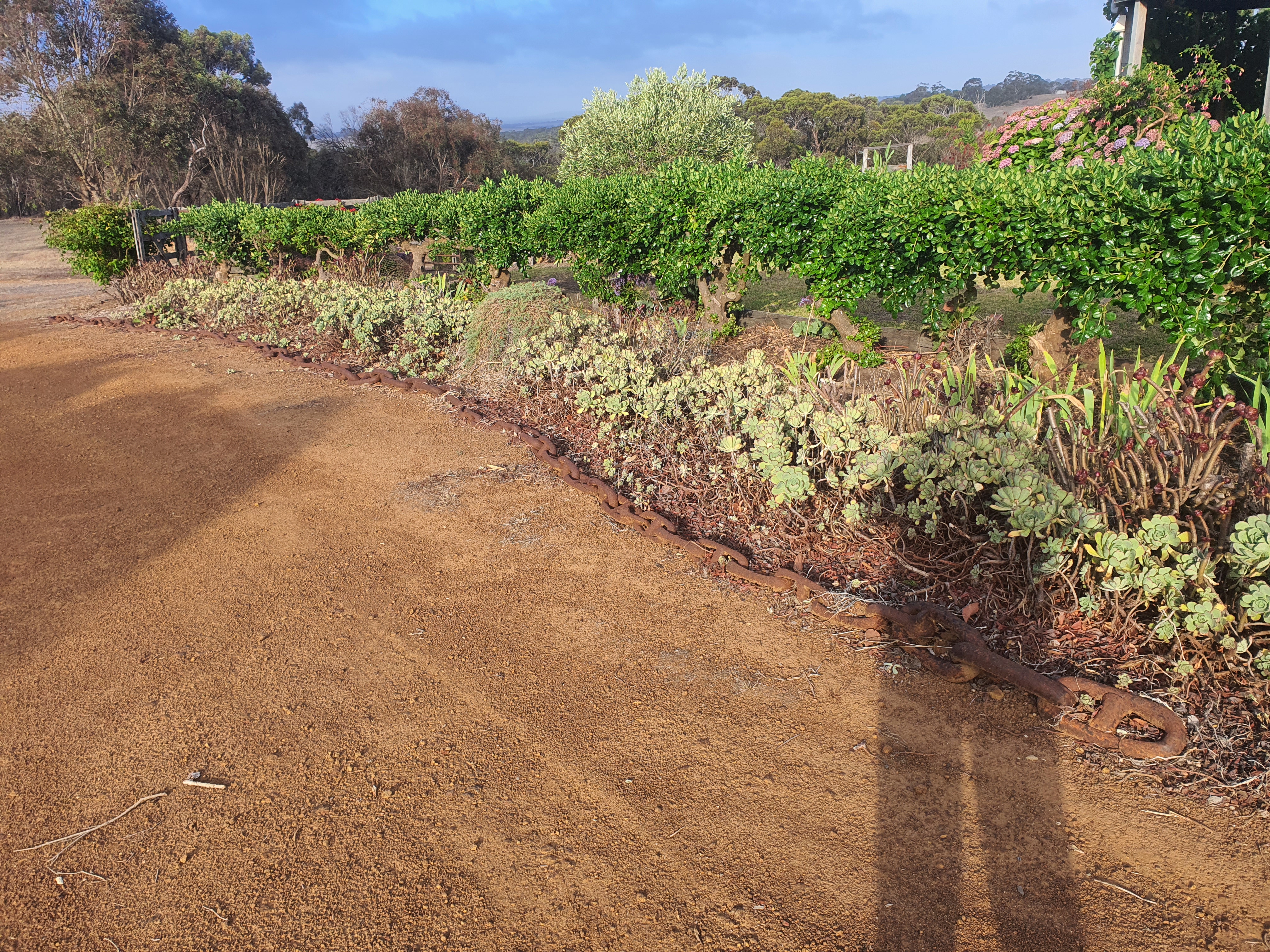

Chains

That is a hen of a chain.  What was it used for?
Posted : January 17, 2024 3:16 am
I'm going to safely venture that the big a** chain was used for marine use, for securing a very large vessel to an anchor.

Posts: 738
Did it work? Houdini think of that.
They may have been designed for maritime use.
But spent the last part of their service life being dragged through bush.
Between 2 tractors or crawlers.
Some times with a large steel ball in the centre to keep the chain at a height to knock trees over.
As a boy I saw and was involved in land clearing and even as an adult I cleared and cropped new ( ? Old ?) Land.
Now I have seen that same land having been developed and productive as farms.
Then re planted to trees and even more recently watched the same being harvested.
Who would have thunk it?

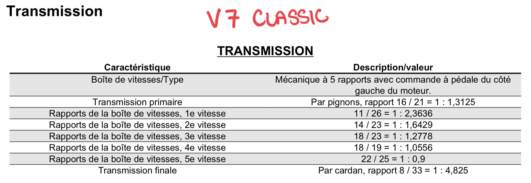

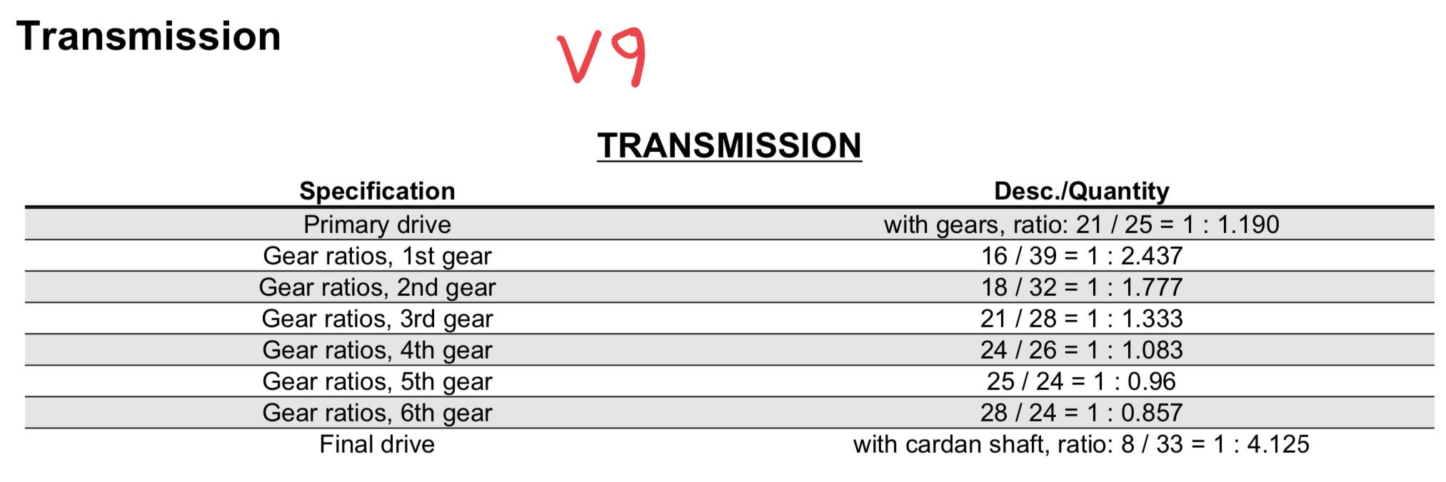

Found some  charts a fine fellow put up previously.
Some interesting differences in the primary gear reductions.
Haven't done the maths.
And don't have a few engines laying about to swap bits with.
Earlier small blocks had a slightly higher final drive than  current ones.
Therefore they ran lower primaries.
Don't know if there's any compatibility between 5 speed and 6 speed boxes.
There's a fair primary difference between the V7s and the V9.
Probably ignore the V35.
The V7iii and V9 have their engines tilted foward a few degrees.
I notice my V9 has the highest primary drive so far in the small blocks.
The primary in the V7 850 may just be possible to use in the V9.
But may need a couple of wrecks for practise???

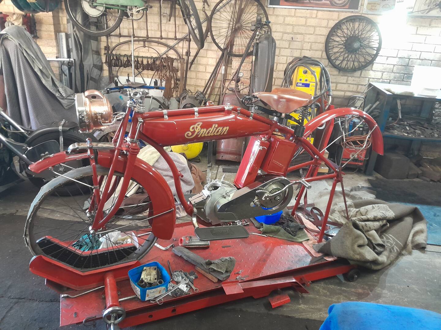

On the bench is a 1917? 680c smaller Vtwin built to compete with British stuff..

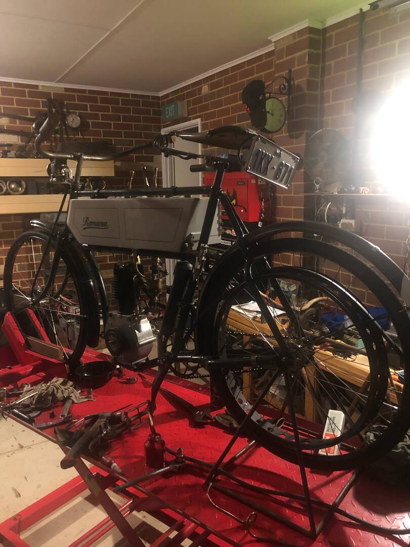

Dennis was burning the midnight oil trying to sort the 1903 Minerva for this weekends run.
Little things like getting it to run for more than a few seconds.
And what was that loud knock in the engine?
 Gudgeon pin was a little  too long and hitting the flywheel near bdc.
It now runs again.
IMG 20240905 105305
