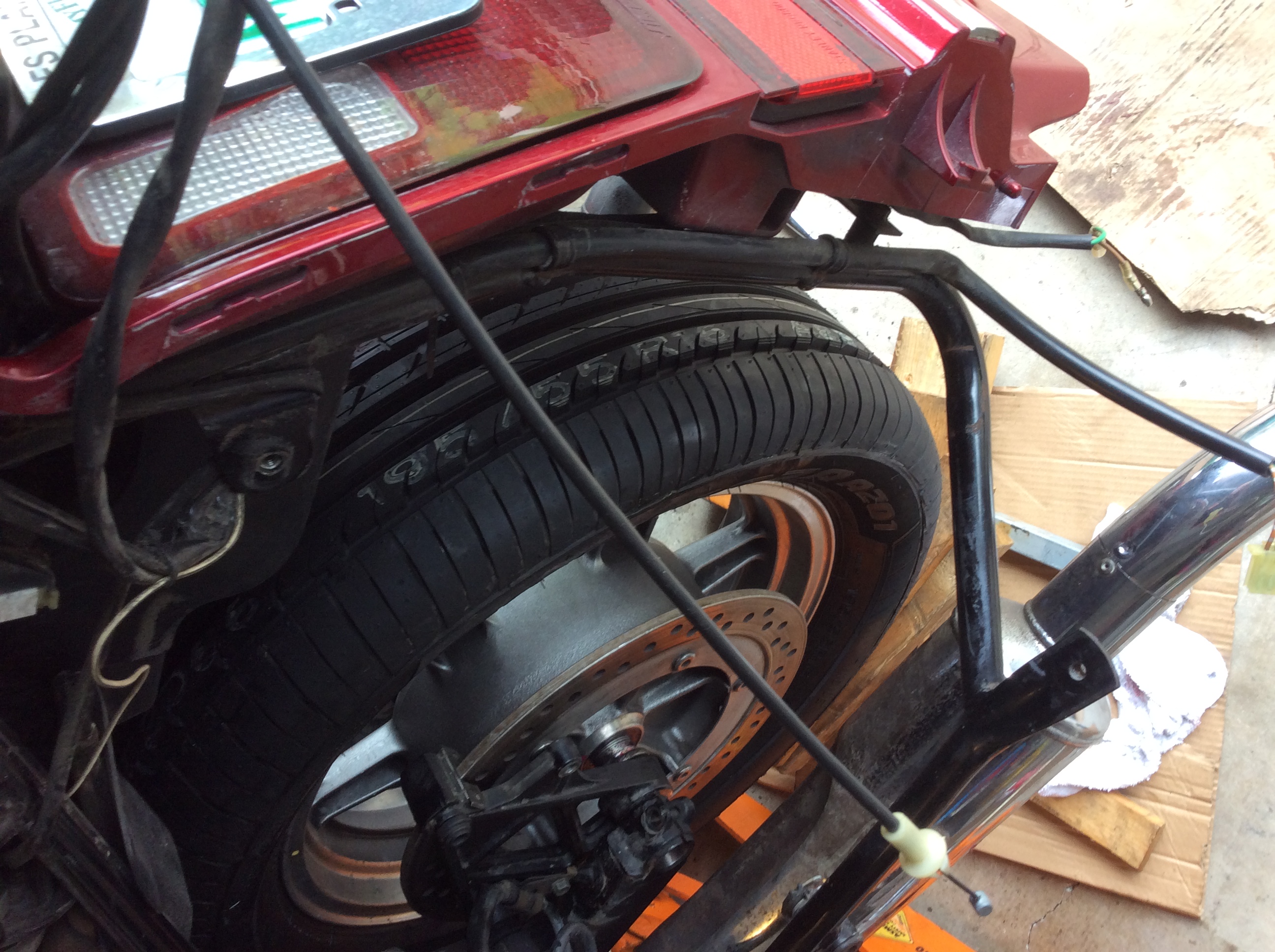

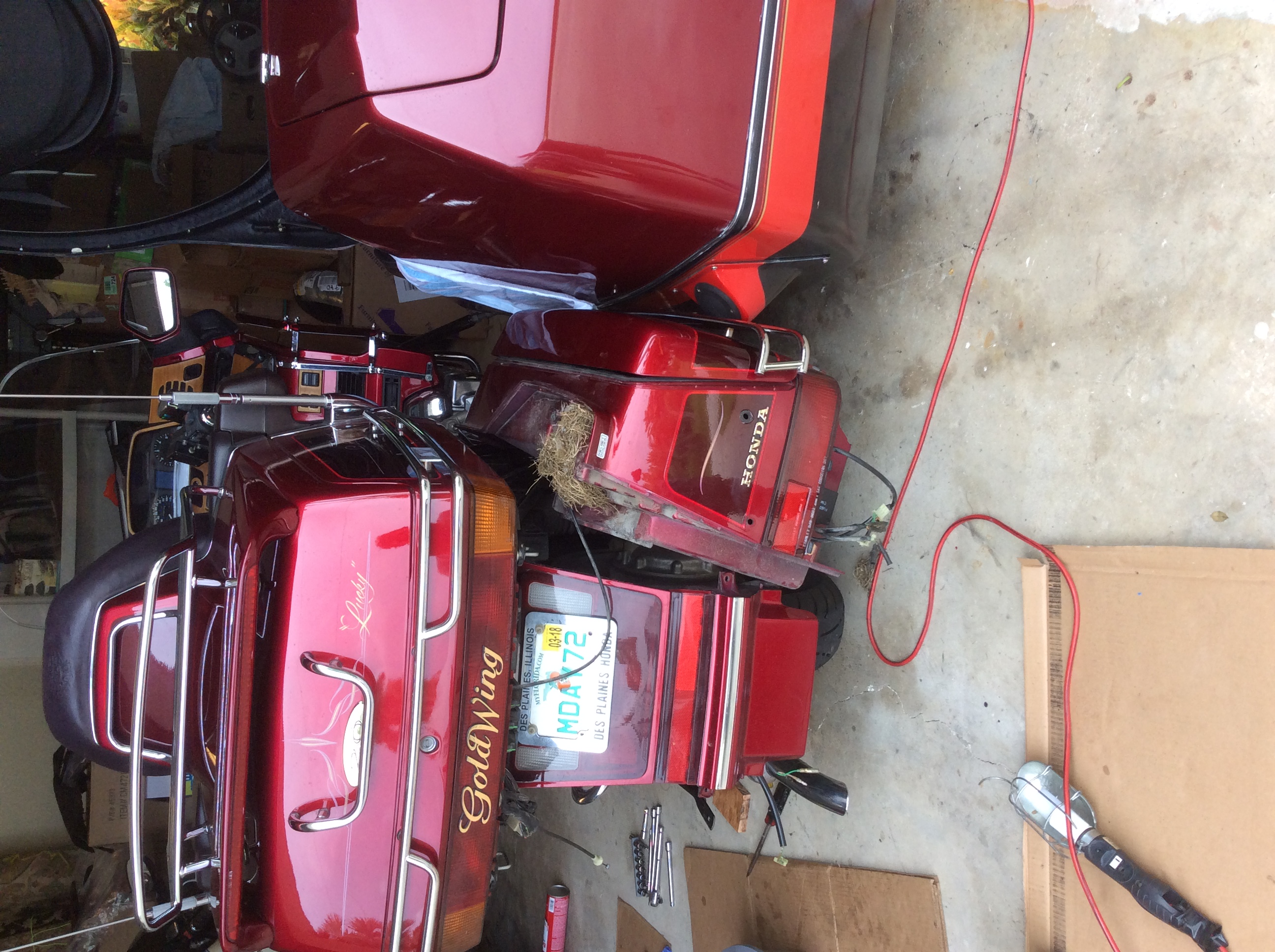

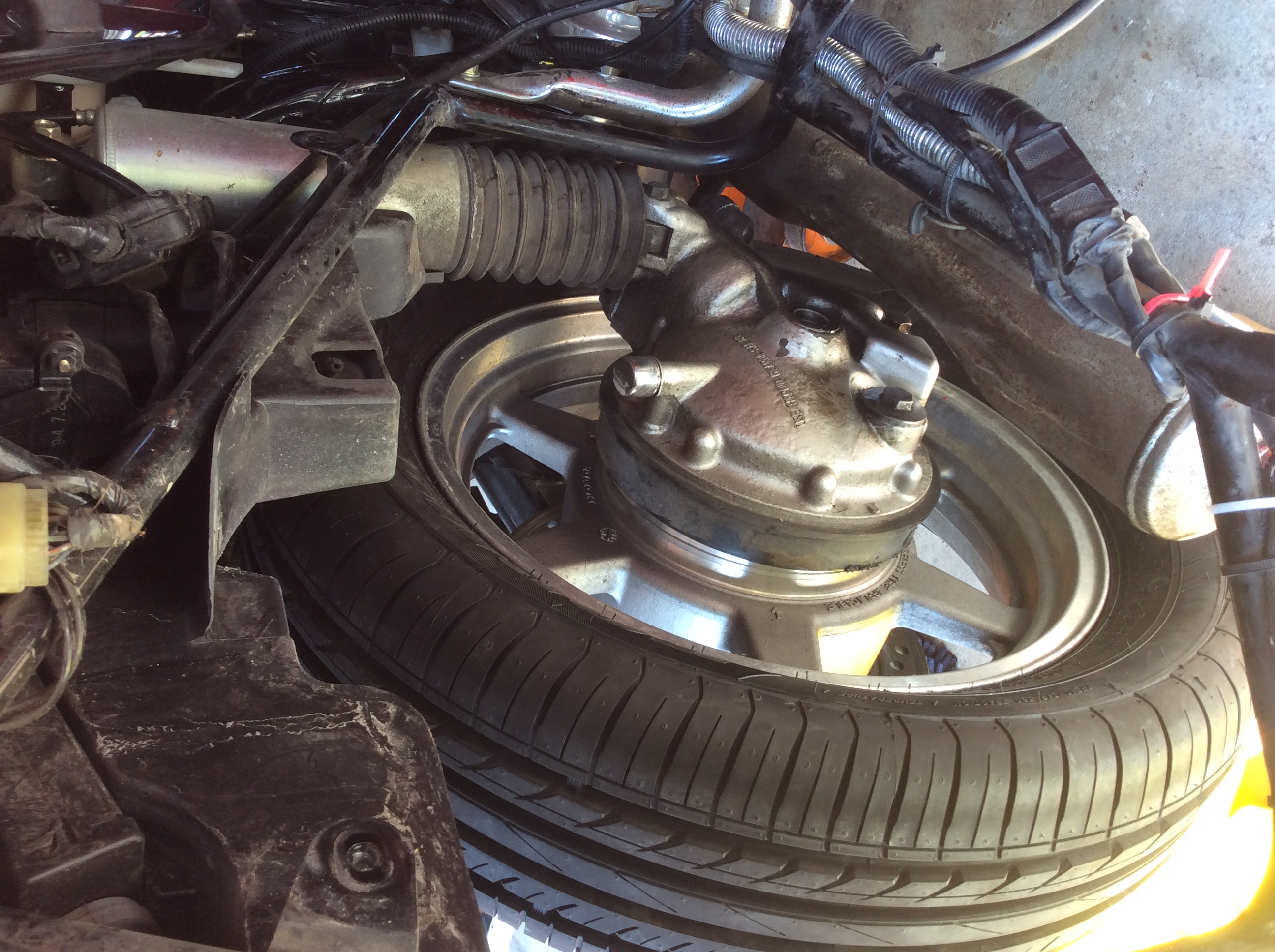

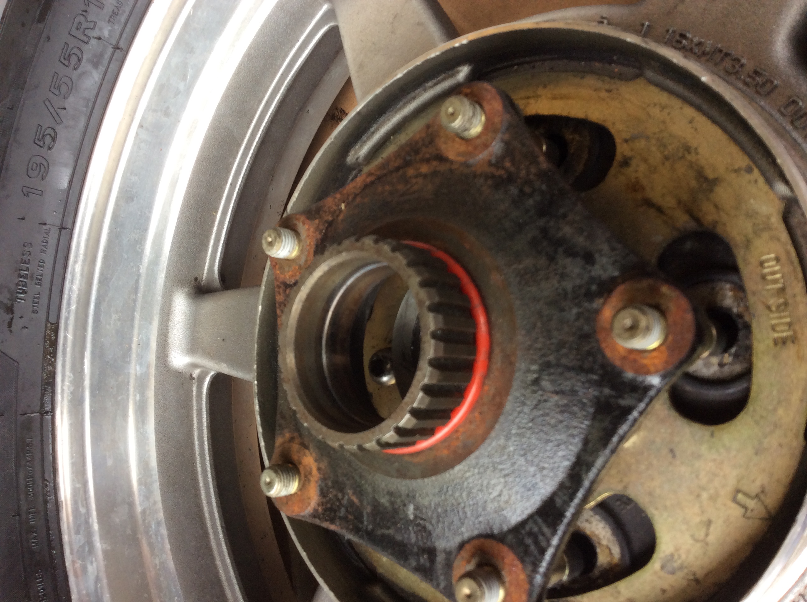

(@bentleyssq)
Posts: 127

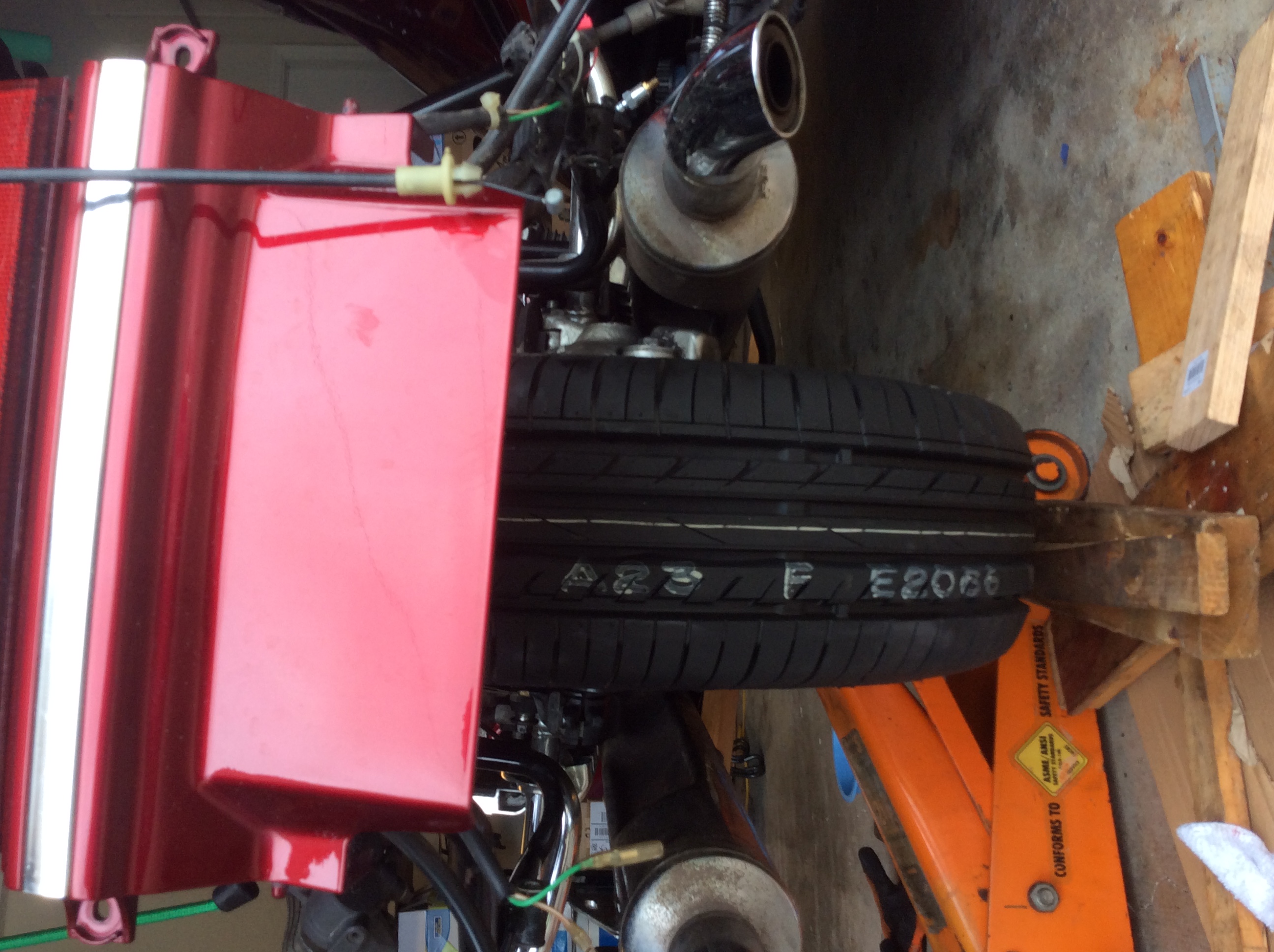

Just went out to the garage to check and look under the bike. Have about 3/8 - 1/2 inch clearance. My model is a 1995 SE. I mounted the tire on the spare rim myself, used 2 ounces balance beads and sprayed the the rim with Pledge to get it to seat. Used approximately 65 -70 lbs to get it to seat. I tried to mount it with 35 lbs of air in it but no way would it fit. So, I deflated the tire and tried and it was still tight. I then got some Dawn dish detergent soap an spread it on the sides of the tire to "Persuade " it past the swingarm and wheel hub. With a little "muscle it slid it then I used some wood block to raise the tire up and side it on the splines Bolted it back together via the "Goldwingdocs tutorial on how to remove and replace the rear wheel and "Voila I now am Darksided. It's tight , it requires some pushing and maybe a friend if available to help , but it will fit. Federal Formosal Sorry for the sideways views.......sometimes when I transfer pics from my Ipad they do that .......have not figured out why yet.

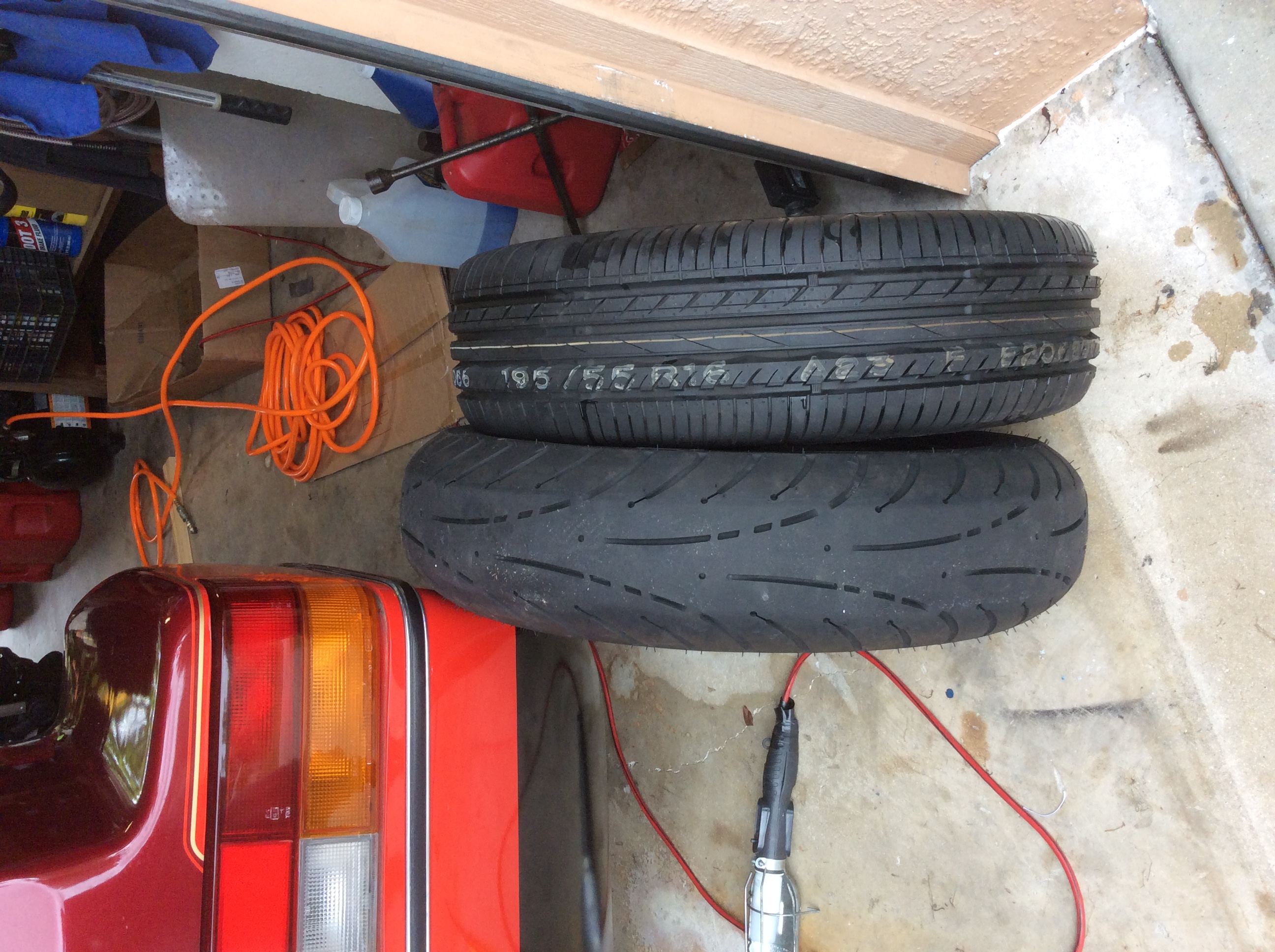

(@bentleyssq)
Posts: 127

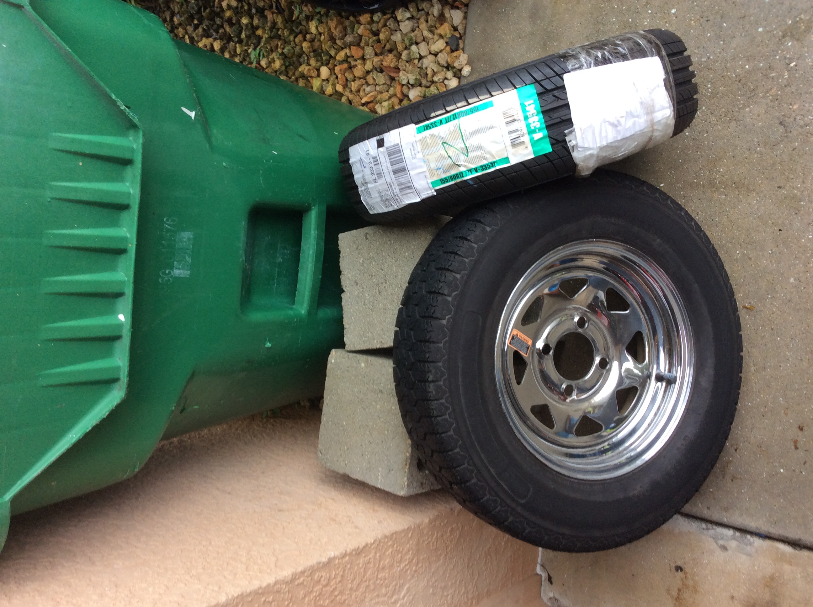

Old tire and rim and new tire. Comparison view.
Posted : August 31, 2017 1:54 pm
Posts: 864
gota say that is a good looking tire and looks like a good fit. you should see long wear life out of it
only real downside is your going to lose fuel mileage due to the higher RPMS, up side you can pull off from any situation loaded to the hilt and not worry about lugging her down
