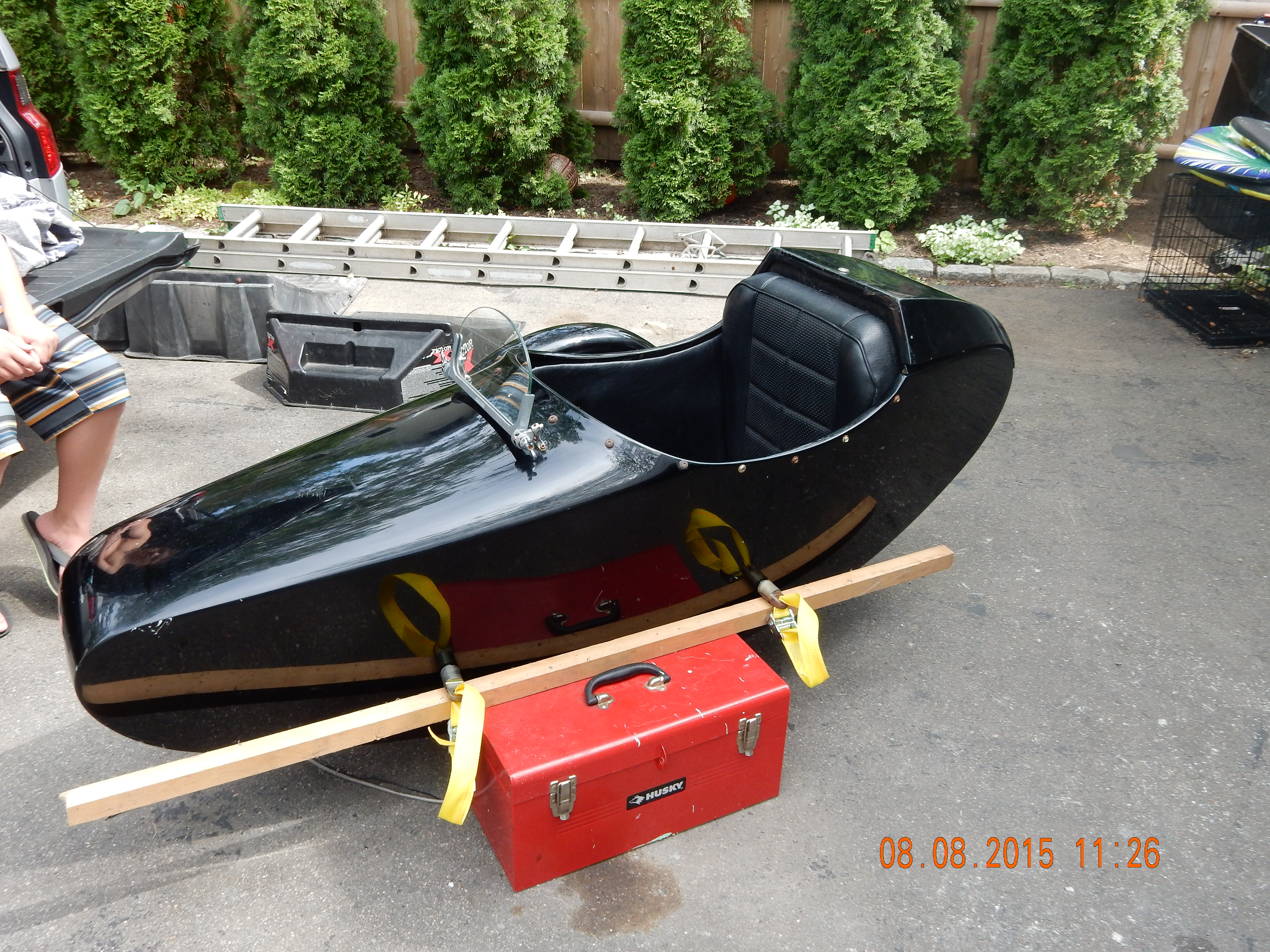

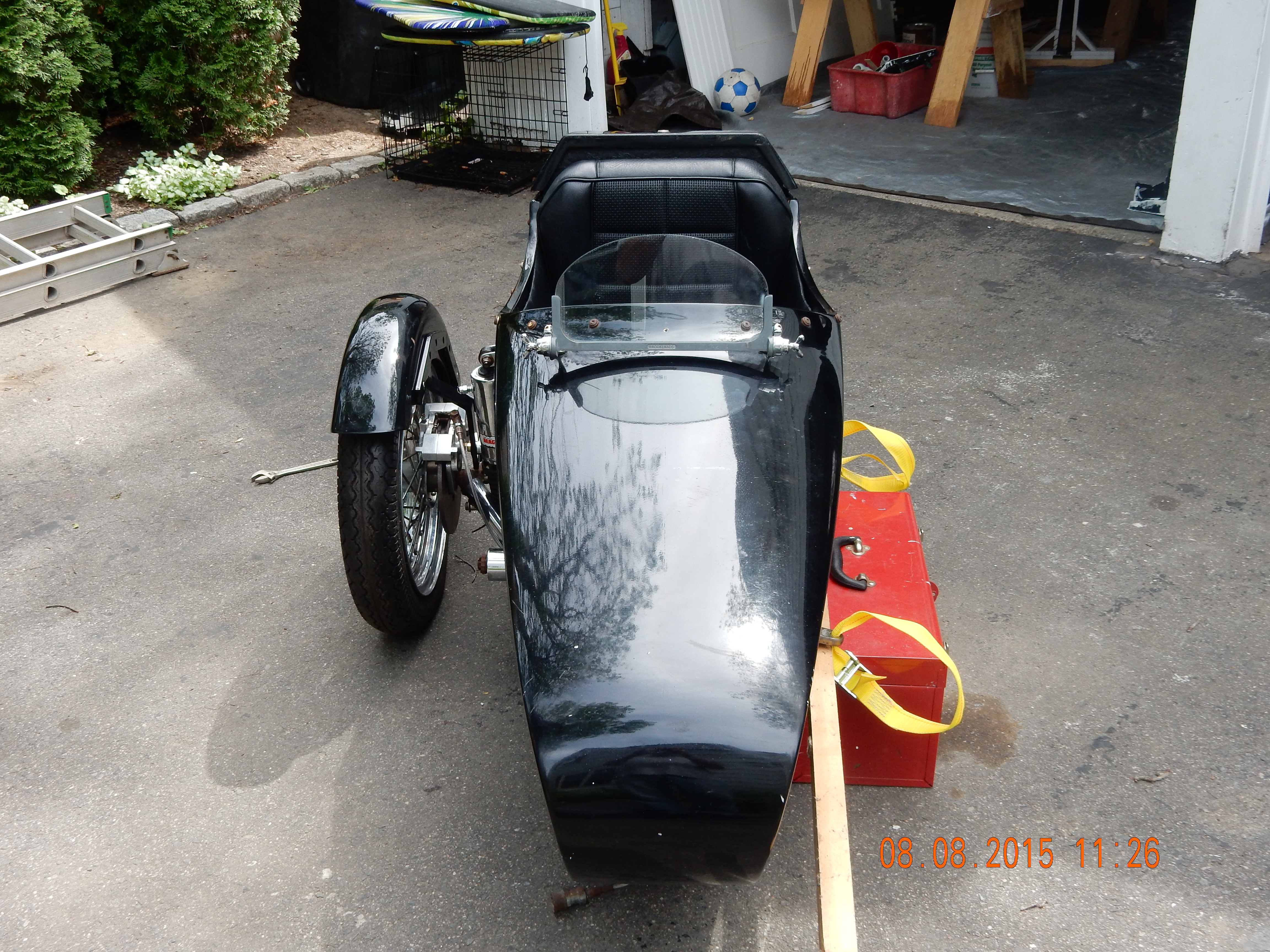

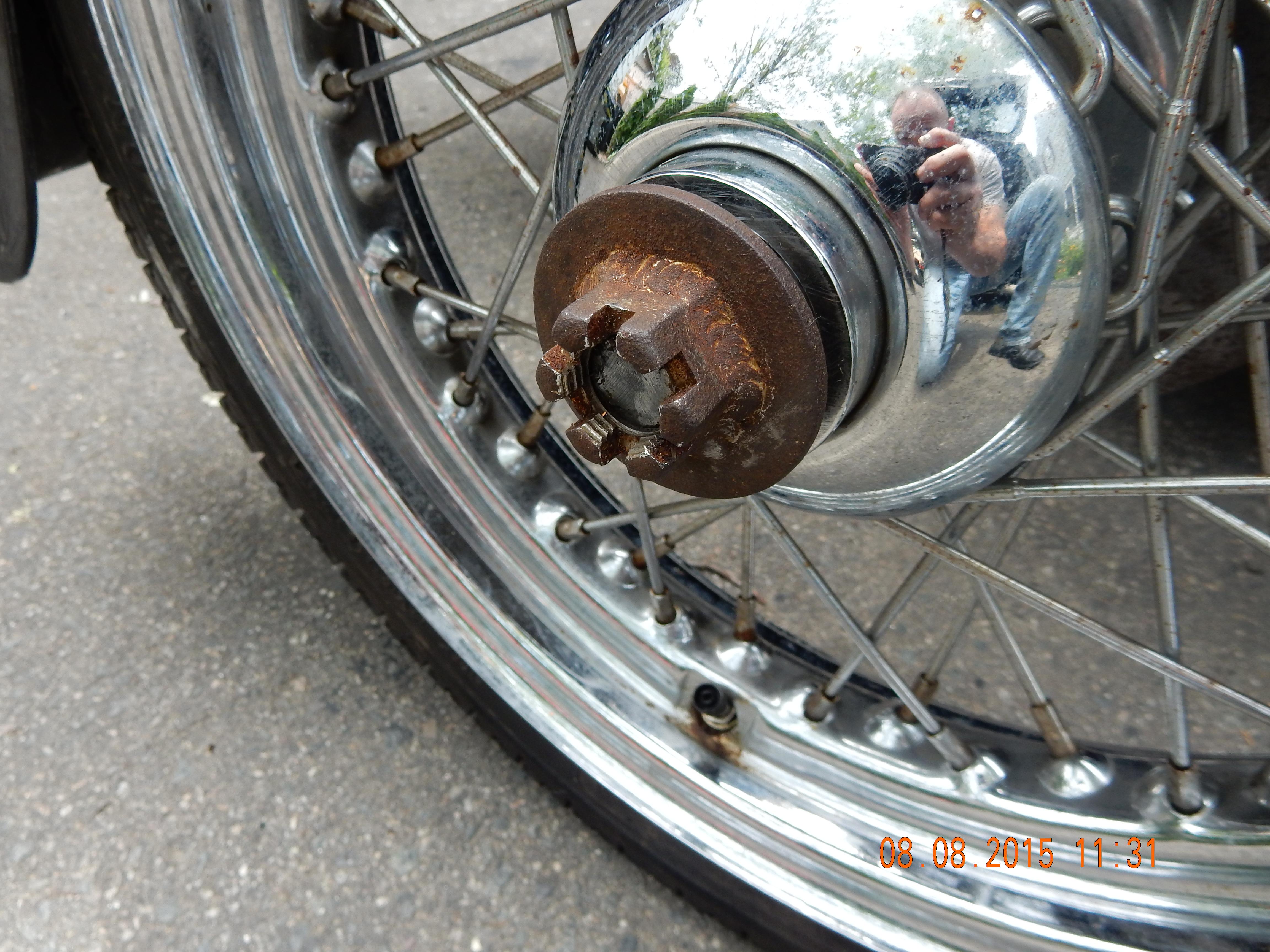

After deciding against a Velorex for my 97" harley softail custom, I was considering the Liberty or Motorvation Spyder. I was considering new, but wasn't sure I wanted to shell out that much cash for a bike that really isn't worth a whole lot. I'd been looking for used sidecars, but they are very difficult to find, especially local. I found a Motorvation Spyder located in Long Island on Craigslist. Short on time, I drove overnight to the Bridgeport CT ferry and met the seller on the other end. We did the transaction very quickly, as I had a reservation on the next boat back. It didn't look as good as it did in the pics and it definitely wasn't in the "excellent" condition stated by the seller. Oh well, I'm just excited to get back into sidecar riding again! Can't wait to get it painted/installed. There is significant rust on hardware/metal parts and I would like to do something about this. Questions:
The snaps that are used for the tonneau cover are all rusted. Do I have to go through Motorvation for replacement "snaps"? How are they removed/affixed to the tub...riveted?
The windscreen has a sizable scratch on it. Can I just go to a glass co and have them cut a piece to size?
Is it best to have the sidecar painted before installation or vice versa?
After looking at these pics, what should I replace?
Does anyone know of a sidecar installer in Massachusetts? I would be willing to pay a non-professional if they really knew what they were doing.
Thanks,
Dave

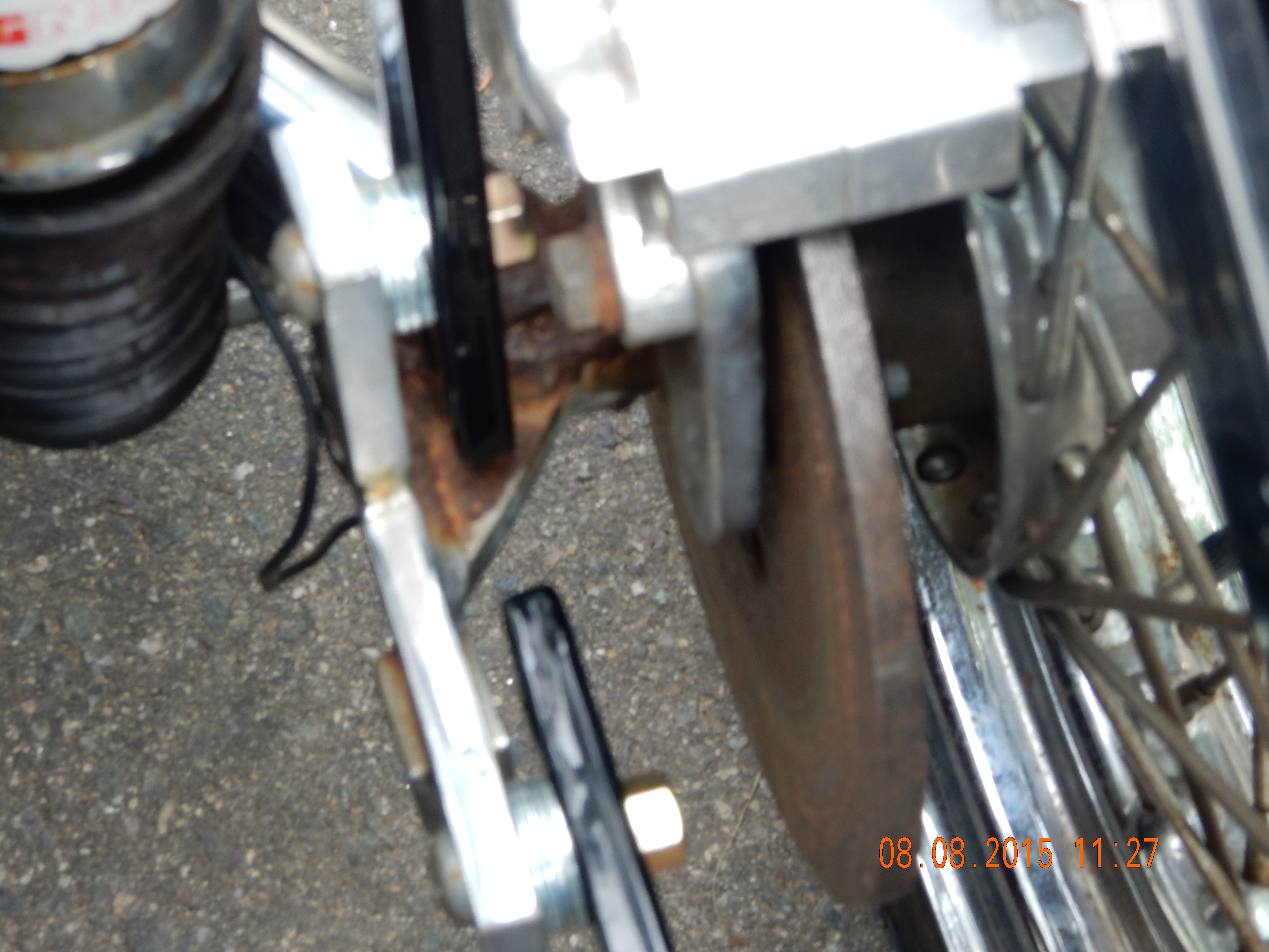

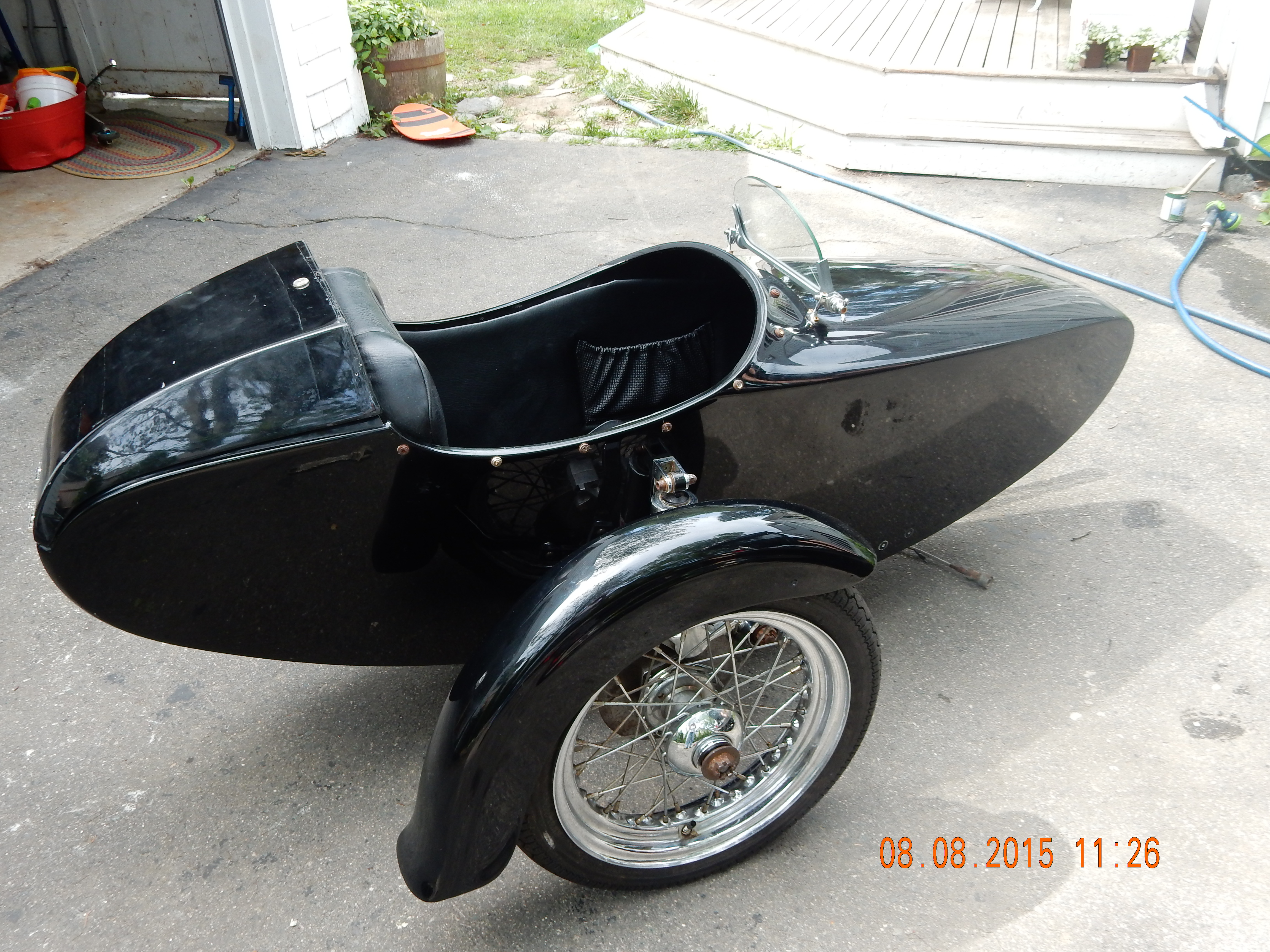

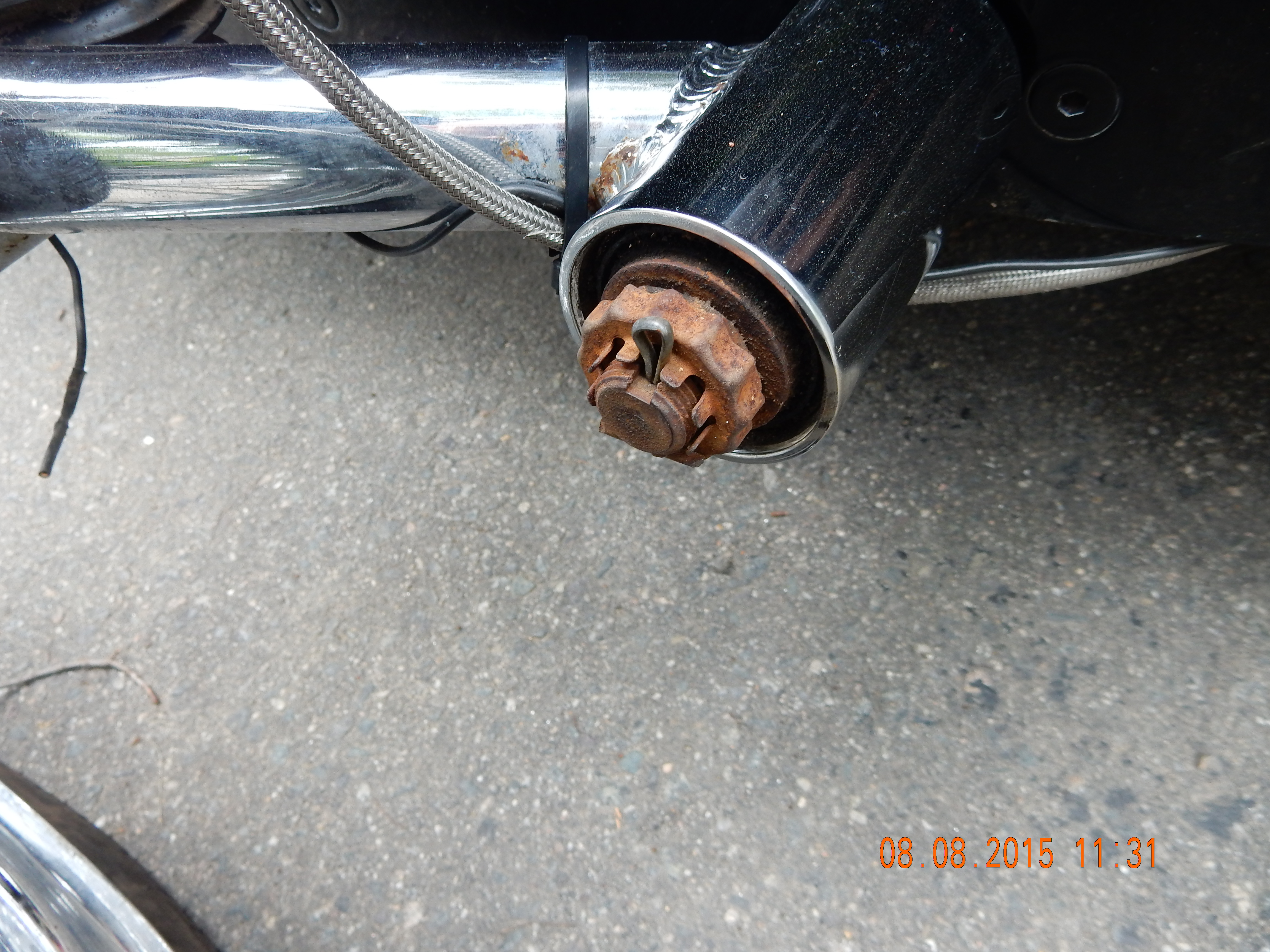

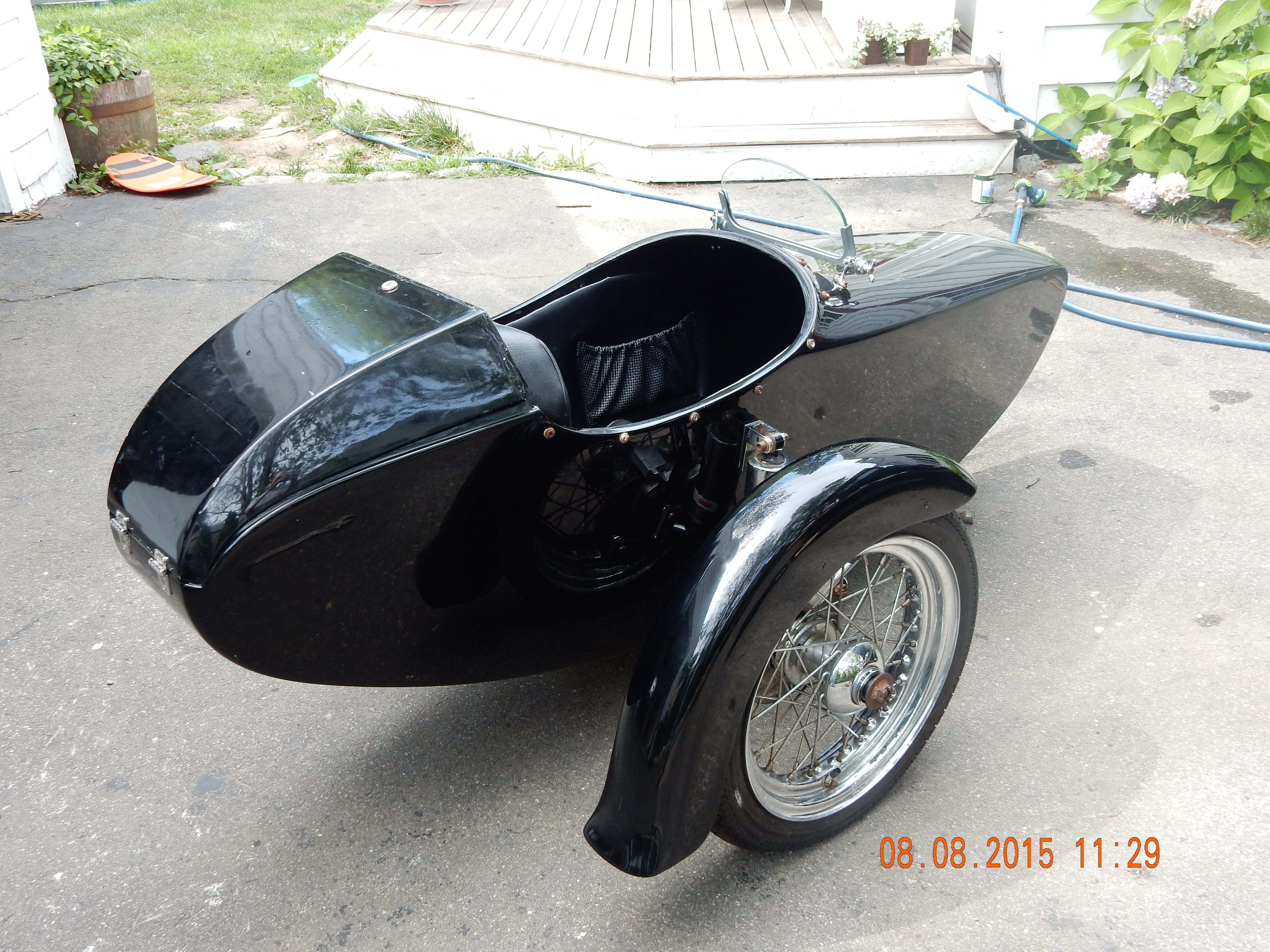

A few more...

The snaps are standard and can be self installed with pop rivets. Installation tools are available at hardware shops, or on line.
With the amount of rust on the spindle nut area, I'd check the axle bearings.
I imagine Motorvation uses tempered glass on the windscreen, or you could go Lucite and do it yourself.

use a small drill bit and just drill the head off the rivet so the snap come off, then use a small punch or like to push the remaining part through the fiberglass
that's a nice looking rig, looks like most of that rust will clean up good. I'm curious as to why the castle nut on the wheel hub not all the way on the spindal, it looks like it's being held out too far to get a cotter pin in it

Thanks for the response. I pulled the cotter pin/castle nut off the spindle. I am going to remove the rust from some of the hardware with Naval Jelly and will replace any rusted parts that I am able to. It's a bit of a project, but it will get done.

First of all, guys, a Spyder has no "frame". It uses steel plates embedded in the fiberglass body at strategic points to mount the suspension and mounting hardware to. Second, painting first subjects the car to damage while wrestling it in position and making adjustments during mounting. I would mount it, make all adjustments and road test it until perfect, then remove it for painting and other detailing. Motorvation's mounting system, as seen in one of the pics, makes it very easy to remove and re-mount without losing adjustments. For painting, just remove all of the suspension parts and leave the mounting bars in position and mask them off.
That castle nut/washer thingie sure looks like something cobbled up after the fact. Motorvation would not leave something like that in plain steel to rust! I would make, or have made, something a bit more visually appealing, or smooth the welds in a lathe on that one and have it chromed.
The nut and lock cap on the mount looks like something aftermarket, too. Mine had Nylok nuts and they worked fine for 112,000 miles. I replaced all of the stock fasteners on mine with stainless versions and used antiseize on all of the threads to prevent any galling.
