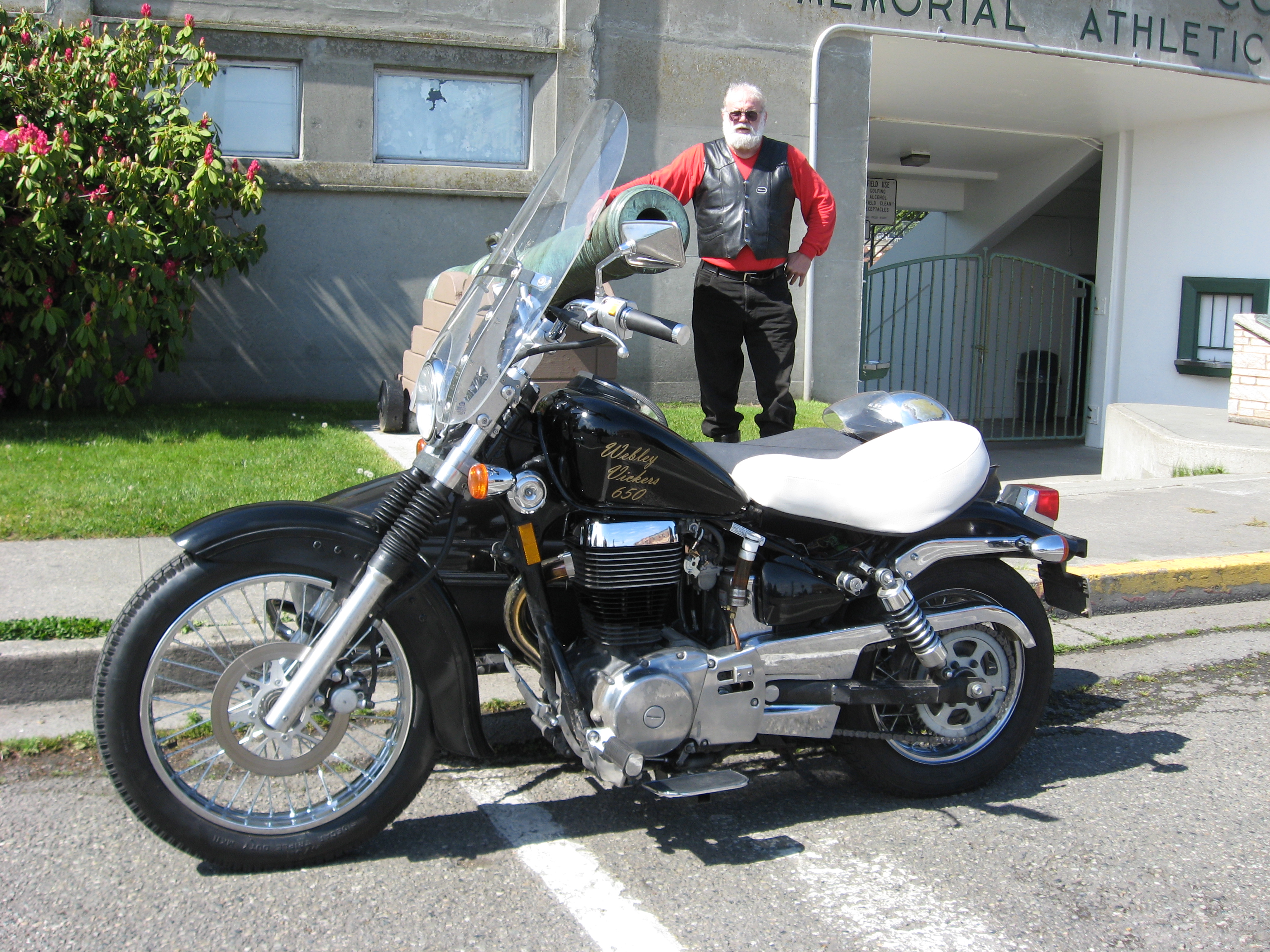

I will differ with the attitude that a Suzuki Savage is a waste of money.
I hade one pull a velorex for 4 years through Washington, Oregon, Idaho, Montane and British Columbia
reliably for many trips and campouts. It handled great, did highway speeds with no problem for hours at a time.
The two best things you can do for it is a set of super bars and convert it to chain drive.
Its' ease of drive ability makes it an outstanding first rig. I have owned and ridden ten sidecar rigs since 1968
So I have a lot to compare it with.
Posted : October 8, 2014 11:40 am
As for the deserved hair pull from Jim Phelonius I did edit my above comment about the Suzuki Savage:
(PS Note: the few ones I met over the years were completely screwed up. As Phelonius states further down he had very good luck with his one, so I better shut up on this one, his oppinion is valuable to me).
Jim, do you accept my apologies?
Posted : October 8, 2014 4:00 pm
Of course, I have no way of knowing how the ones you saw were set up. Possibly a case of builders ignorance of sidecar set up.
BTW one of my good friends is a sidecar instructor in Seattle. After seeing mine he built one himself and liked it as much as I liked mine.
He says my old one has shown up at his school twice with two different students and is still going strong. I sold it almost 5 years ago.
Posted : October 8, 2014 5:57 pm

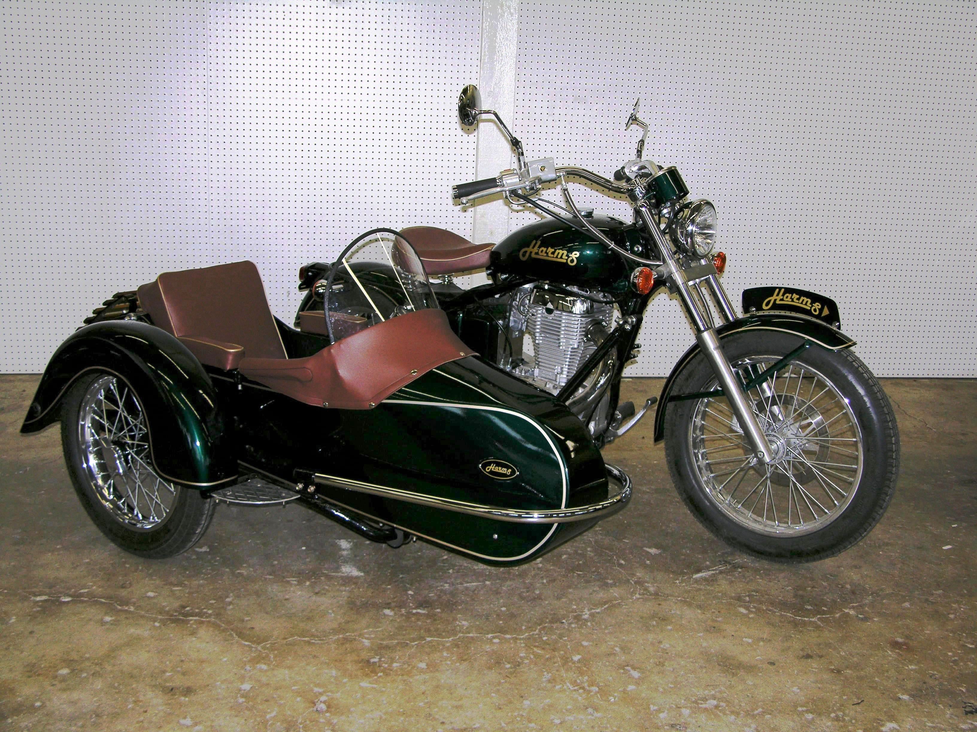

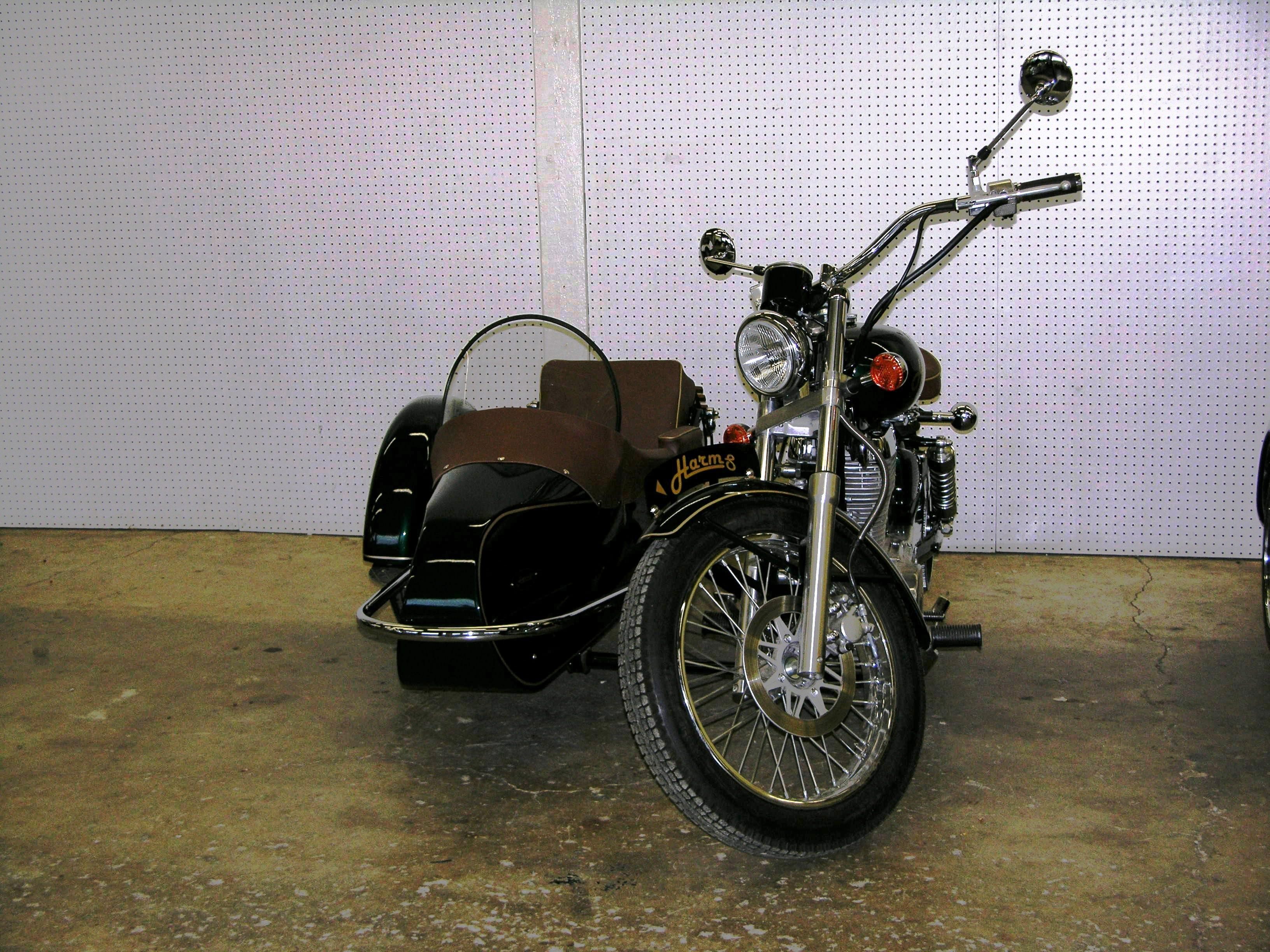

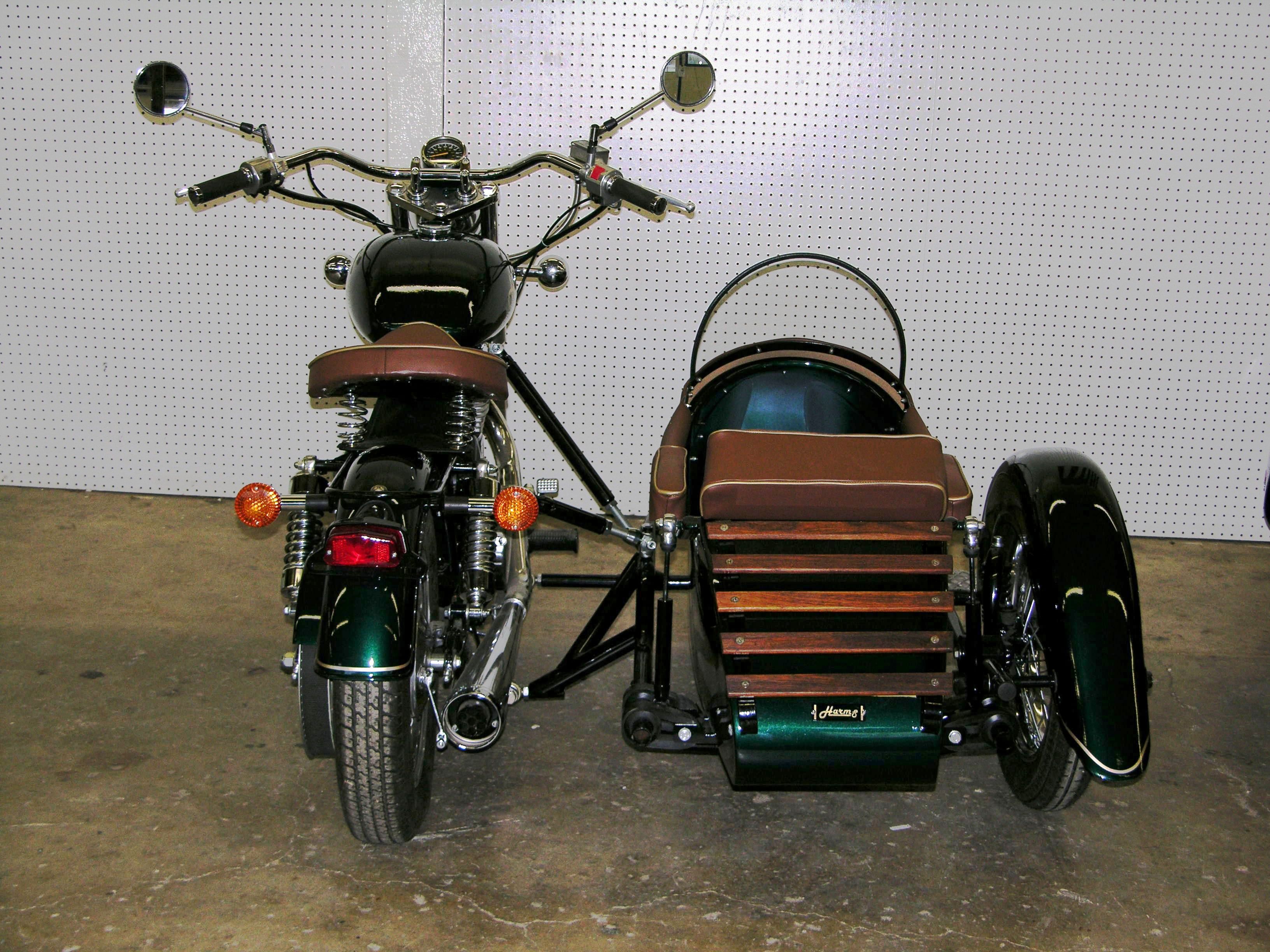

Here are some photo's of a Savage we did, slightly modified from stock.
