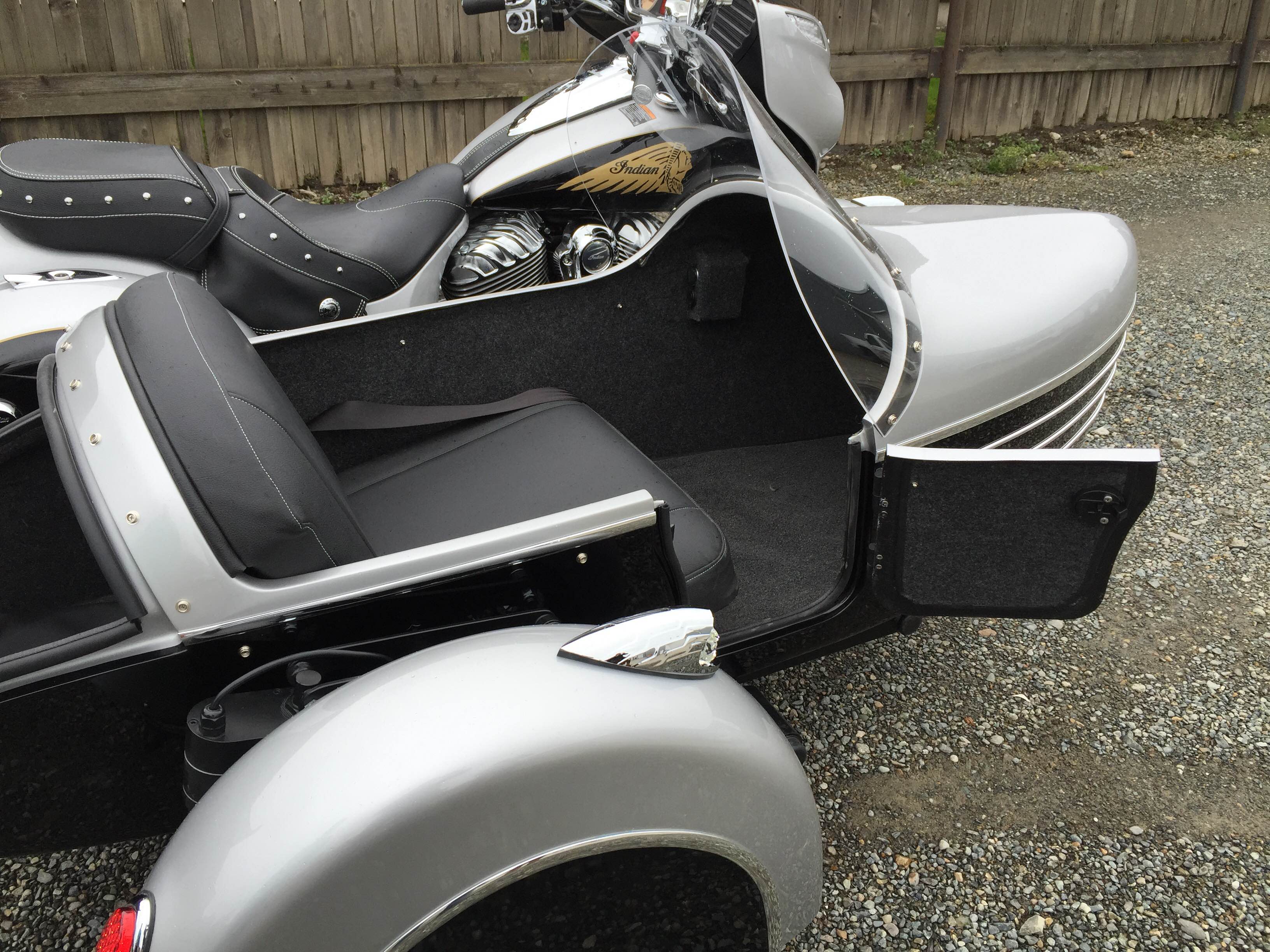

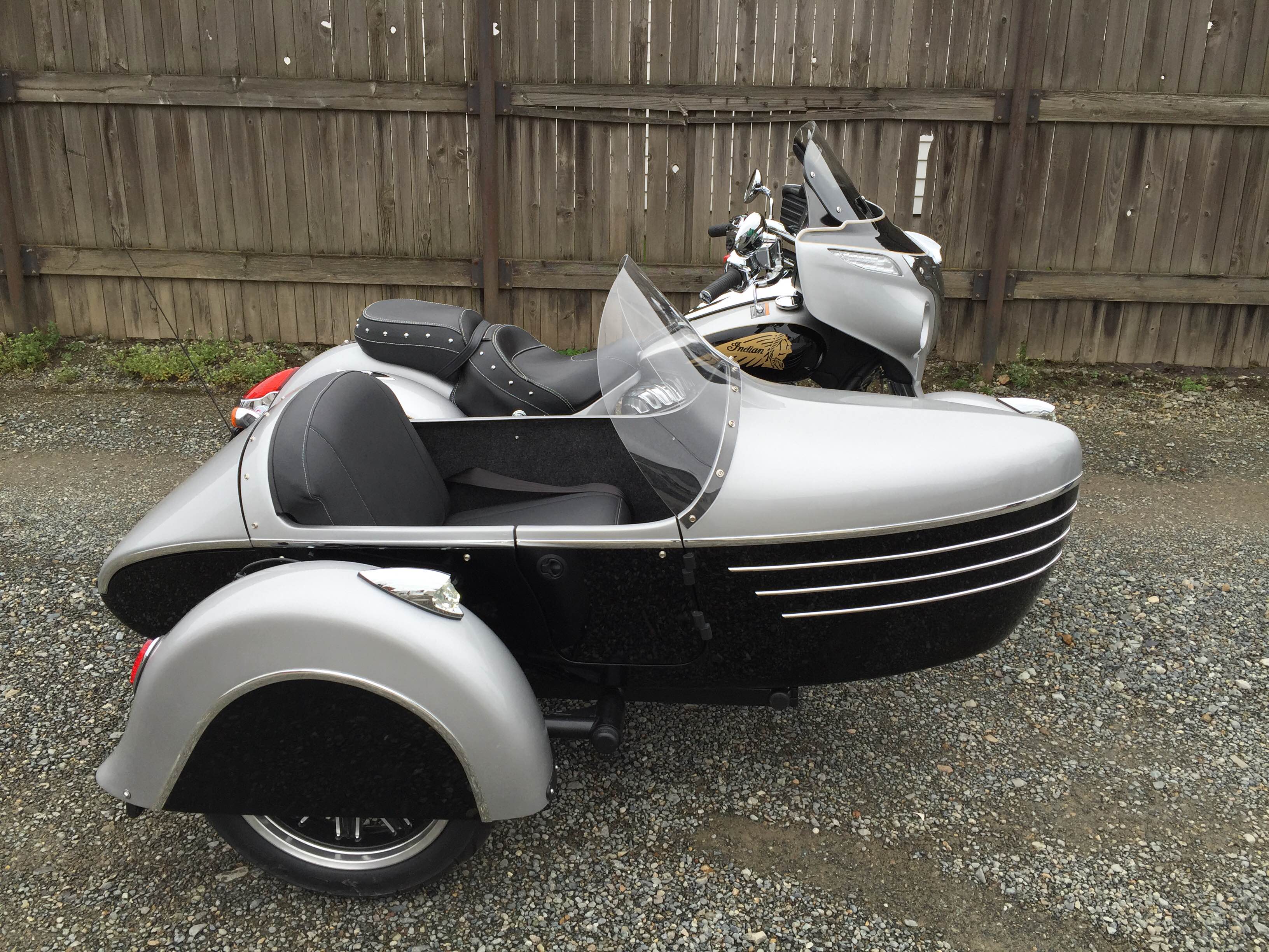

If you go to a custom shop like Freedom sidecars you can go with almost any bike you want however if you want to be able to do this your self or have done closer to home you should chose a bike that mounting hardware is made for as well as steering modifications. What ever company you chose to work with check on lead times. No idea where Freedom is, There are posts on this site from customers of anther company that are closing in on waiting two years for their sidecars. We have what you would need for the Triumph. As you already have a Victory but very little is made for the Victory you might consider the Indian's. We have sidecars, mounts and steering modifications for all of the Indian's including the Scout. What ever company you chose to go with insist on paying with a charge card. It gives you protections (see the post on safer whole sale) If the company will not take a charge card, do not deal with them.
Another thing to think about is how easy is the sidecar to get in and out of should you have a passenger. Some sidecars are not easy at all to get in and out of while others are quite easy. We offer both. I would be glad to help you in any way we can. I have posted a photo of an Indian with one of our Tomahawk SE sidecars.
