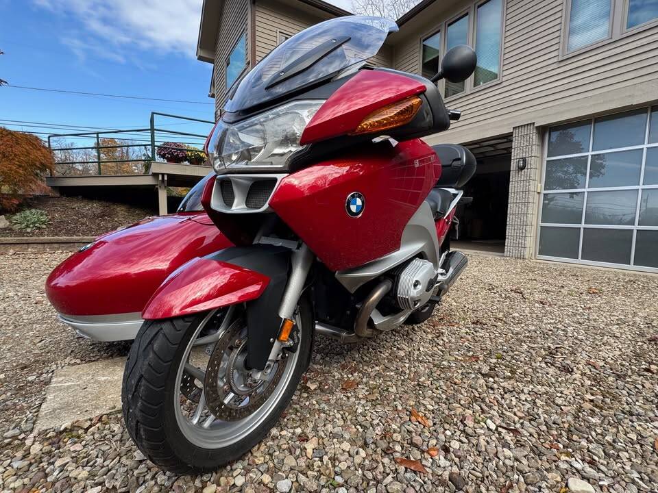

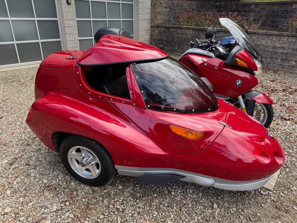

(@tomjgerken)
Posts: 55
@thane-lewis
578024781 9888679661257124 5054696954634593502 n
577713769 1577780766967728 6356992525308008329 n
Posted : April 18, 2026 2:54 pm

Posts: 1293
Posted by: @tomjgerken
@thane-lewis
-- attachment is not available -- -- attachment is not available -- -- attachment is not available -- -- attachment is not available --
Wowzer!  😍  <Insert Wolf Whistle here>
B-E-A-Utiful rig!   Like how the two tone on the sidecar matches with the bike.  Very classy without being over done.  😎
For all those who mount long wearing front tires, don't you miss all the finger bruising, and cursing that goes along with mounting a new front tire? 😉
Posted : April 19, 2026 8:48 am
