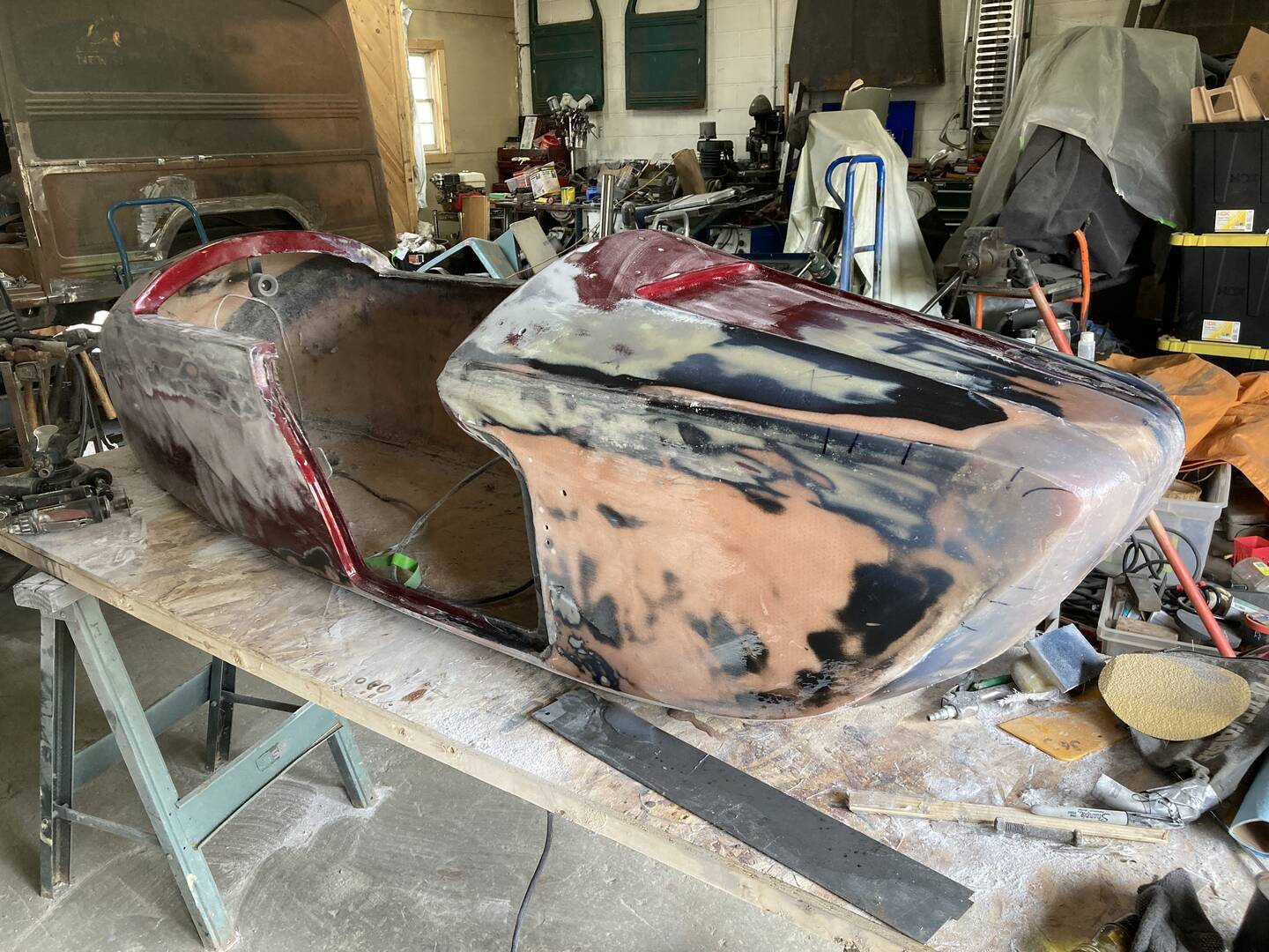

On Friday were coated the repaired areas with the fiberglass body putty and allowed the tub to sit for two full days.  At noon today the surface was rock hard and appeared to need minimal sanding.  As the sanding began the paper clogged quickly and the rock hard clear surface turned brown and gummy.  After four hours and several dozen sanding discs were back to where we were Friday morning.
We mixed the catalyst into the material per the instructions on the can and were initially impressed with how the product spread.  Still not sure what happened.  Plenty of catalyst was used, it was thoroughly mixed and we allowed two days to fully cure.
I don’t want to repeat the frustration we faced today and haven’t heard back from Amazon or the seller.  Going to look online for data sheet or other related materials.
Any thoughts or theories on why this happened and/or what I need to do to prevent a reoccurrence would be greatly appreciated?

(@chloespop)
Posts: 104
The temperature was on the cool side and it was damp!  We did recoat the areas yesterday and hope the warmer, less damp conditions, are the answer
thank you for your input
Posted : March 26, 2025 5:53 am

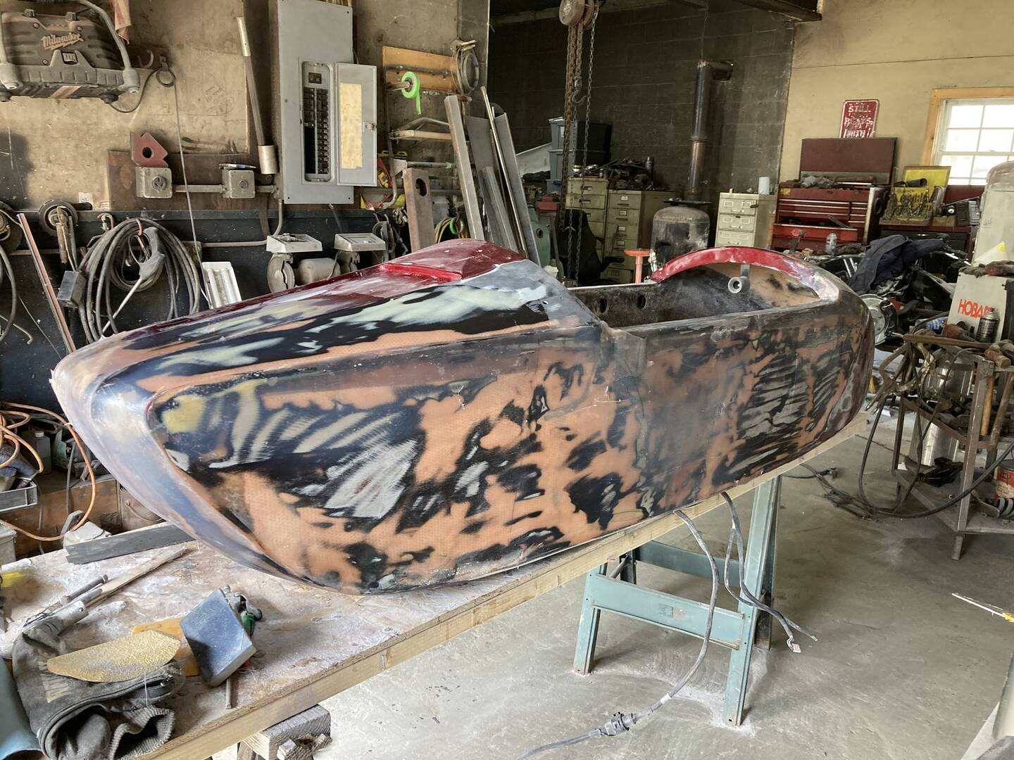

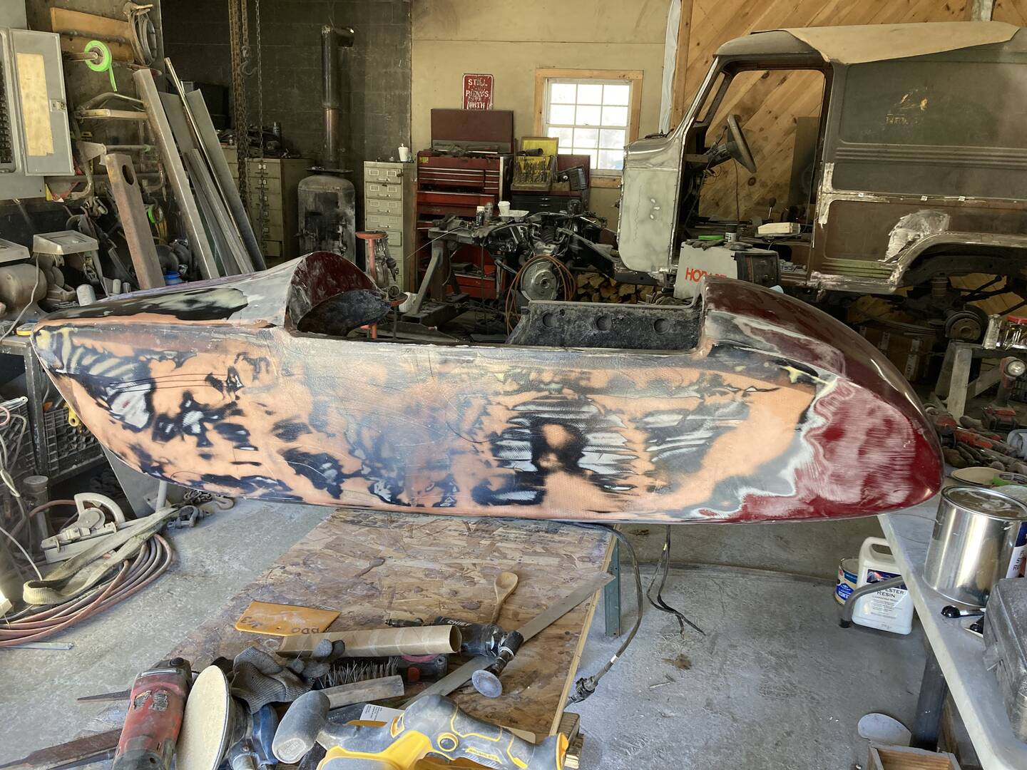

(@chloespop)
Posts: 104
That application dried properly and sanded well.
warmer, less damp and more catalyst was the formula that worked for us.
Spent most of yesterday fine tuning lines and symmetry of the tub.  More sanding and touching up today.  Will have the tub in primer next week.
After that I’ll be working on the bike.
changing exhaust
installing bike side mounts
wiring bike.
im planning on getting everything reinstalled and joined, fully functional with the tub and fender in primer.   Once that is done I’ll remove the tub and fender in order to paint them.
Full credit to my friend Phil for all his work, expertise and advice on the body work portion of the project.

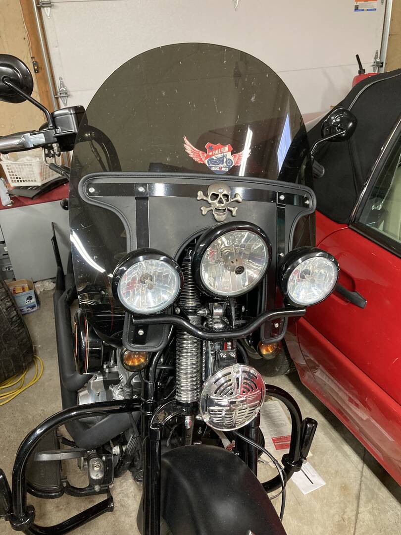

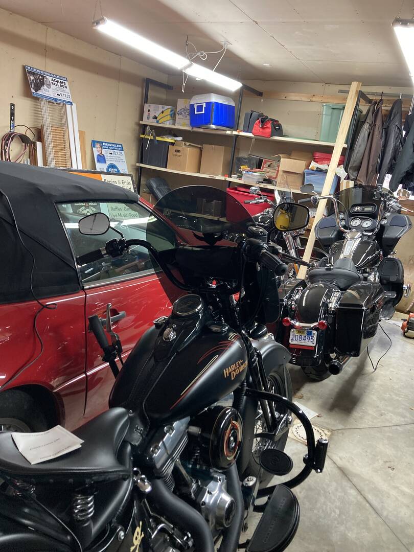

(@chloespop)
Posts: 104
Thanks Sheath, feels like it will never end(body work) but getting closer to primer every day.
I spoke with Gustafsson Plastics in Florida today.  Sending them my windshield for measurements.  They are going to make a  windshield for the sidecar to match what is currently on the bike.
Seat is going to upholstery shop out side of Keene NH next week.

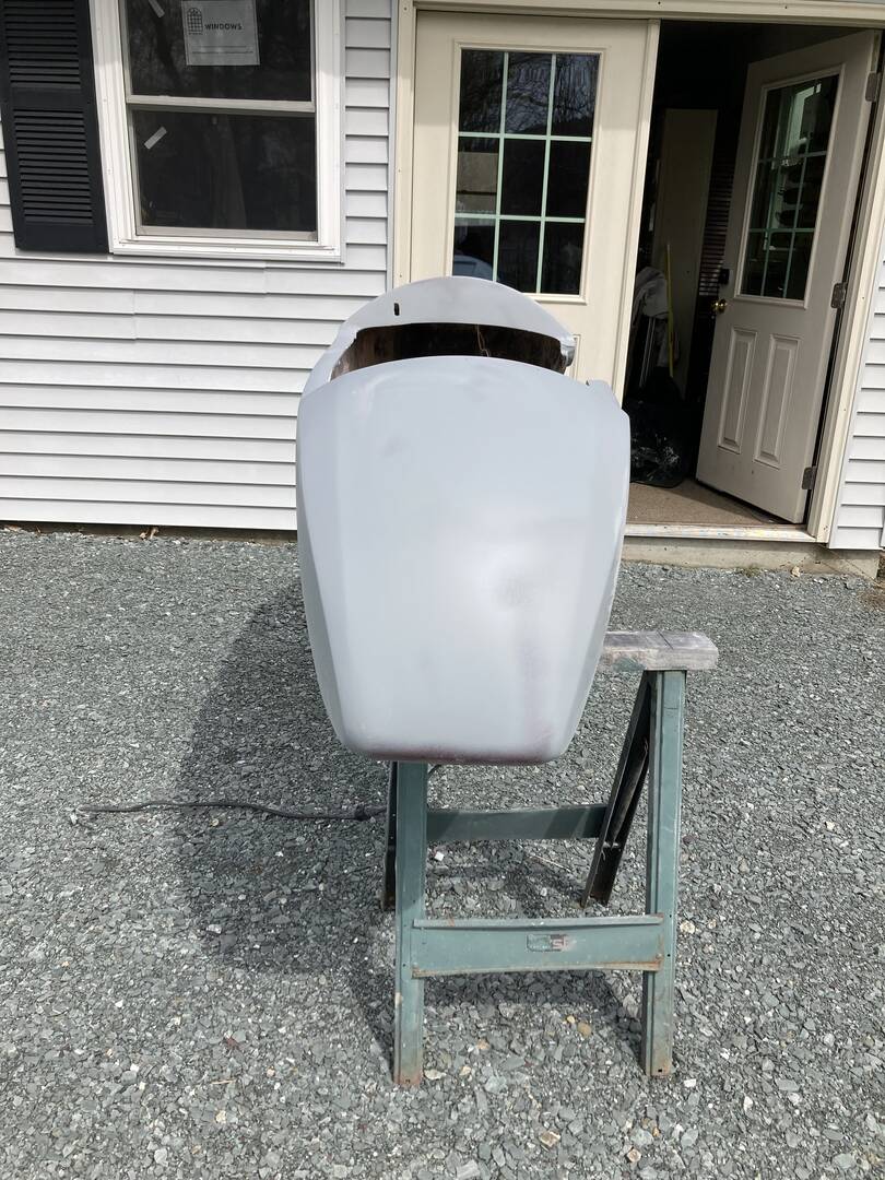

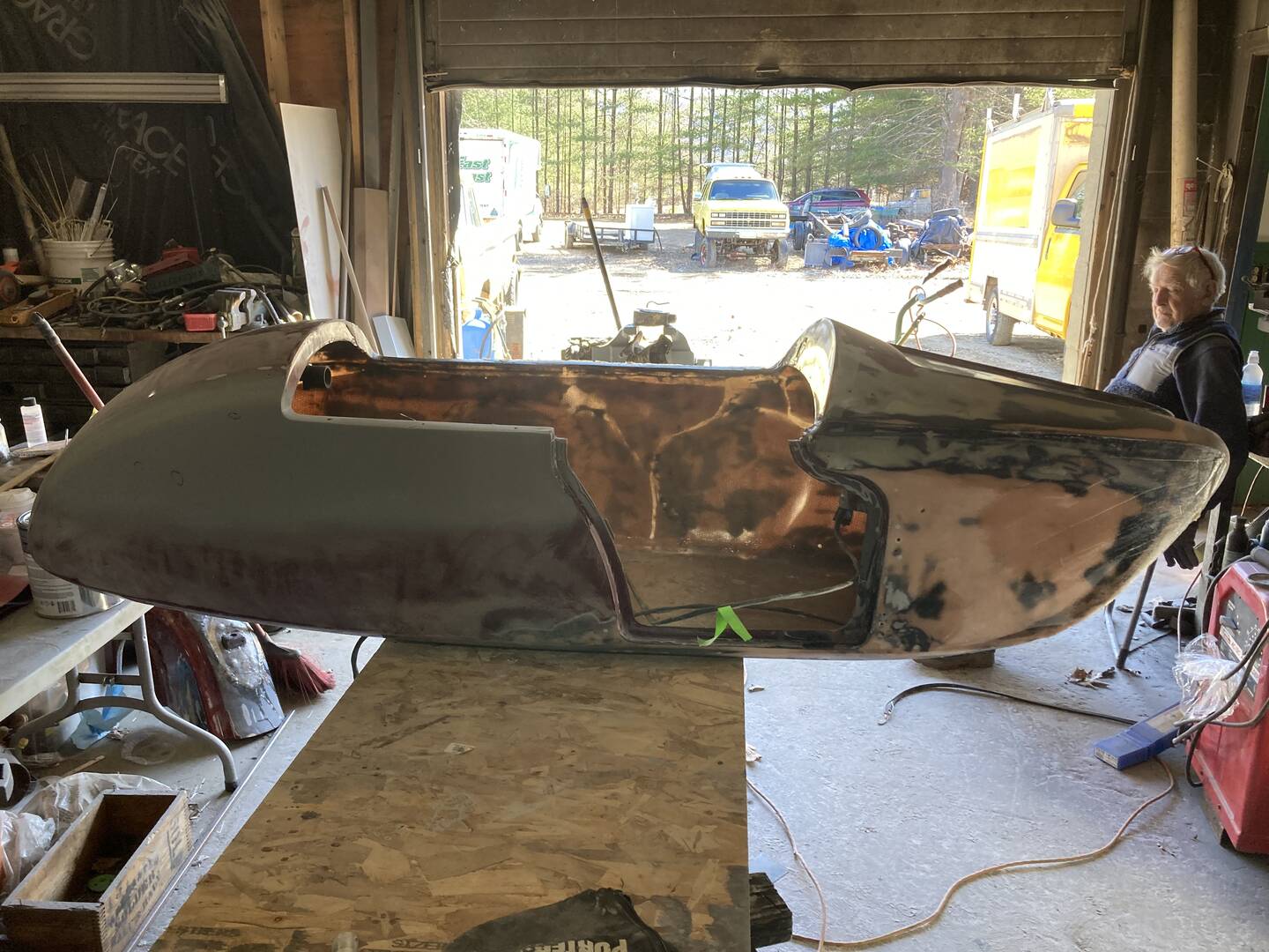

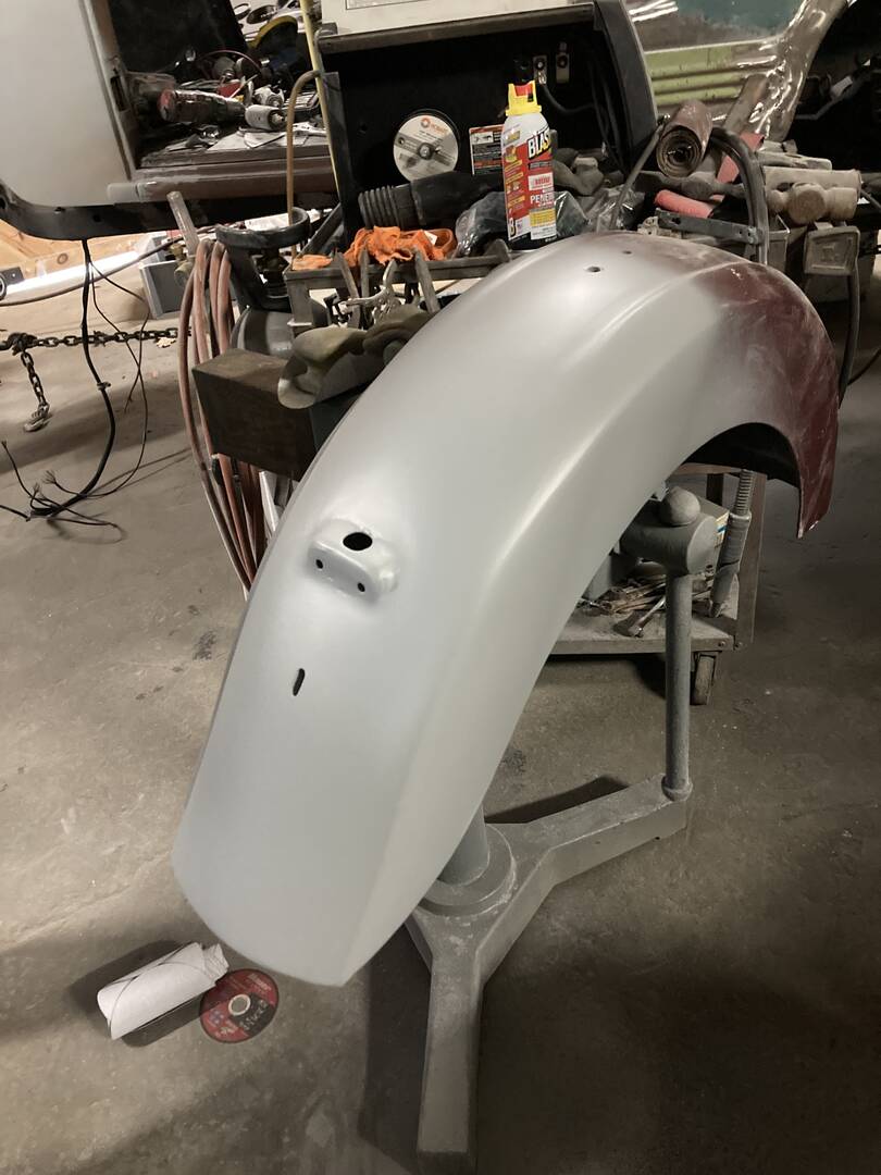

(@chloespop)
Posts: 104

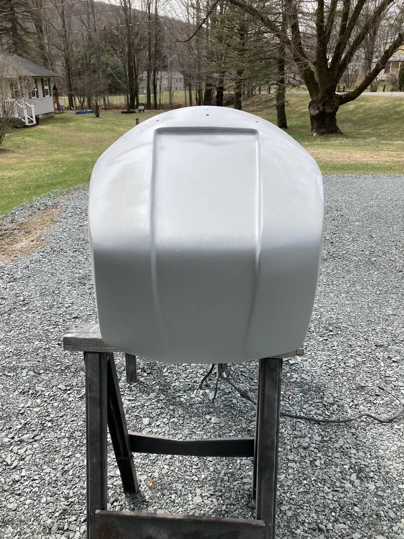

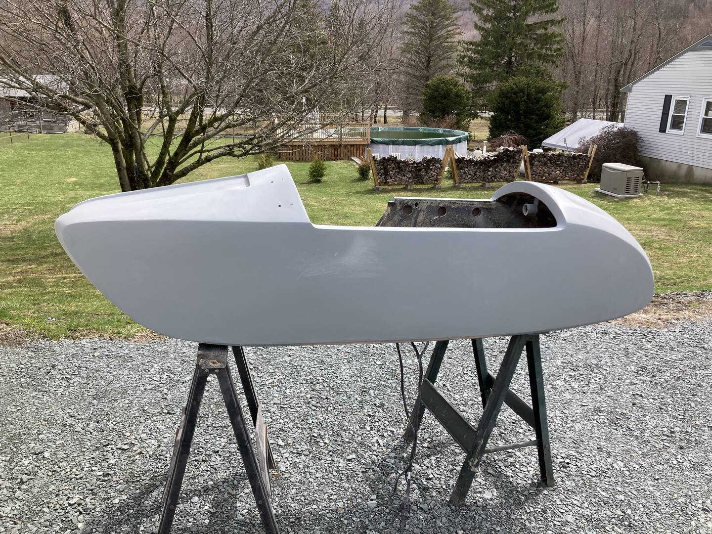

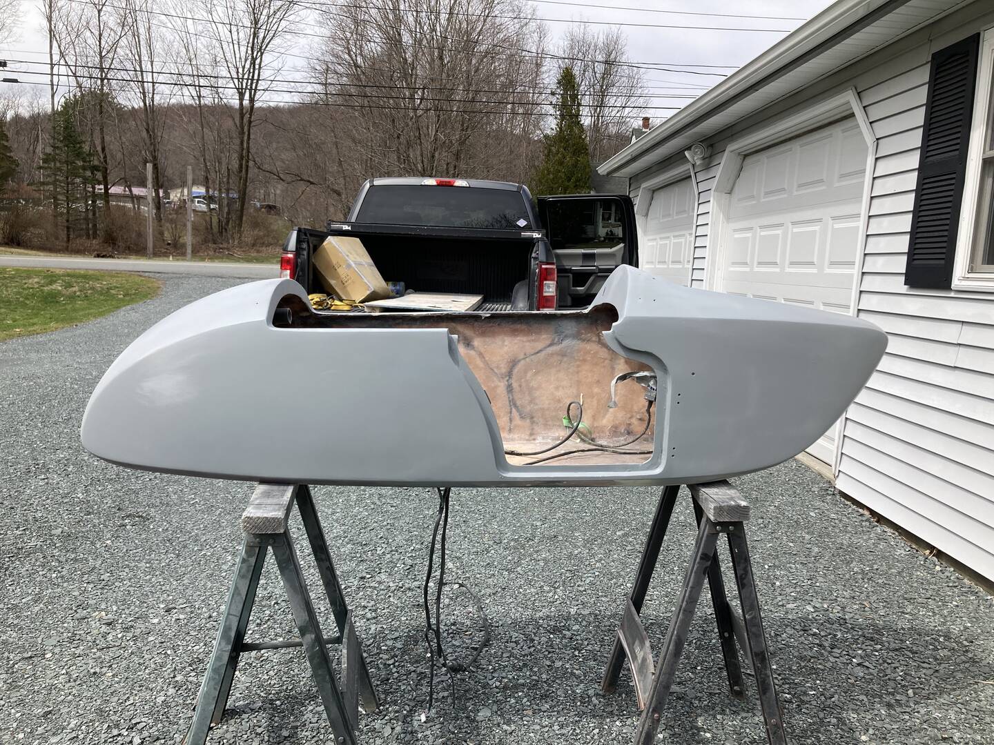

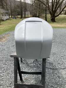

IMG 9114
IMG 9117
IMG 9110
IMG 9118
IMG 9116
IMG 9119
GRAVEYARD (side) CARS
PRIMER is now my favorite word in the English language!
Some of the primer was actually shot on April 1 which is kind of fitting.

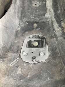

Fender  now accepts tombstone taillight.  The tombstone mount was cut out of a crashed softail deluxe, fender and glassed into the sidecar fender still have to seal the inside of it.
Still a lot to but nice to have brought the frame and tub back from the dead
Posted : April 3, 2025 12:44 pm
