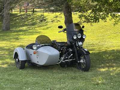

-Taking the pattern and marine vinyl to be sewn today for new tonneau
-Windshields added recently
-Fabricating mount for rear view mirror this week
In another week I’ll be out of planned work and have to decide when to stop riding and
IMG 0570
start final body work and paint.

Dave, it's looking really good !
Is it really necessary to have the rear view mirror mounted onto the sidecar body ?
In a poll taken recently, only 3.14159% of all sidecar Monkeys said they had a need or want for a rear view mirror on the sidecar.
And, most tonneau cover makers really like to have the vehicle present, in their shop, so they can make the new tonneau cover to precisely fit the vehicle, in this case the sidecar, rather than just go off a pattern.
Painting...color ???? Are you going to repaint the bike, so that it matches the sidecar ? Wink
Posted : July 8, 2025 8:02 am
Posts: 1285
Definitely looking great!
A stand out feature that caught my eye is how the sidecar windshield matches the bike's windshield.  Trim layout, size and curvature.  Really dig details like this.

I am enjoying the rig so much that it’s hard to think about shutting it down for paint especially given the late start for my riding season.  Thanks for your feedback and comments!

Im trying the tonneau on my own with only the sewing being subbed out.  The turnbuckle style connectors are not on the tub and will be added to the tub and cover one at a time to make sure the placement is exact.
Plan B is to take it to somebody who knows what they’re doing, but only if plan A does not work out.
My plan A and B method of the build has worked so far and with everyone’s help the Plan A has prevailed.
im using marine grade canvas for the tonneau and there is no stretch to it.  Wondering if that will require a plan B, I’ll keep you posted.

Forgot…….. the tub is currently in grey primmer and will be painted to match the bike.  It will be satin black with some old school pinstriping.
i have to change the finish on a few items so everything matches.  Those details and maybe even the paint may be a winter project.
According to my monkey, my next project is to get the barns stained.
Posted : July 9, 2025 6:59 am

Glad to read you are having a lot of fun with it.  Has been a lot of fun to follow along on the project.  Sure is turning out great! 👍
