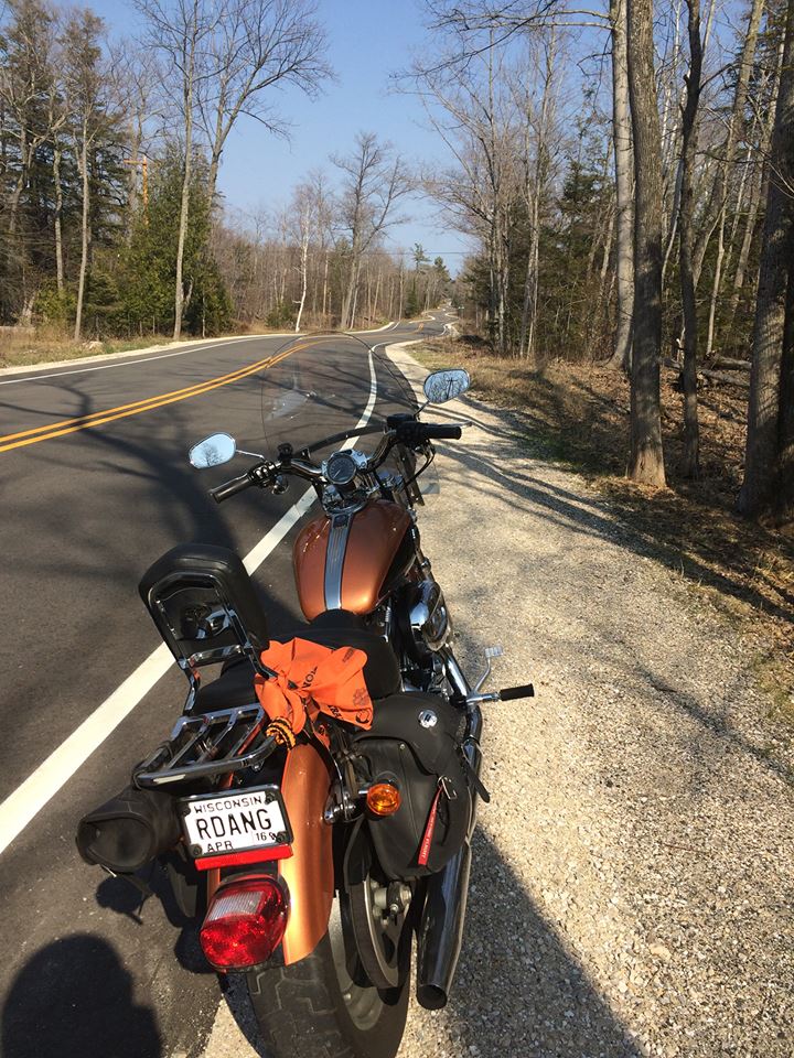

Looks like DMC M72cx will be the ticket, and Scrambler cycle here in Wi has a great rep so they will be entrusted with my Sporty come spring. Photos to show about April!

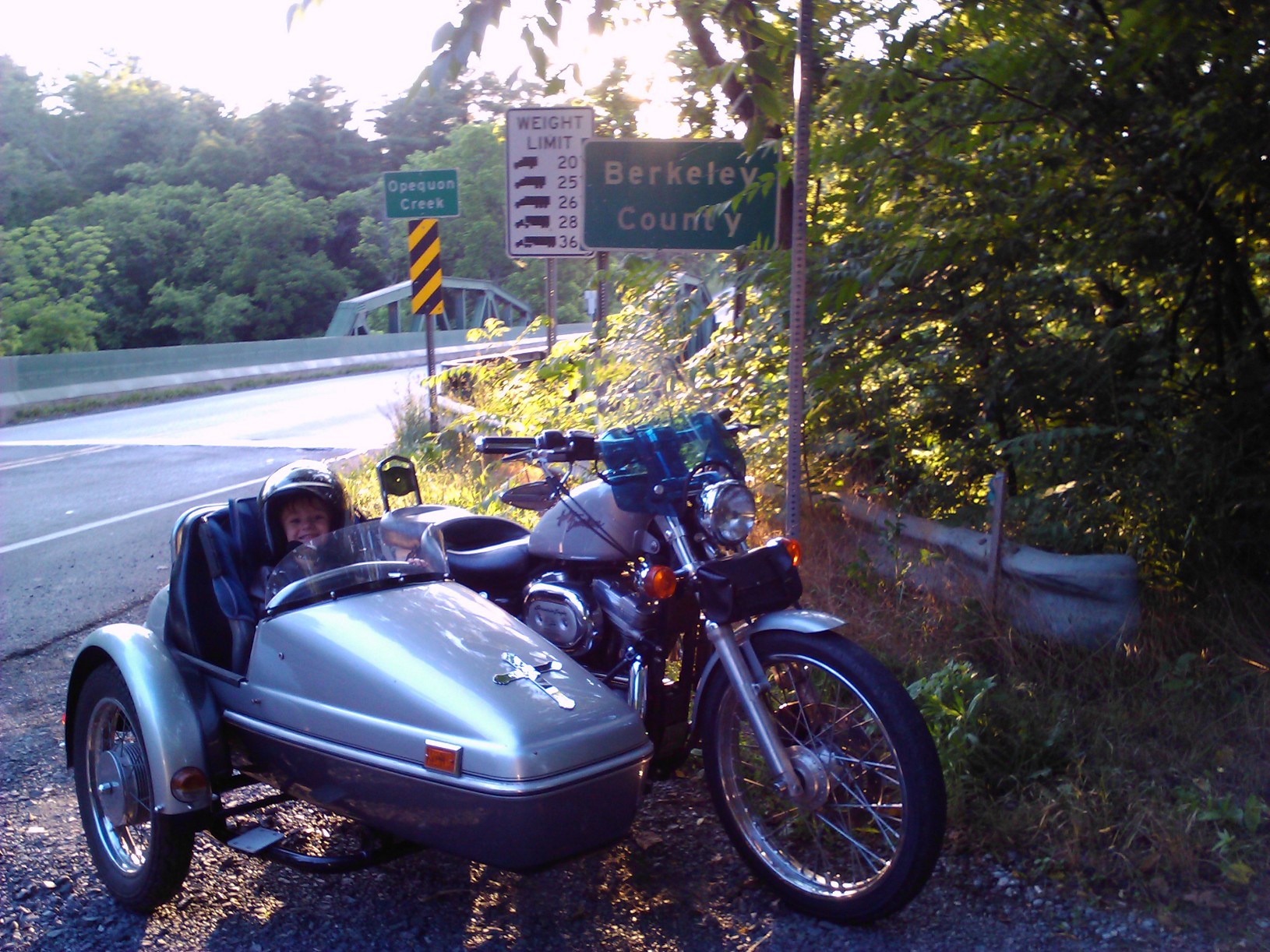

I'm not much help now , but I have a Velorex on my 01 883C and with a little tuning I can manage 90 MPH sustained speed on the Interstates and my grandson has been in there since he was 2. I have not done the rake trees on my bike but I would advise that you have it done. My wife tried driving my rig( she rides a 95 Ultra Classic) and she said it drove like a tank trying to make turns.
