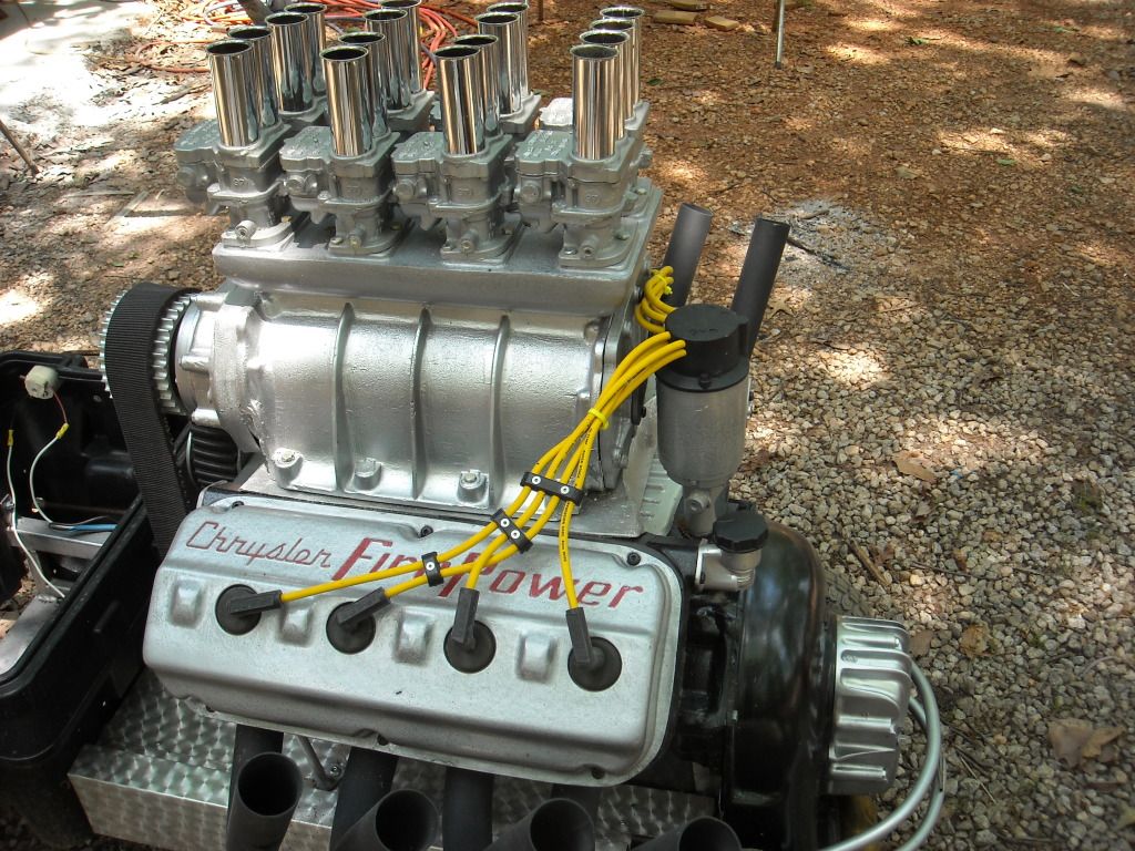

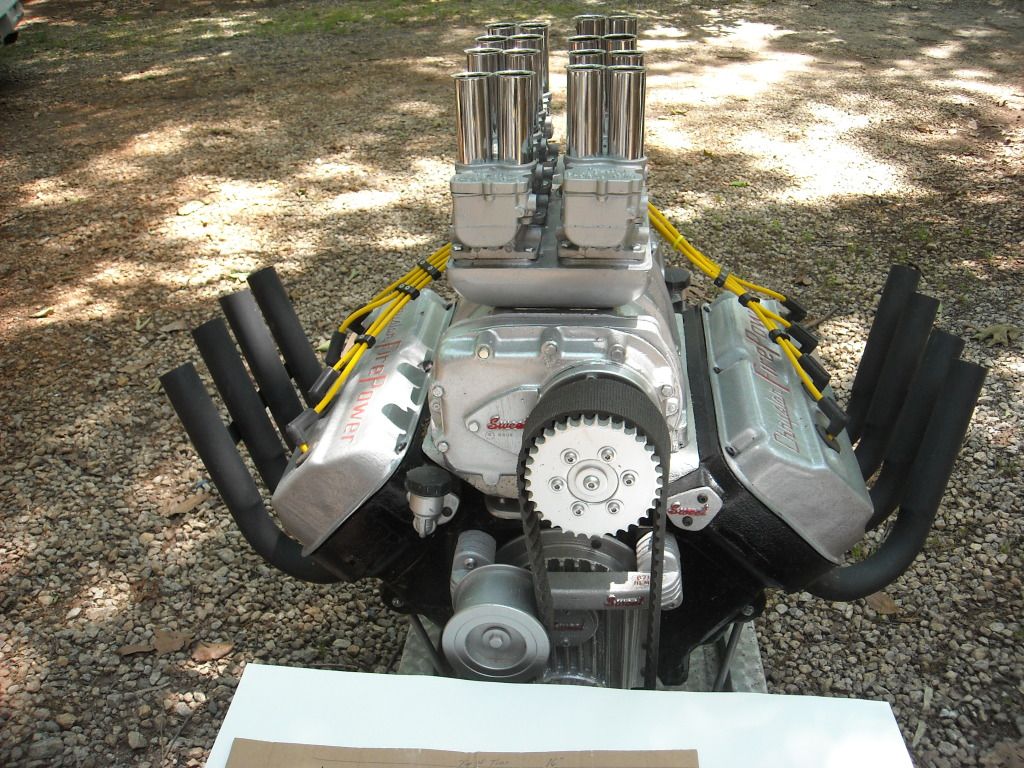

Great idea Jim! It couldn't be any simpler plus the engineering behind the design is well thought out. Your entire concept is interesting to say the least. I like it! You would fit right in with our group that attend some of the different car shows in the South East. At a three day show a guy can walk up to ten miles so we came up with something a little different. Modified scooters! We took a scooter like yours and made a few modifications to it. The 392 Hemi is made out of fiberglass and plastic weighing around twenty pounds. It's always an attention getter at any of the shows. Like anything in life we were having to much fun and the powers that be decided that we needed an official state handicapped sticker on the scooter or we couldn't drive them around the show grounds. It was funny to see a group of old retired Vets offering to hand a young thirty something his head on a platter if we couldn't run our scooters around the show grounds. The little punk turned the cops on us and we were told if we drove the scooters they would escort us off the grounds; go figure. Needless to say I stopped going to the shows and moved on. But back to your design. I like it! Thanks for posting it.
