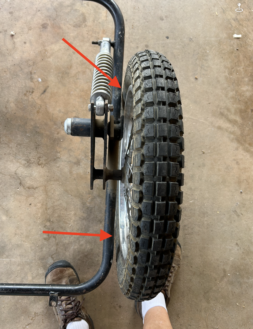

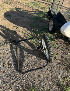

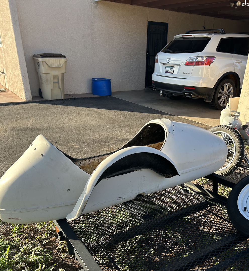

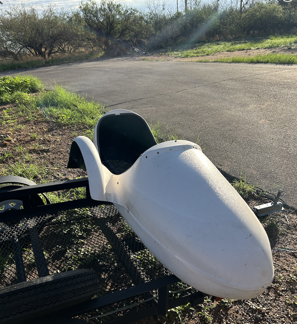

I picked up the sidecar this weekend and now I have a project in front of me. Overall I am okay with the purchase. There are a couple of things that didn't thrill me but they are correctible. There has been some minor welding of mounts on the frame nothing a grinder won't fix. And the wheel is questionable if I will keep. I have an extra set of wheels for my V85TT and would like to use one of them, but mods will need to be made, specifically a new axel. But putting on either of those wheels the fender on the tub may need to be modified, widened to accommodate the larger wheel. Oh well I will see how things fit first.
I noticed an interesting thing with how the suspension and existing wheel are mounted. There is a builtin wheel toe in, not sure how much as I have not measures and calculated the angle, maybe 2 degrees. Nothing is bent it was manufactured this way.

UPDATE: The wheel has a toe in of 2.106 degrees.
Toe in
Tub 2
Tub 1

Toe in should be zero or close to it.

I found toe in was not needed at the upright position of the bike.
Some fine turn possibly.
This is where minimum drag in the form of light weight and skinny wheel played a part.
And also the position of the pivot points .
The front higher than the rear.
Vertical  there's no toe.
Lean towards the chair and it actually toes out a little and aids the turn.
Lean away from the chair and it toes in helping the turn towards the bike.
A normal rig has the bike with a slight lean away from the chair so in affect you will have a little toe in while going straight.
