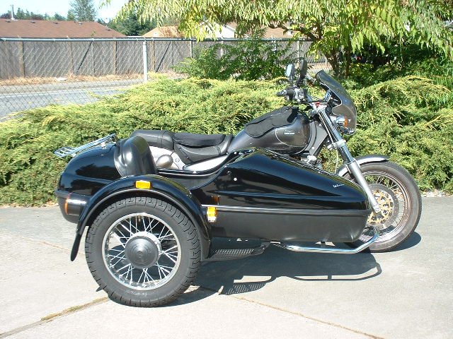

(@big-bike-rick)
Posts: 86
Hi Lonnie, could you please post some pics. of the mounting setup on that Guzzi? I have basically the same bike, and am interested in how the mounts are set up. thanks alot, Rick
Posted : February 9, 2011 8:06 am
Rick,
Mount pix are in my album Hack'ns / Hacks #14.
Posted : February 9, 2011 9:12 am
(@big-bike-rick)
Posts: 86
thanks Lonnie, nice setup! Rick.
Posted : February 9, 2011 9:38 am
