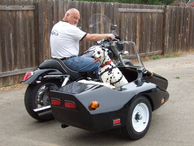

Here's a pic of a Kenna Double mounted to a VTX1800 -- seems a pretty good match.

All Velorex sidecars are way to light duty for a 1800cc bike. Our least expensive sidecar that we make that is strong enough for the VTX is our Kenna single at $3695 which includes bike specific NOT universal mounts. Our most popular sidecar for your bike is the M72C at $4995. These are both made by us in our shop in the USA rather then over seas like the Velorex. They are both strong enough for the largest bike out there. For your bike we also offer triple tree's to lower the steering effort and you can run an automotive tire on the stock rear wheel.
If you find a used sidecar, feel free to contact us before you buy, some sidecars by the time you make them safe for your bike they are not such a good deal. We also can provide mounts for most sidecars however for "ural" type sidecars (Ural's, CJ, Dnepr's) you must cut off the lower front mount, weld in an adjustable mount, weld a new lower rear mount to the frame and replace all of the lower mounting arms with what we call bosses and clamps.
You might also look into taking a sidecar class www.esc.org and buying the book "Driving a sidecar outfit" which we sell for $34.95 you can also buy it several other places.
