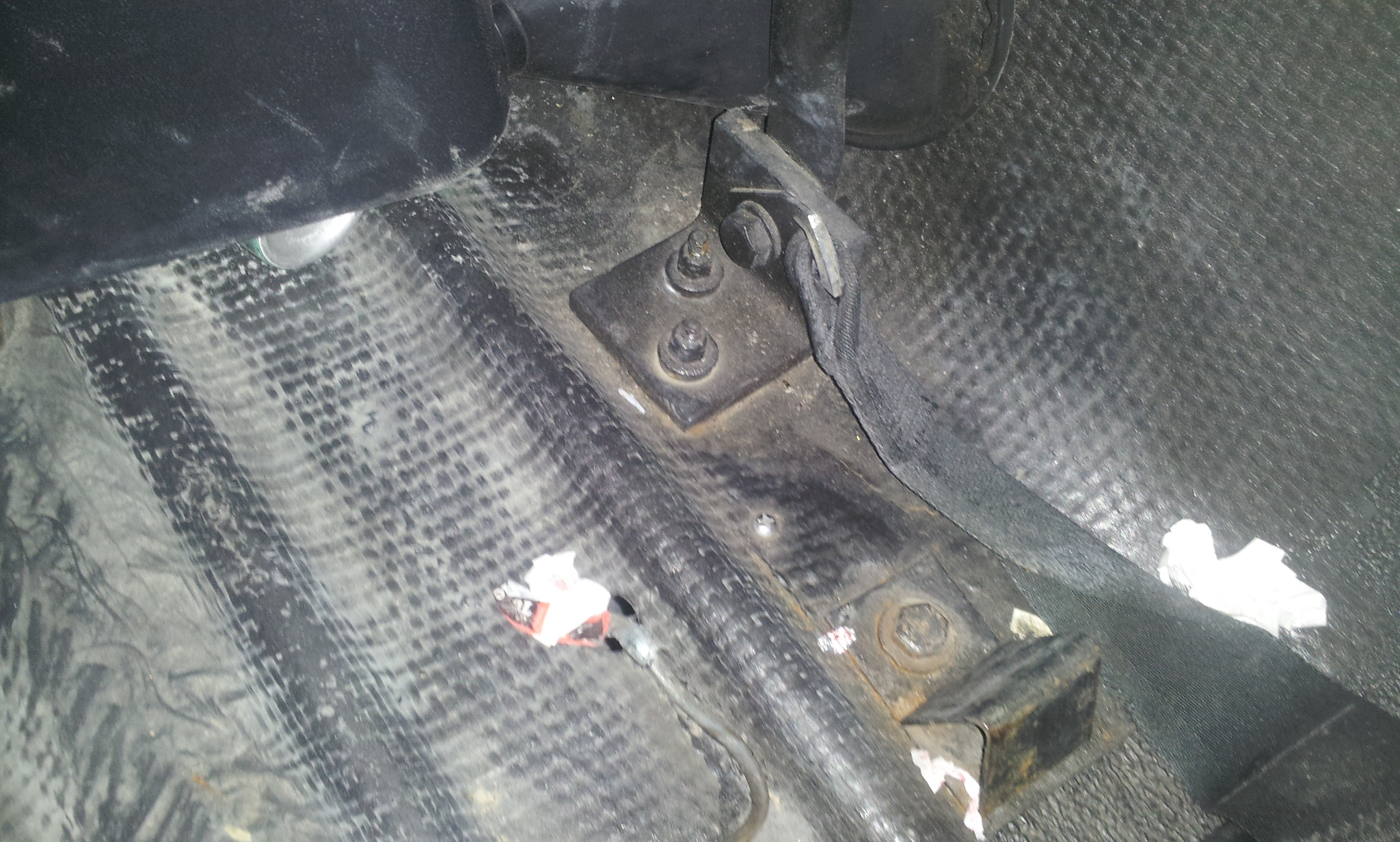

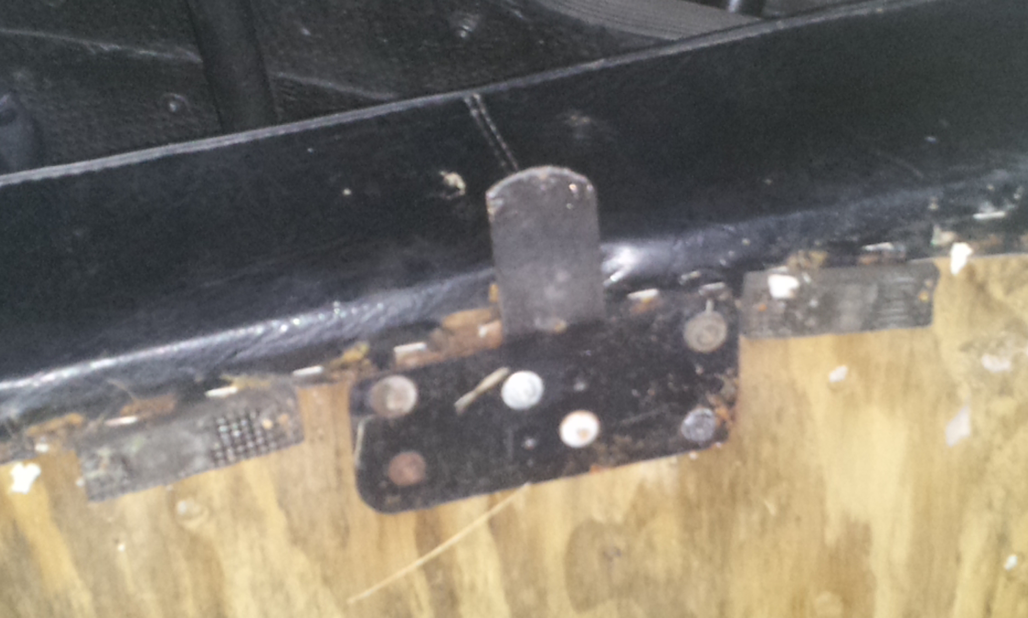

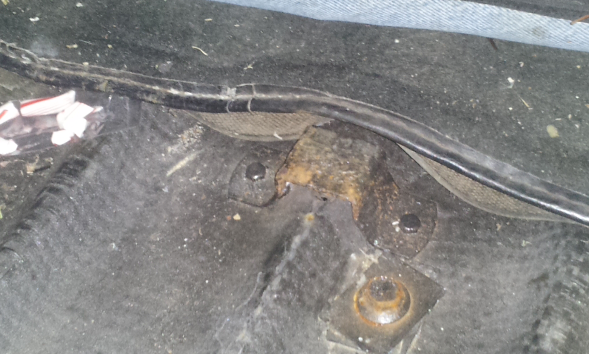

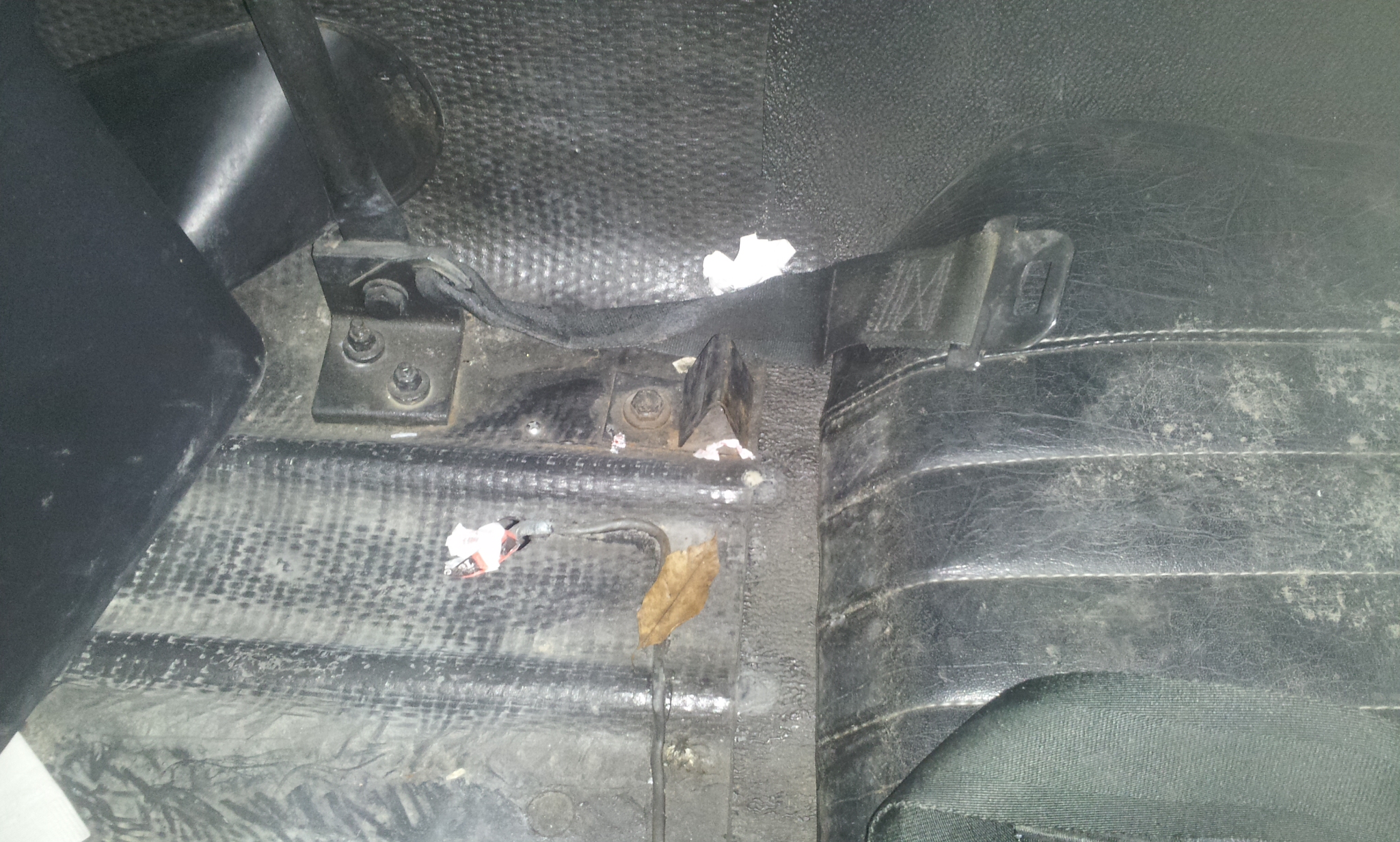

Pics below.
Pic 1 bottom seat front - tab that locks into
Pic 2 bracket on floor
Pic 3 and 4 different views of A brackets behind seat back

Thanks wvsporty pic #3 Was the what I was looking for. When I get to this part I will pic & post here.
