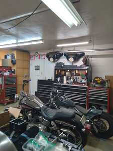

You know it. Spent the day getting the band back together, I've never been sentimental about my wheeled vehicles coming or going, but all these tool boxes spent a good part of their time putting food on the table for a couple Wives, four Sons, and myself. So, they deserve their space. They have it now!

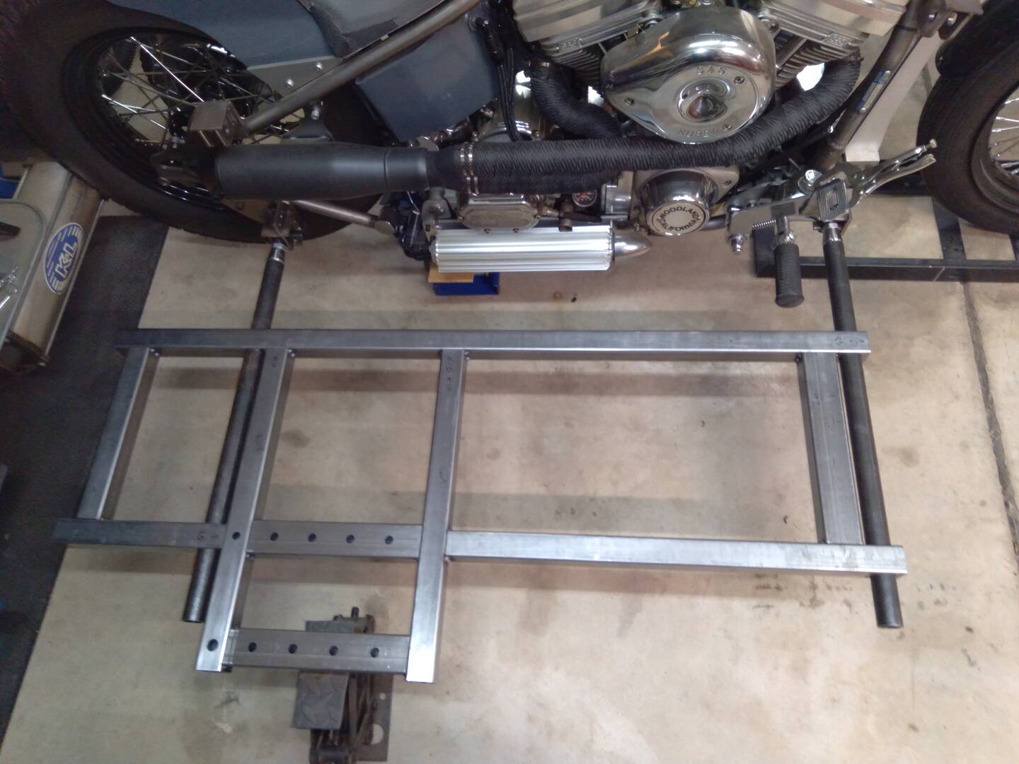

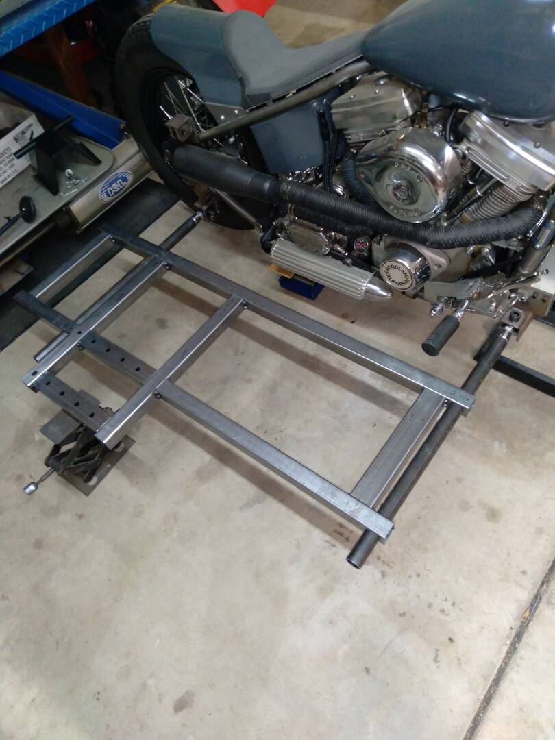

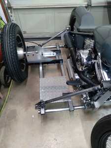

Back at it. We had our first fake spring today, heavy fog in the morning, 67 and sunny in the afternoon. First real mock up, since there are no slip joints, clamps, or u-bolts in this design, I don't leave myself much room to screw up. Everything bolted right up to the frame mounts easily, so moving forward.

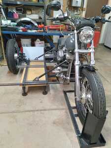

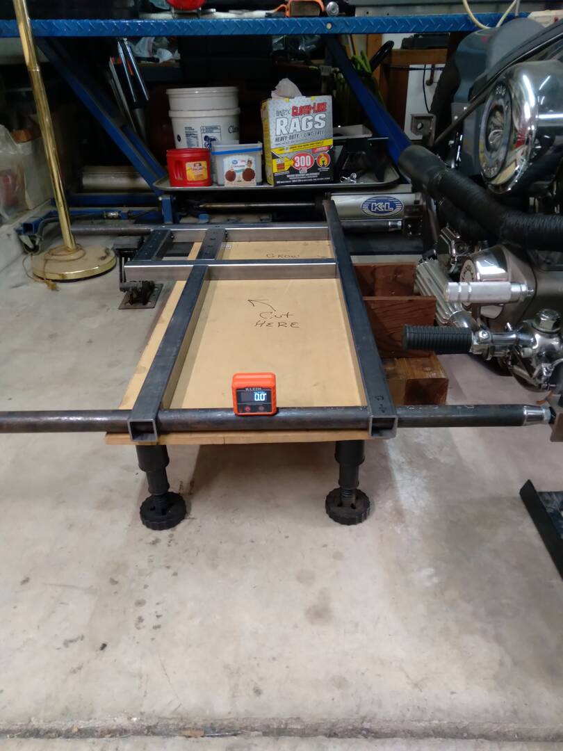

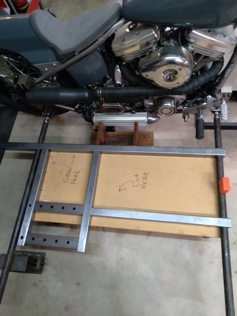

This is the time when I throw what I have together, and stare at it for a while.

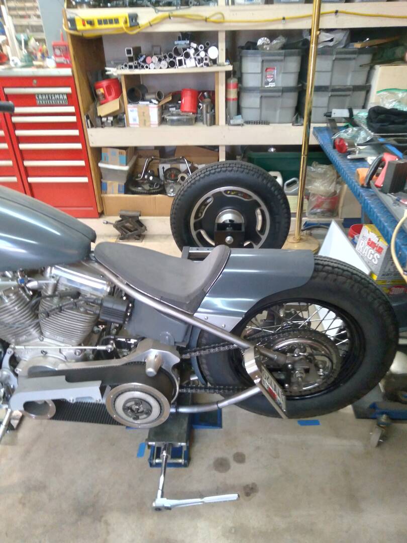

A comparison of the two chassis. The first was built 2 inches from the oil cooler, it is 32 inches center to center of the tires, and the lead is 14 some inches.
The new one is built 6 inches from the cooler, is 40 inches center to center of the tires, has three different lead positions, set at 8.5 inches here.

Chris,  I believe that you might find it better to have the sidecar wheel closer to 12" lead, rather than the 8.5" it's set at now.
The 6" off from the oil cooler is great, and the 40" center to center of the wheels is good.
You do it your way,  as it appears that you certainly know what you are doing.

Thank you Miles, appreciate the input. The 8.5 is the default number, (a Harley number, but this ain't no Harley) all those extra holes are so I can also go to a 10.75, or 13 inch lead when tuning this, using the same axle block.
I already know, just by gazing at it, that I'm changing the upper struts, I tried it on for size, and my clunky hockey stick right foot, (fused ankle) hits everything. Just bought a tube notcher, so I might get artsy on this thing. My happy place!
Nope, really don't know what I'm doing, just winging it, makes it fun though.

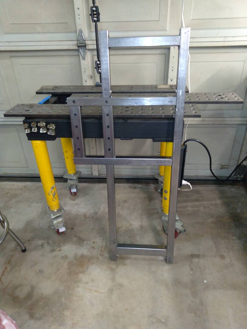

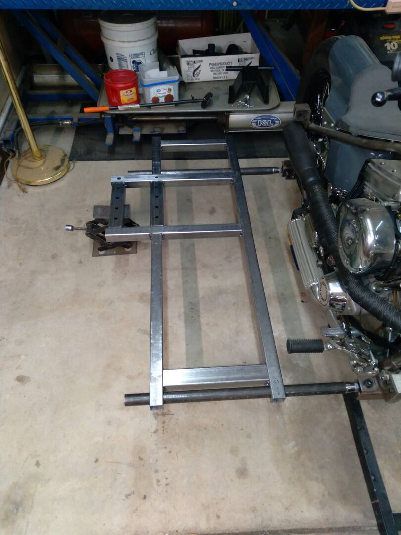

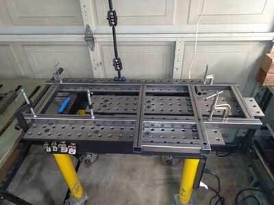

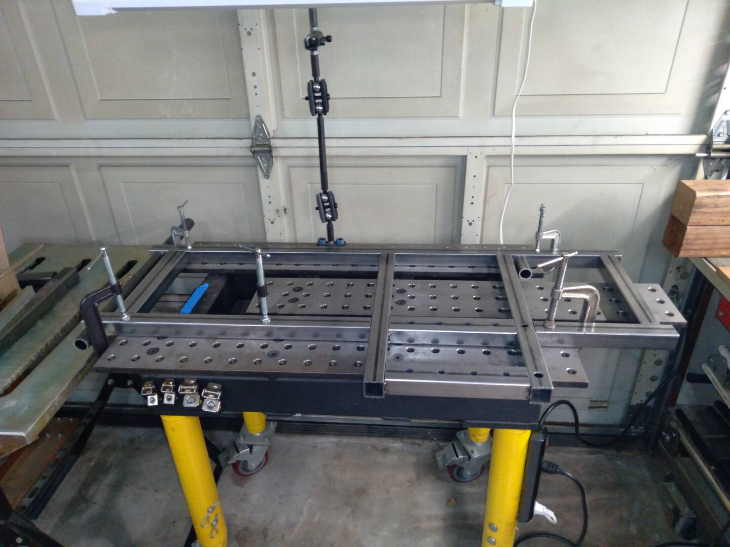

The chassis is back on the table. Finishing up the last pieces for it, and, as always, I made some changes to the design. The front crossmember is now from rectangle stock, the rear is 6.5 inches longer than the original chassis, and a rear crossmember has been added. Due to the increased length, I had to push the "GROW" button on my little table.
20260124 164006 (1)
20260126 064524
20260126 064538
Posted : January 26, 2026 11:39 am

That is a seriously nice welding/fit-up table. 🤩  So nice to work with quality tools.

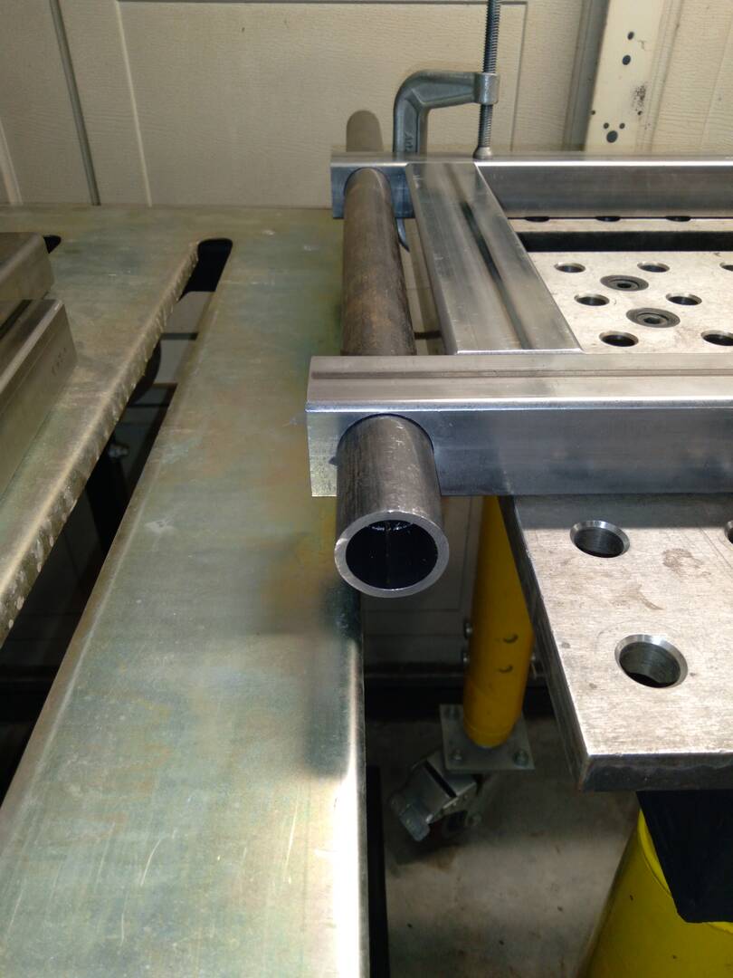

The basic chassis got tacked up today. The piece leaning on the table weighed in at 32 pounds, right on track. However, my weird arms do have a load bearing limit, which brought back a memory.
